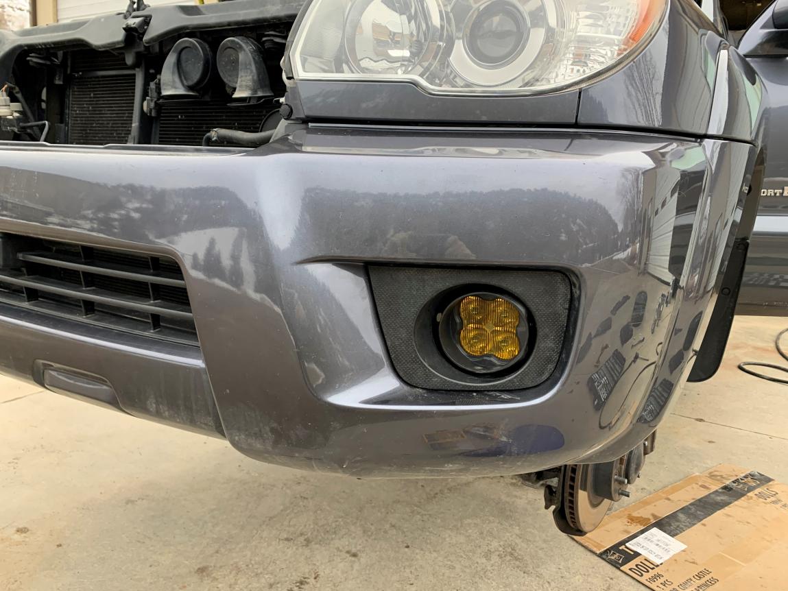

Ordered these on memorial day sale and after waiting 3 weeks it was well worth it. Finished installing these last night, I got the angled version came out pretty well and they are definitly an upgrade than using led in the oem fogs.
Looks really good man! Nice work!

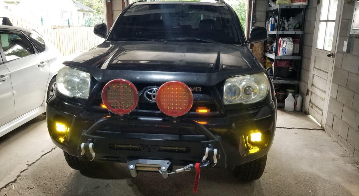

Forgot to update this thread when I switched over to my steel bumper, but I added a second set today so I figured y'all might wanna see.

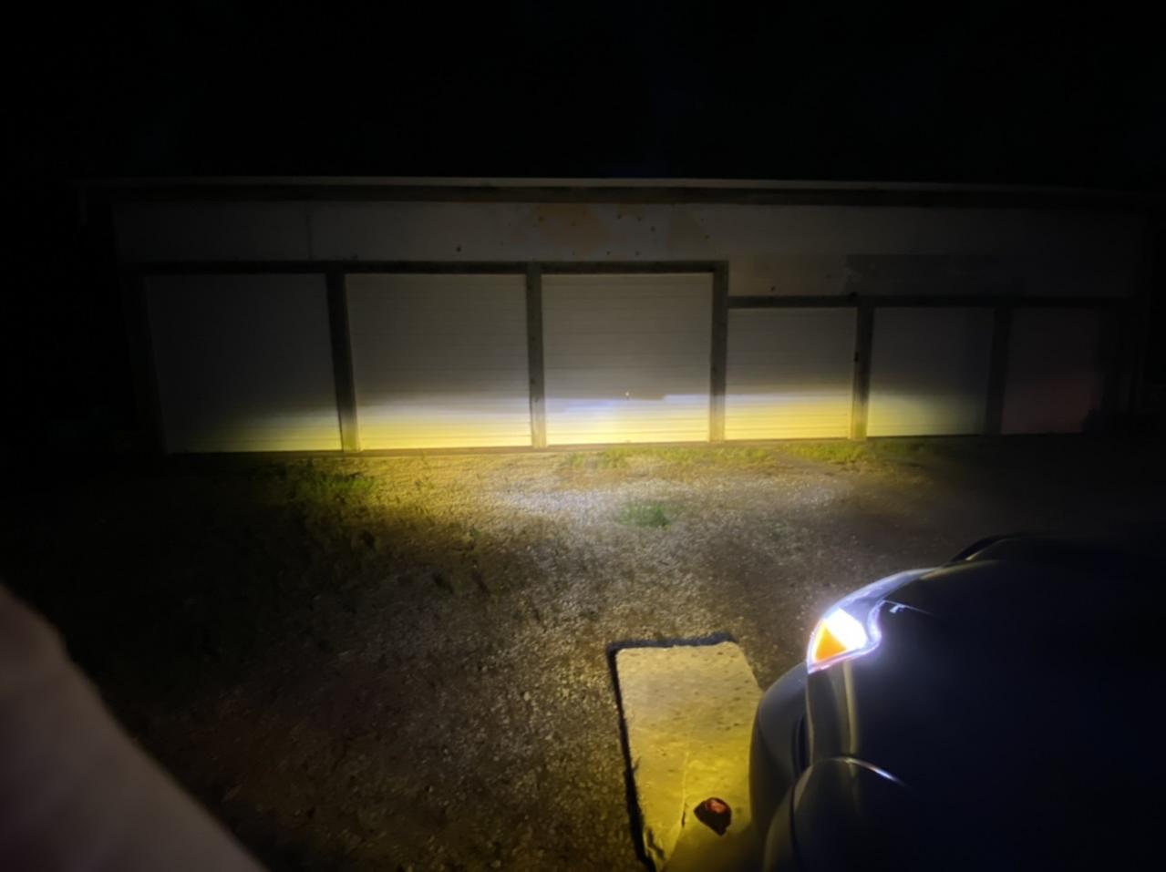

Oh, and output shots!
I had to move 40-50ft away for these to capture the whole beam:
The width went from wide to INSANE - it reaches across 2 lanes the opposite side of the median at the intersection. LOL
Needless to say, I won't be needing ditch lights...
I've found my next mod for my old turd! Great job, and they look excellent with the new bumper!
Also, sorry if you already answered this - but do you have these wired to the factory fog light switch or an aftermarket switch? Is there any issue wiring to the factory fog switch?
Thanks, really happy with the output!
I have all 4 wired to the factory switch using a 2006 to DT adapter and a DT y-splitter. No issues, all 4 combined draw significantly less than the stock fogs.

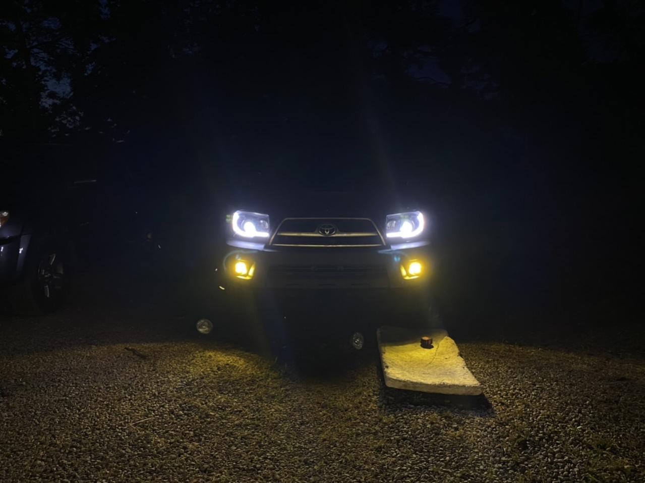

Wonderful, mine were just delivered so I'll be putting them on tonight. Pictures to come :)
In desperate need of a bath, but the lights are in! Love them, thanks again for the writeup!

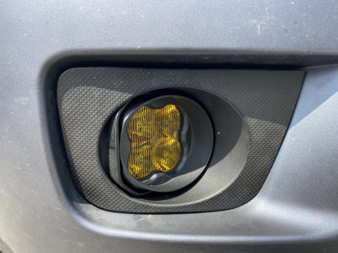

I plan to put in a smaller steel bumper that leaves the portion with the fogs intact, so I went ahead and purchased the angled model. Pics attached here for anyone that is trying to decide between the standard and angled ones.
Thanks [MENTION=117203]Drift Monkey[/MENTION] for the inspiration! Super pleased with the final result.

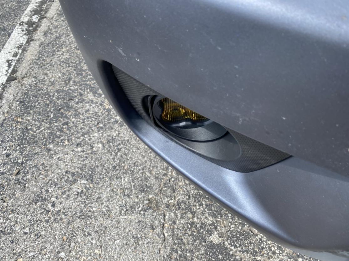

Finally jumped on buying some of these. After seeing the angled front on some of the other installs I was sold. I wasn’t sure how well the single bolt through the bottom would combat any shaking while driving, I wanted something a little more sturdy. So I used the Type F2 mount from DD. I drilled a second hole behind where the original bolt went in. I put a bolt and lock washer in each side. Between the hardware and the front trim piece the lights are not going anywhere. Also with the mount I chose I did not have to paint behind the light.
