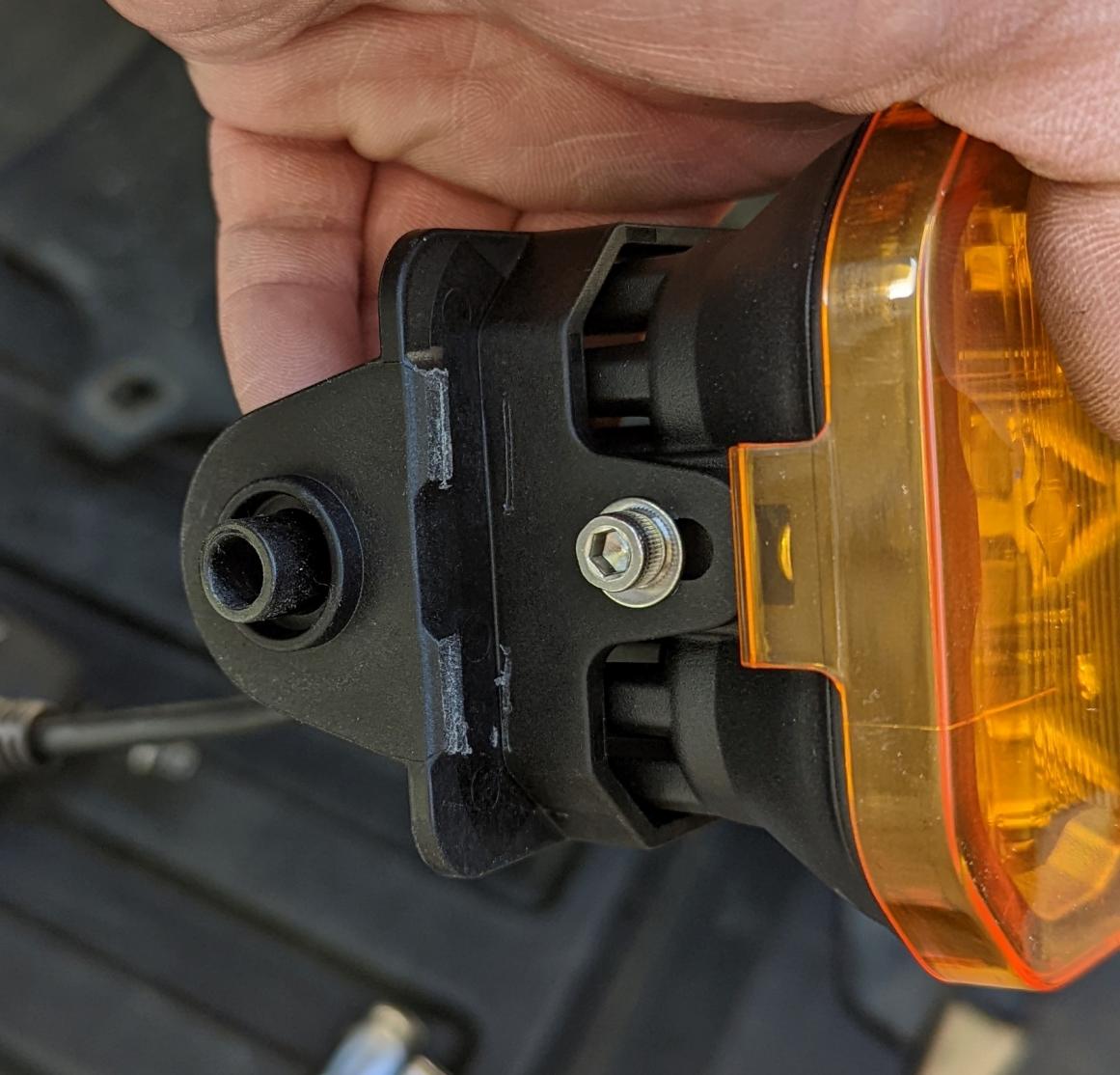

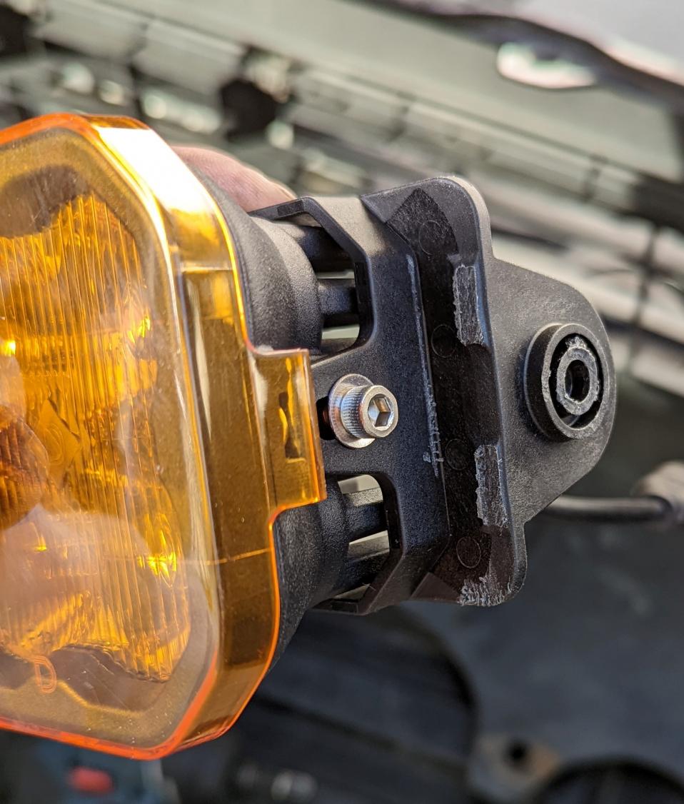

Finally jumped on buying some of these. After seeing the angled front on some of the other installs I was sold. I wasn’t sure how well the single bolt through the bottom would combat any shaking while driving, I wanted something a little more sturdy. So I used the Type F2 mount from DD. I drilled a second hole behind where the original bolt went in. I put a bolt and lock washer in each side. Between the hardware and the front trim piece the lights are not going anywhere. Also with the mount I chose I did not have to paint behind the light.

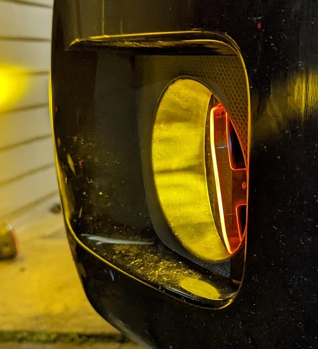

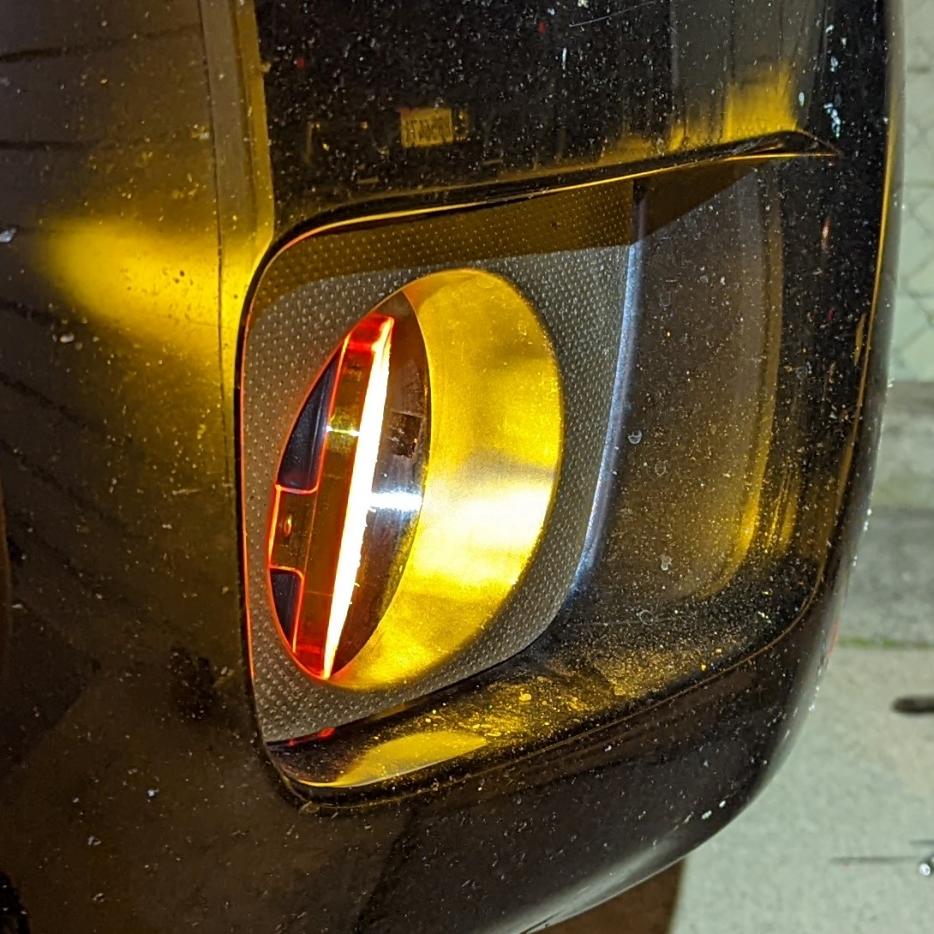

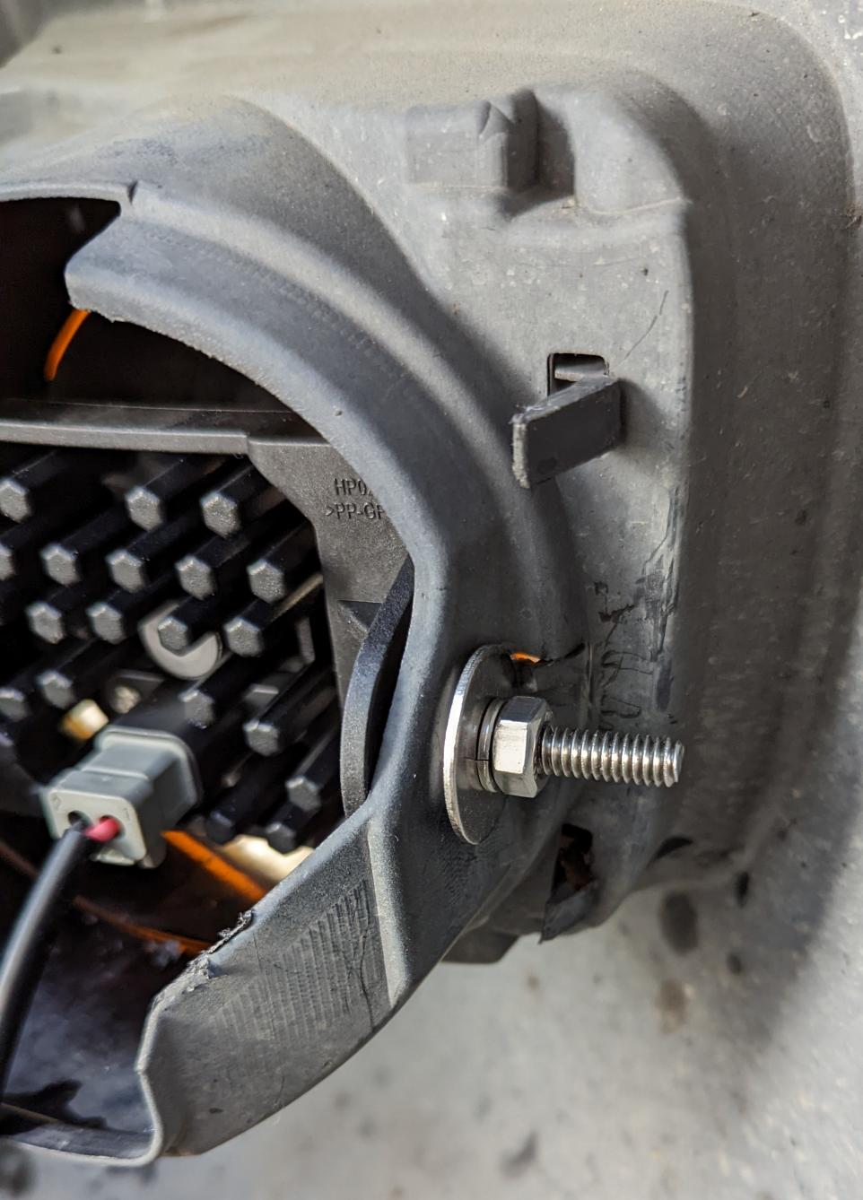

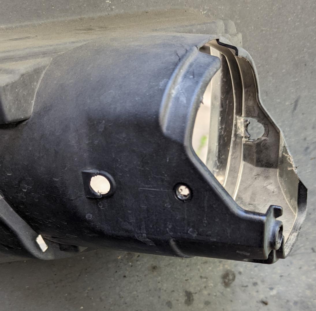

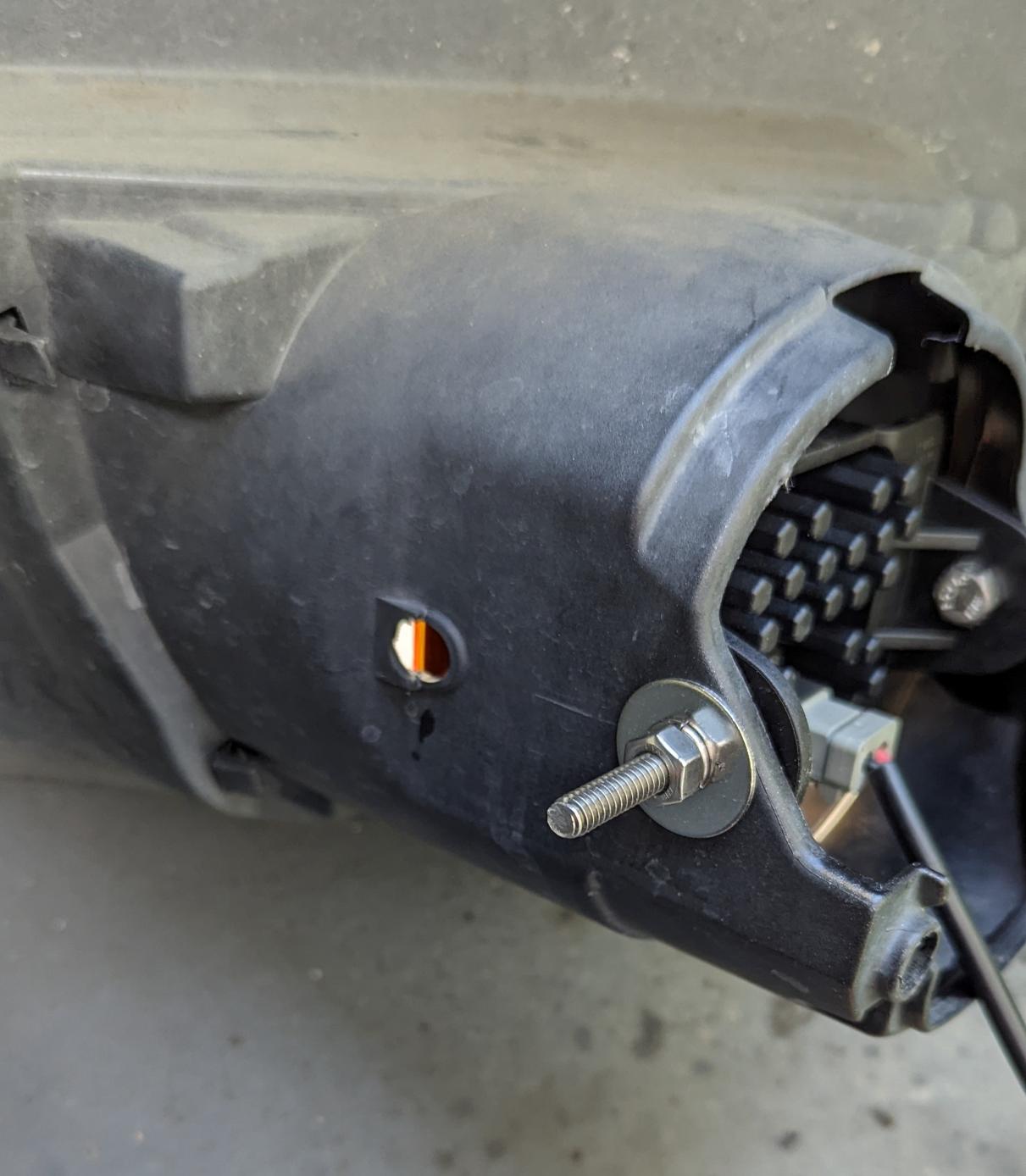

finally did mines, I really trimmed out the f2 brackets, not sure how the stock fog light shroud was going to fit over, but it didn't for me. used some nuts and bolts, trimmer the brackets flushed for the inner mount so it have more to the bumper, the out mount goes to the stock holes, also used some larger washer in that area with nuts and bolts so it should not pop out
update: seems like my holes wernt far enough back, maybe thats why the uncut bracket didnt work.
parts used
1/4 20 thats 1.5 inch long, you can make 1 inch work.
split washers, 1 inch wide washers

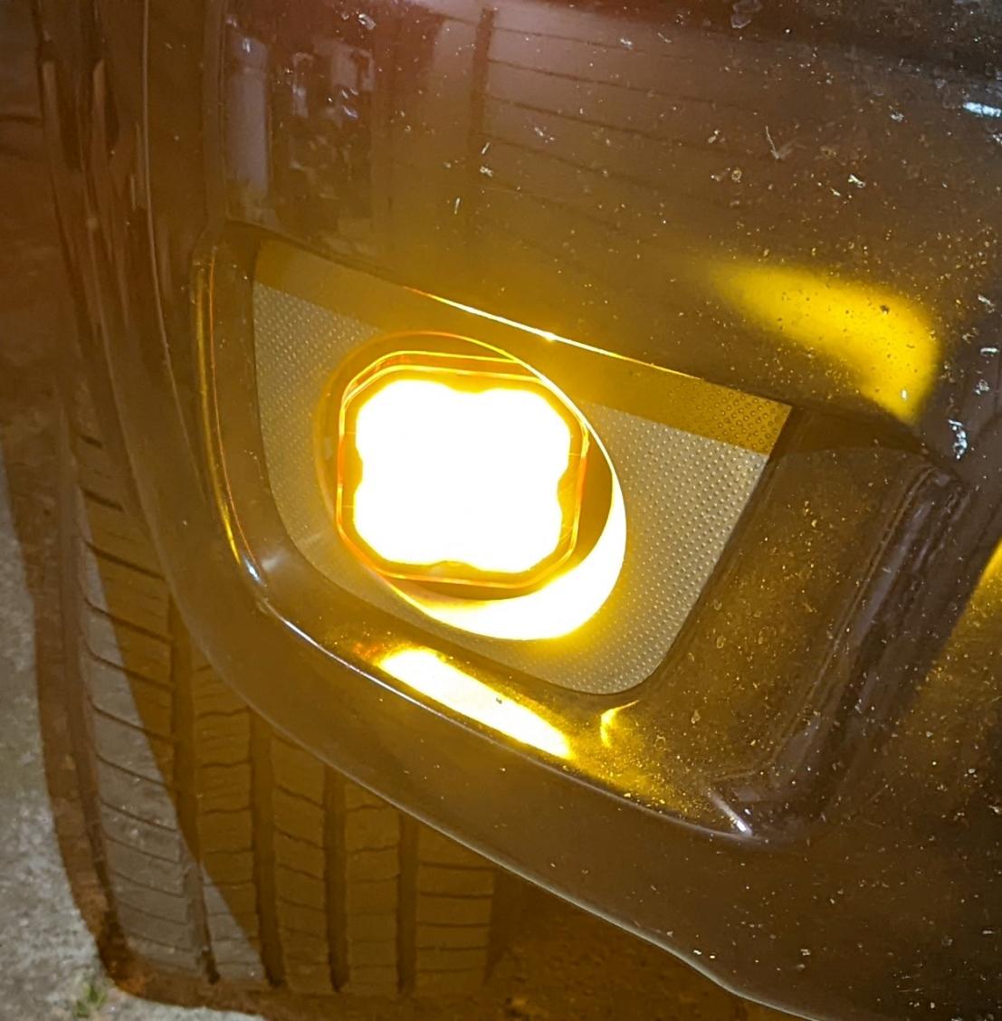

more pictures since each post can be max of eight. the bigger washer should stop the mounting tabs from popping out. i know one of my tabs was flimsy so this should work better. so secured. if i take the covers off the light is more yellow, covers on and its more amber.
