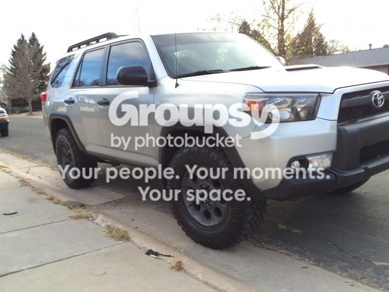

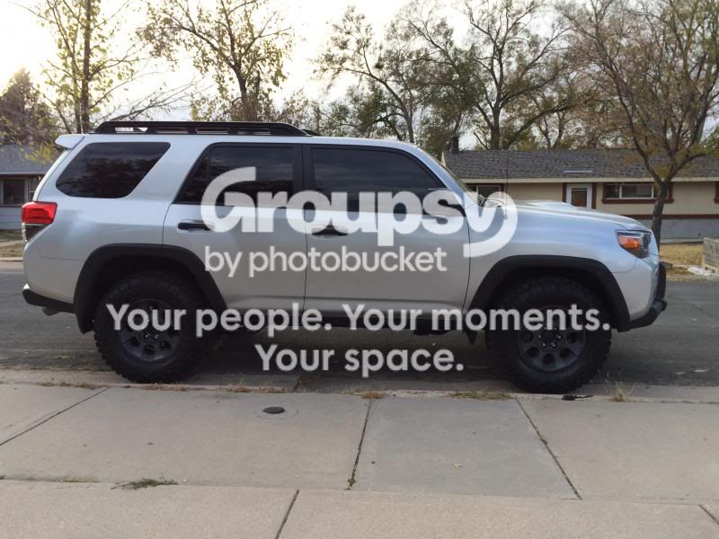

I dipped mine last weekend but haven't had time to take any good pics. It's been dark every night by the time I get home from work. I'll try to get a few Saturday morning & post here. They look good, but I worry about the durability. Luckily it's pretty easy to do touch ups
Work sucked today, so I took off early and grabbed a couple pics as the sun was about to set on my way to drop the dog off for grooming.
plastidip2_zps2362fbe6.jpg~original
plastidip3_zpsfe38d6c3.jpg~original
its surprisingly durable, especially considering the prep I did, which was wiping the wheels down with a wet paper towel... Taping up was a pain, I've never painted wheel on a car before.

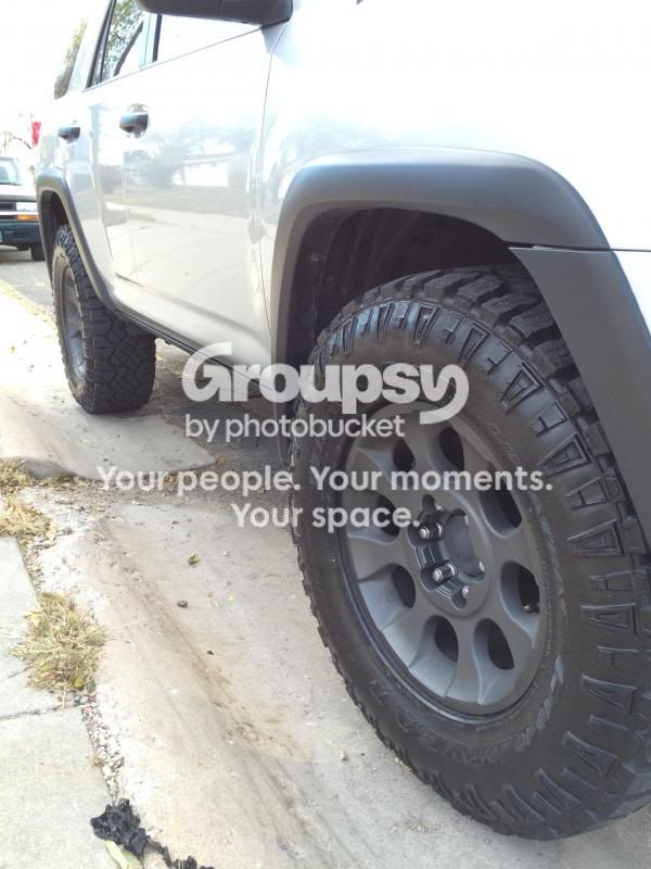

edit: what's funny about the photoshop I made..... it looked exactly like the real thing did when I was finished. Granted mine is a second gen, this is what to expect.

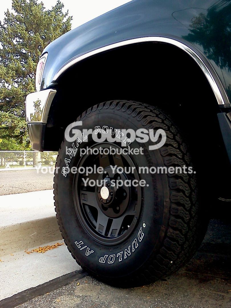

i also have pics in a thread i started..stuff holds up great....everyone always asks me what i did to make them look so good and that it must have been "expensive" haha
