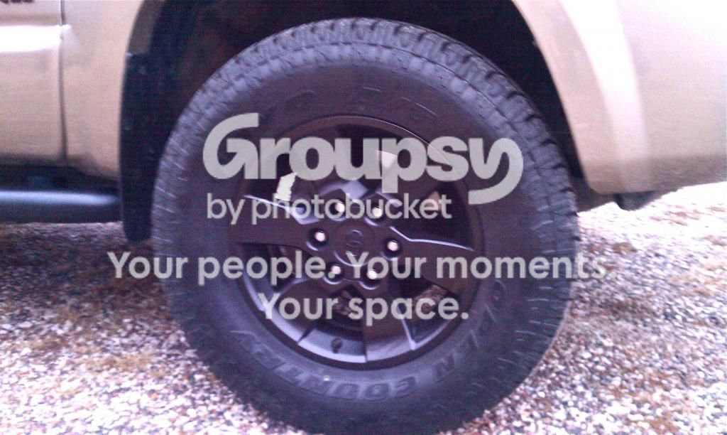

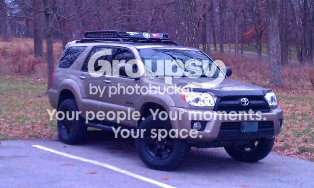

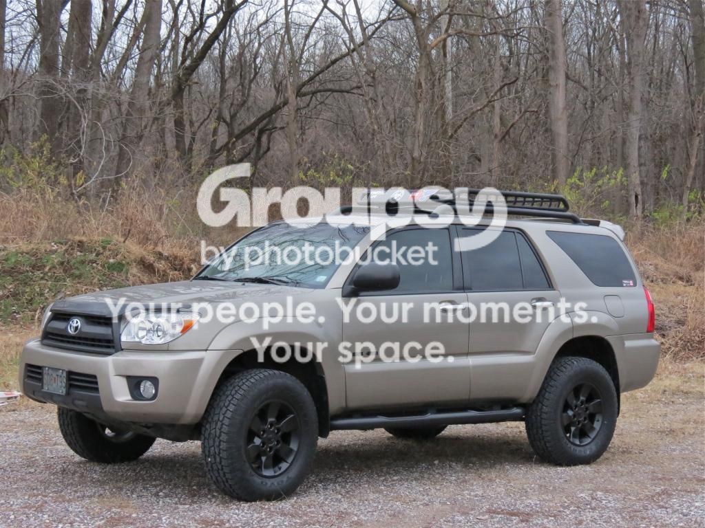

I dipped mine last weekend but haven't had time to take any good pics. It's been dark every night by the time I get home from work. I'll try to get a few Saturday morning & post here. They look good, but I worry about the durability. Luckily it's pretty easy to do touch ups
Work sucked today, so I took off early and grabbed a couple pics as the sun was about to set on my way to drop the dog off for grooming.
plastidip2_zps2362fbe6.jpg~original
plastidip3_zpsfe38d6c3.jpg~original
Here is one with a decent camera

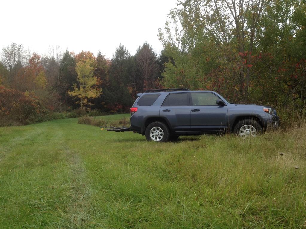

Previous stock wheels for reference
20104runnersidestep.jpg~original

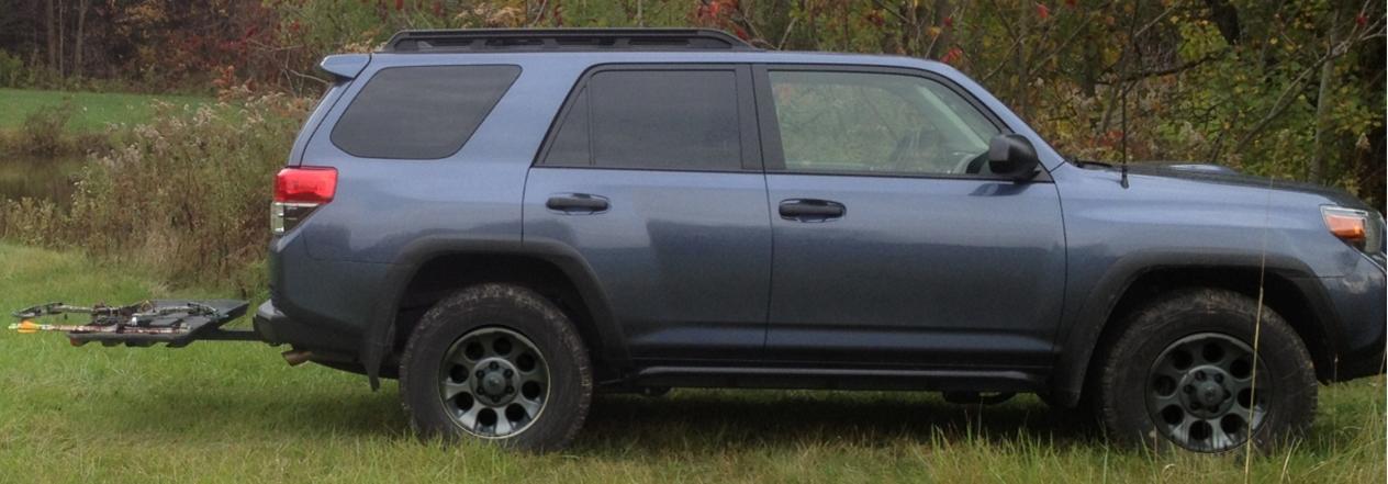

Here's a before and "after" of what it should look like. I'm digging it.
