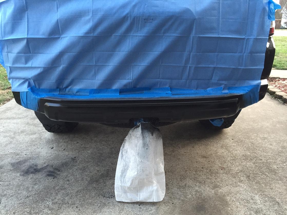

For those of you who have done it on a 14-15 trail, did you remove the valence or just mask and spray? Going to be doing them this weekend and want to get everything set. The front looks pretty accessible, but the rear looks like it would be difficult to get good coverage around the hitch. Thanks!
I had no issue just masking and painting. I just taped off the hitch really good and want at it. Just make sure you put a bunch of coats on, makes it easier to peal the excess. image.jpg

[MENTION=103040]nguyenn[/MENTION] - How did you handle painting the part of the flares that are molded into the bumpers? I was planning on doing a thick coat, and peeling the tape while it was still wet. Any other methods that you used that might work better?
I sprayed about 5-6 coats and peeled the tape when it was completely dried.
