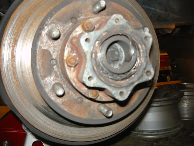

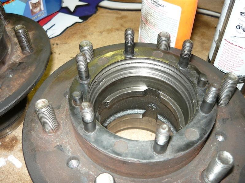

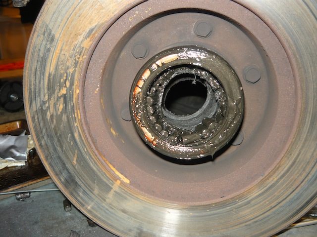

I knew going in that the wheel bearings in the driver front were shot and figured I might as well go ahead and convert to manual hubs. Ordered the hubs from Warn, picked up all the bearings and pulled it into the garage.
You can see in the picture that the driver side looked like it exploded. The races in the driver side were a PITA. When they let loose the PO drove it to the point where the center cap on the wheel melted. I guess all the heat really locked them in there well.

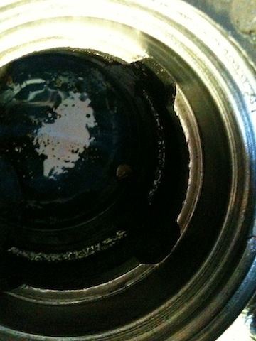

Once off I noticed some pitting in the driver hub on the outer race housing (right side of 3rd picture). I don't think this will be that big of a deal but if anyone has any other ideas, please don't hesitate to let me know.

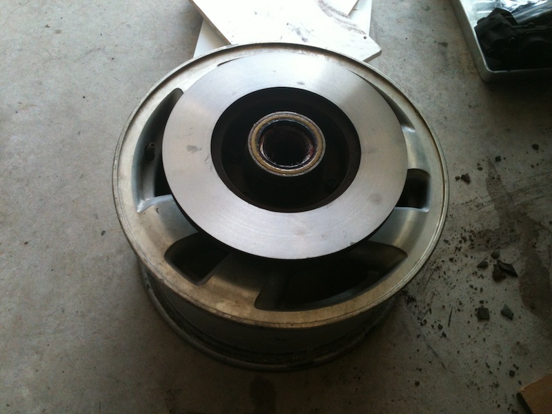

Well the rebuild is on hold for a little while now. Once cleaned I noticed the driver side hub is scarred and grooved pretty bad. On the hut for a hub now.

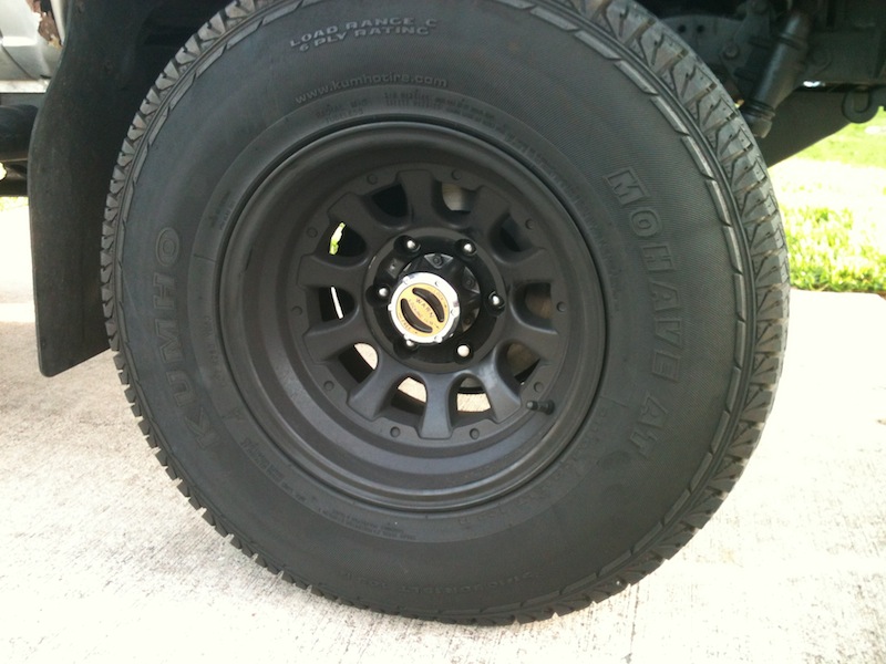

Found a hub yesterday in a local yard for $45. Installed all the races/bearings and manual hub conversion kit today. Nice that I can actually drive it now, but I may have torqued the right side axle nut a little too tight. I have a high pitched whine coming from the right side when moving.

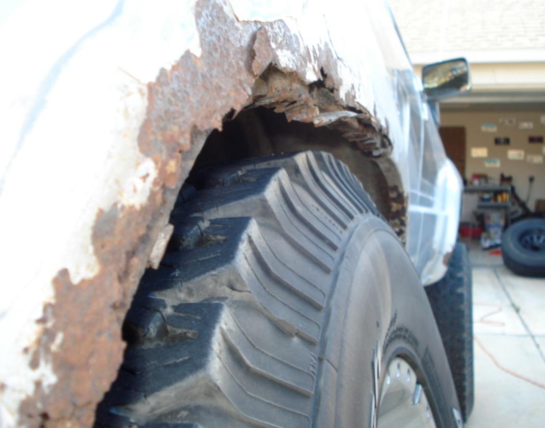

Started a little sanding to see what my options are with the rust and I think I have decided to clean it all up, fiberglass and body fill to keep it stock looking. I don't think I will ever go to anything over 33s and from what I am reading they would fit with the stock fenders and a little trimming.

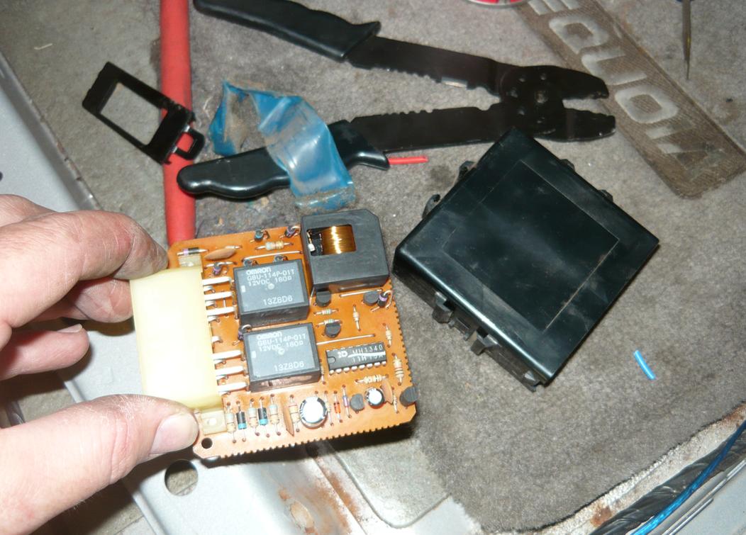

I got everything I thought I needed to get this passenger window going. Got it mated up in the door, did some quick temp wiring and nothing. Jumped the motor from the battery and it worked like a champ. Started taking some voltage readings and found that I only had 4.5 volts at the motor when the switch was activated. Check the power to the switch and had 12 volts.
So I went looking for the "Door Control" relay box. Found it behind the ECU, right where it should be, and of course once I had it out I could smell the burning smell. It didn't look bad but I am gonna assume with the smell that it is in fact bad.
So now I'm trying to decide which way to go. Part of me is thinking that I should just wire 3, 3 pole switches in the center console for the 3 windows and call it good. The other option would be of course to find a control box.

I would get rid of the power windows and find some guts from a manual window door and install them. In my mind, less is better. Keep things simple to keep reliability up. If you don't want to do that then I would go with your idea and wire your own window switches.
For some reason even with the number of yards in the Houston area, I haven't had any luck finding any 1 Gens around for parts. I might start piecing things together over time for some manual windows cause I do like the idea of keeping it simple.
Good news is I gave the control box a little electrical component "drop kick" and everything is now working. I doubt it will last long so I'm gonna go ahead and get the relays and what not ready to make my own switch panel in the center console. SV I think it was you that posted a schematic of a back window setup. I copied the picture for my notes a while back and I plan on just adding to that set-up for all three windows.

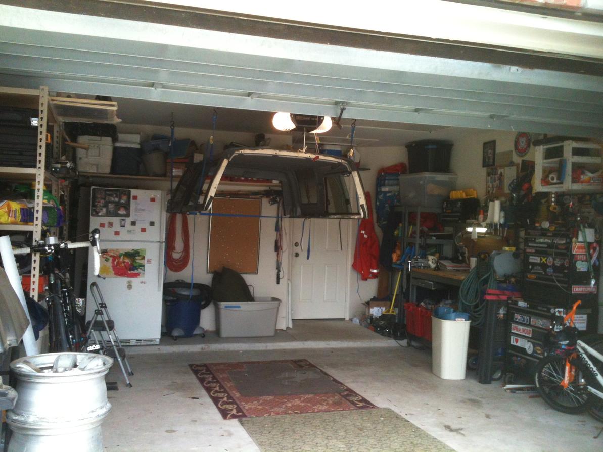

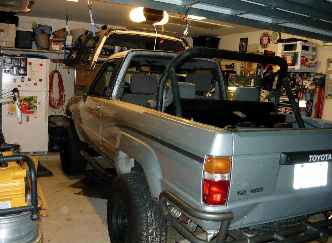

Put some hooks in the garage ceiling and attempted to take the top off today by myself. Can't take credit for it as I saw someone on here that said to just use friction straps. Once I had all the bolts disconnected, I slid it back a little ran a strap along the back, hooked up the front, lifted them all a little and drove out.
Worked like a champ. I was even able to put the 4Runner back into the garage, nose in or back in. Best part of all though was I was able to put the wife's car back in. This of course was a MUST.

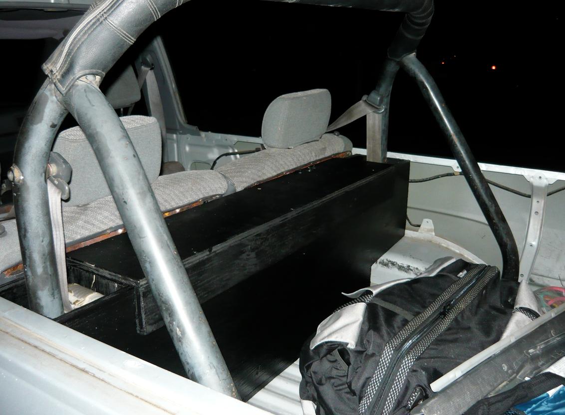

Next is the U Joints and some MDF boxes for the inertia reels that I added for the rear seats. Got to keep the dust and dirt out of em.

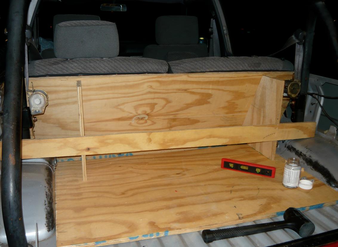

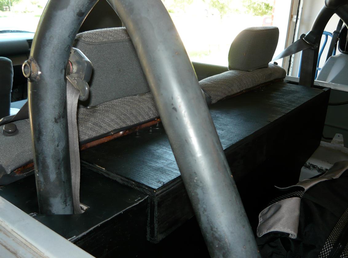

I am by no means a carpenter, I can't draw a straight line with a ruler, but I finished my box behind the seat today. I'm not real happy with the way the gasket material for the inertia reel came out but I have an idea that I think I will like. It's not meant to be water tight or any thing, just looking to try and keep some of the dust out of the mechanism. Once I take it all out again for the POR-15 that I plan on doing, I will fix it.
