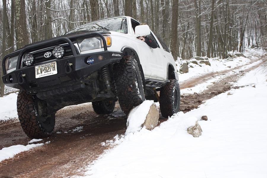

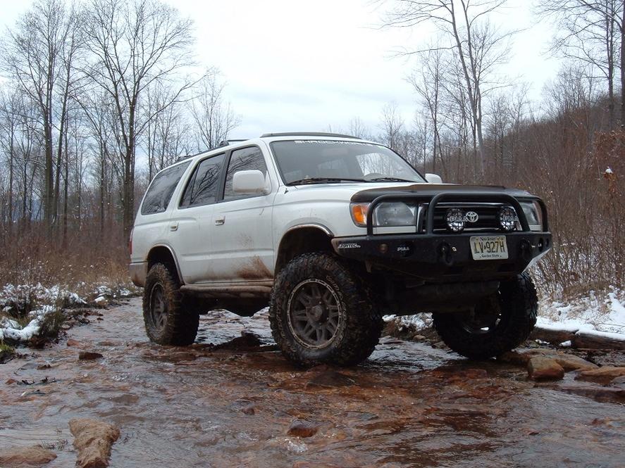

First group run with with a couple northeastern 4Runners. This many 4Runners look great together. Had a good time, nothing serious just a good time in the trails.

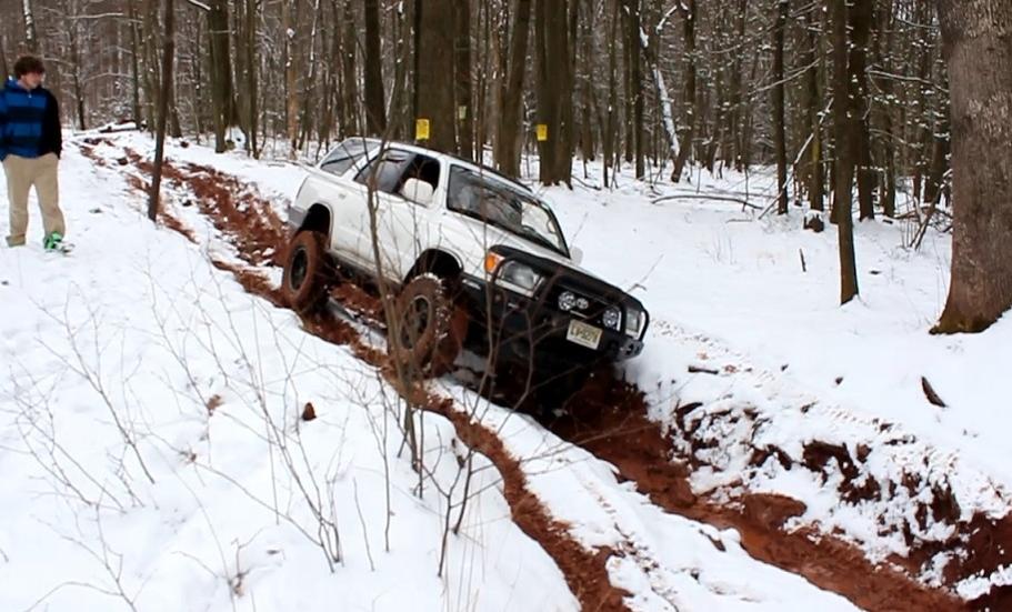

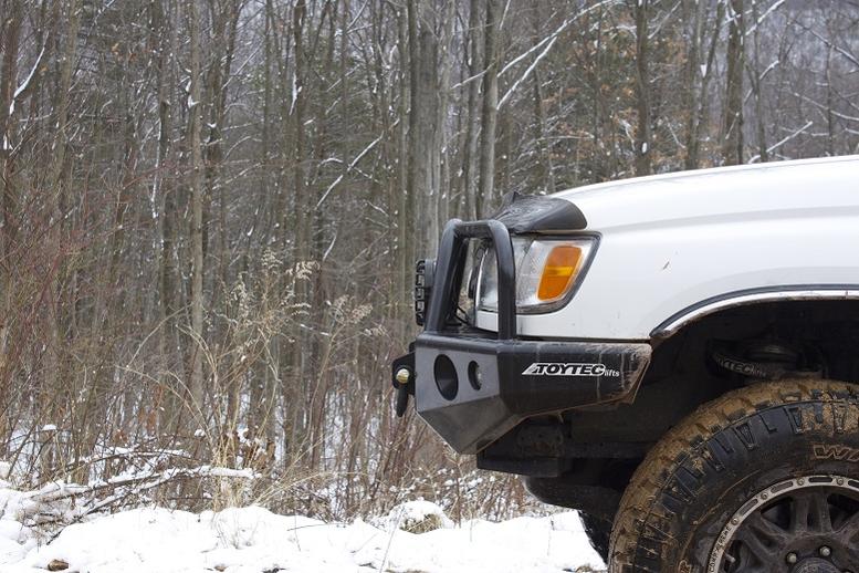

7 month wait for the Shrockworks bumper!?!

Yeah, that was a pretty standard wait time when I placed the order, I was expecting to have to wait, but not that long. However, I have heard that their lead times are less now due to new equipment being used.

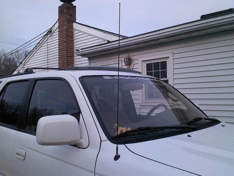

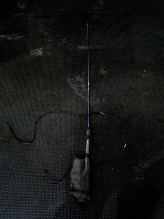

Moved onto the Tacoma whip antenna mod.
Pulled this ugly thing out
And replaced it with this. Reception is much better and looks so much better than the old antenna

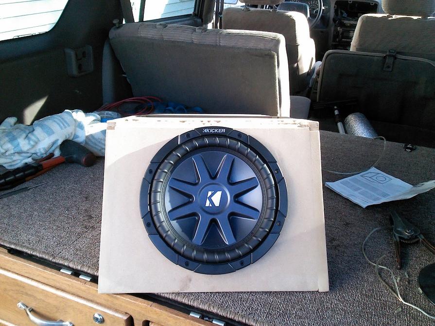

So this past Christmas, I received a Kicker CVR 10 DVC Sub. It's a sub that requires a lot of power to work properly, so it took some time to find a quality amp within a reasonable price range. I finally found a JVC 800 watt mono channel amp, at a great price. Once it was delivered the work began. The project is almost complete so I'll update as I get pictures.

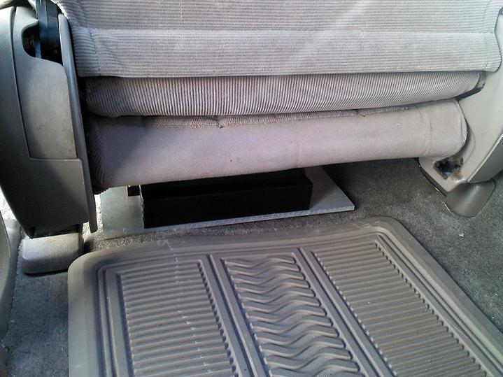

The amp is mounted under the driver seat on a piece of aluminum, to keep the heat from building up, which I then simply used Velcro strips to stick it to the carpet.

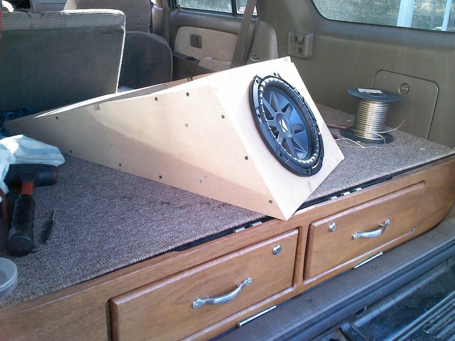

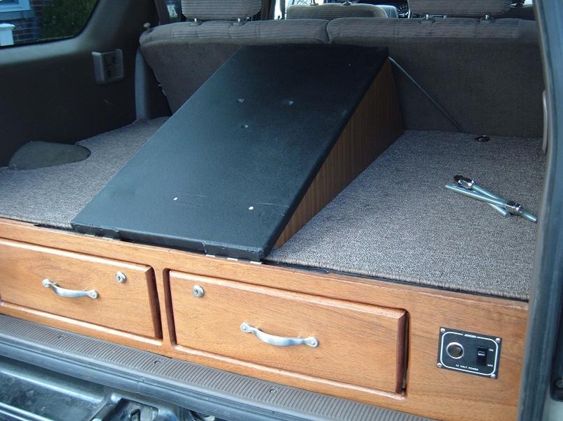

In a previous post I have a picture of how the cargo area is going to be set up. I made a wedge shape to mount the spare tire on, well with some modification to the box it turned into a perfect sealed sub box.
I am more than happy with the set up. I am by no means rattling windows, not saying the speaker can't, just personally that's not what this sub is for.
The MDF is now treated and covered to protect it from getting wet, which I hope it never does, now that there is a speaker in it. I'll be sure to post more current pictures, now that it is in place, and gave it a little test.

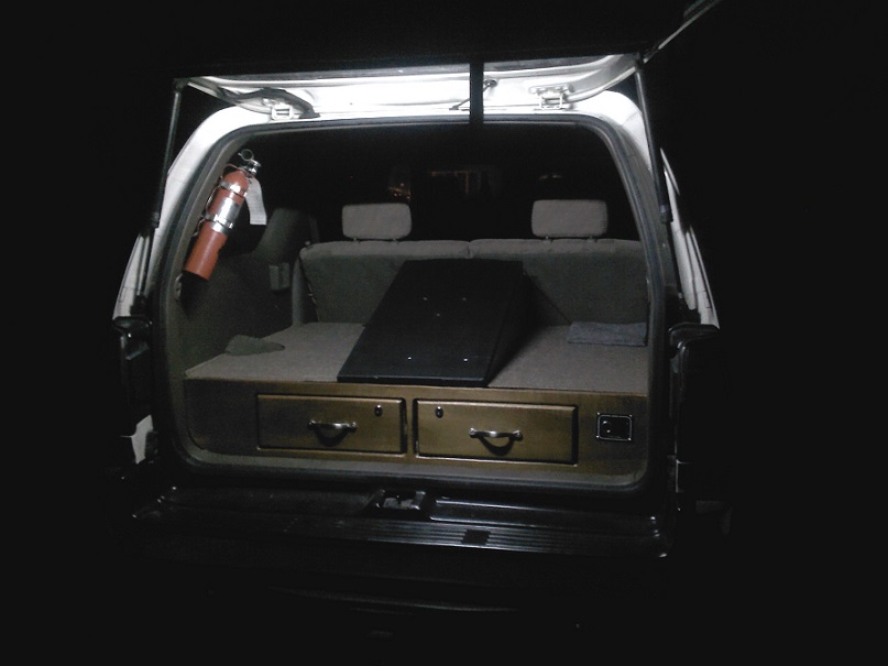

So it was the first weekend this year here in the northeast that was in the upper 50s so I took advantage of the great weather, and made some progress on the truck.

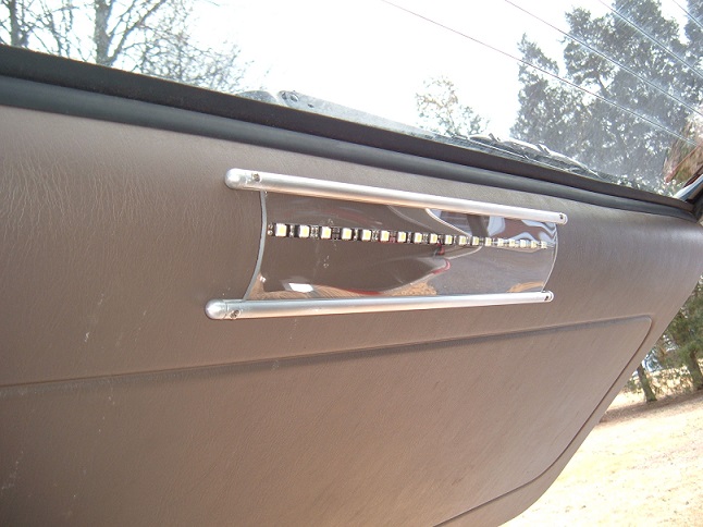

Installed this 12 inch LED strip in the cargo area, and made a shield for it, I sometimes will carry my kayak inside, but also anything else that needs to hang out the back. In that location an unprotected led strip wouldn't last long.

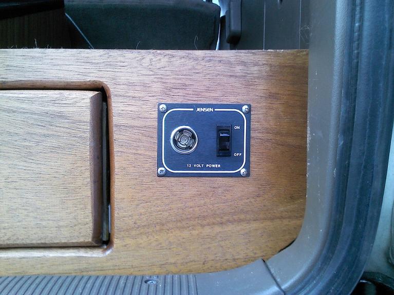

And then I cut out a spot for this switch for the light, and also ran 12 volts back to it so now I have a power outlet in the rear for what ever future plans require power
And of course a night shot, I was super satisfied with the light output and the angle. For my needs there's just the right amount of light

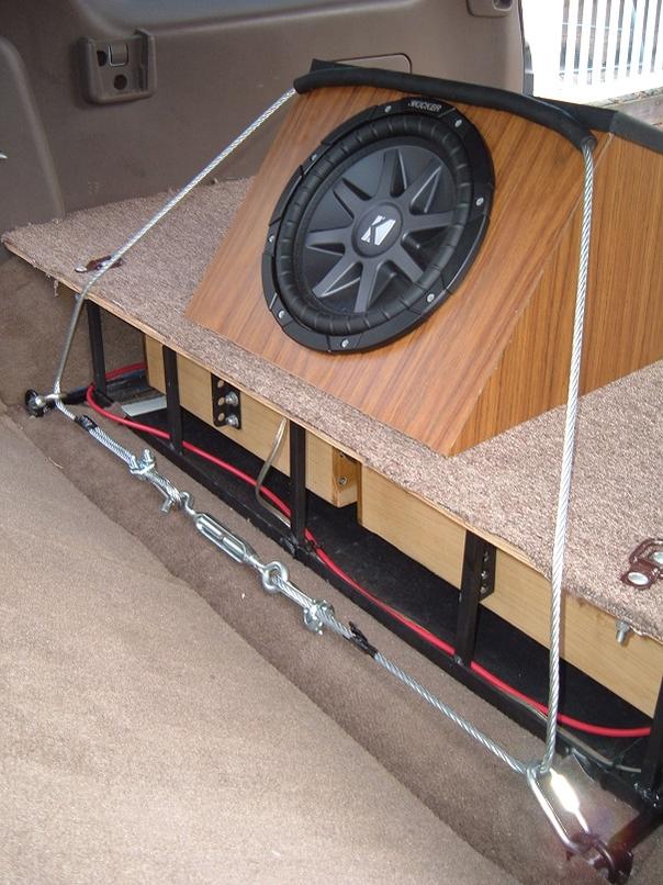

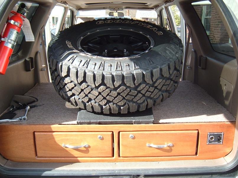

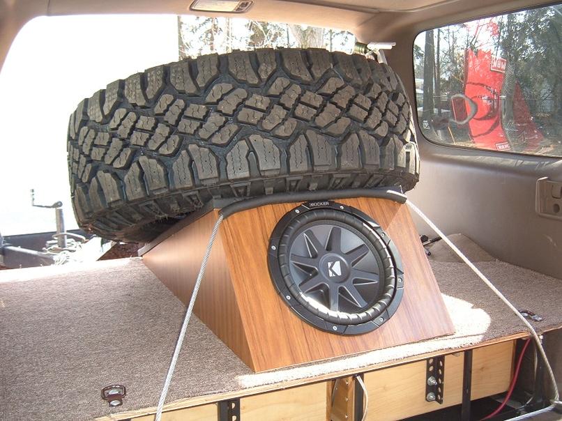

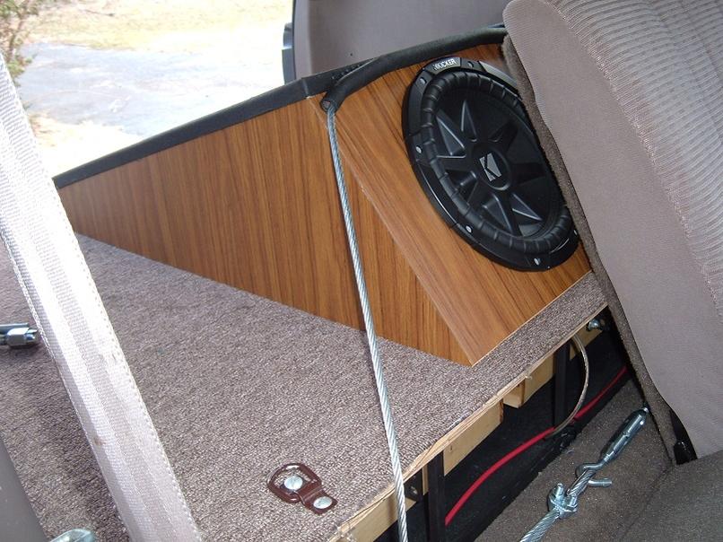

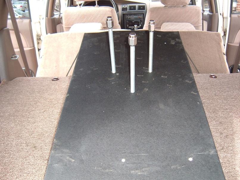

I also managed to finish up my spare tire mount/sub box.
I finished the outside of the MDF that made the box in some stuff I found in my basement, it was once supposed to be used to cover counter tops back in the like 70s, but I found a new use for it. Just cut it to size and glued it on. The metal plate on top is where the spare is going to sit. I used some dupicolor bed armor spray paint to coat the metal to prevent nicks and scrapes when sliding the tire around on it. That stuff is super hard to get a nice coat on but after some time it worked out.
To hold the tire to the plate, I used some 1/2 13 all thread and tacked on some lug nuts to get a socket on it to hold the tire secure
Then to hold the box to the truck, but also allow it to be removable I used some 1/4 inch cable to create this...
So the final step was to throw the tire up there and see how secure it is.DSCF3194.jpg

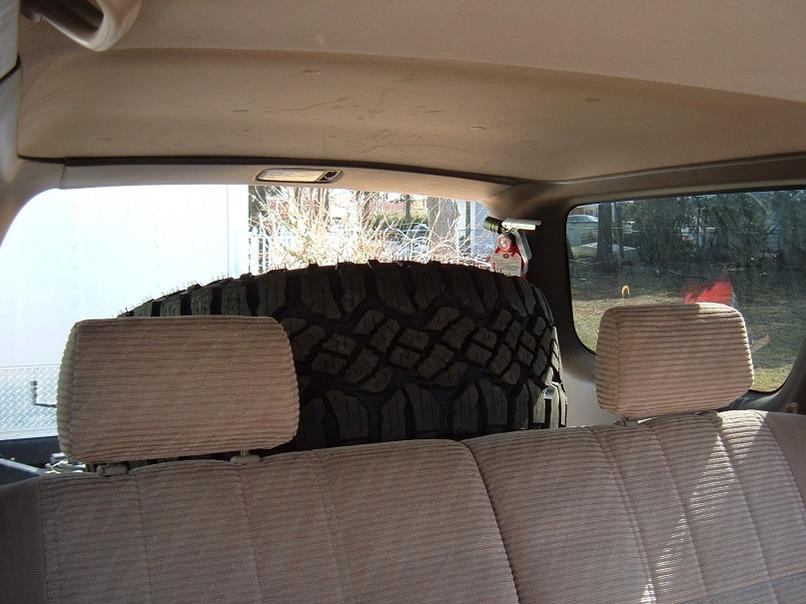

After securing everything down it seems pretty ridged. I did not get a chance to drive it yet with the tire on there so I suppose that will be the true test. The reason I made it removable is because when I go wheeling, I do not want the sub box in the truck, and will just strap the tire to the top of the drawers. The tire does stick up a little higher than I was hoping, but once the idea turned to make the box into a sub box it required a new angle to fit the sub with out it hitting the seats. It's close but it still works great to my ear.
But it's like someone is sitting in the middle seat when looking out the rear view mirror.
Overall I'm happy with the almost finished product. And I'm even more happy because my spring break starts this coming weekend and I'm going back to Rausch Creek Off Road Park for some off road fun.

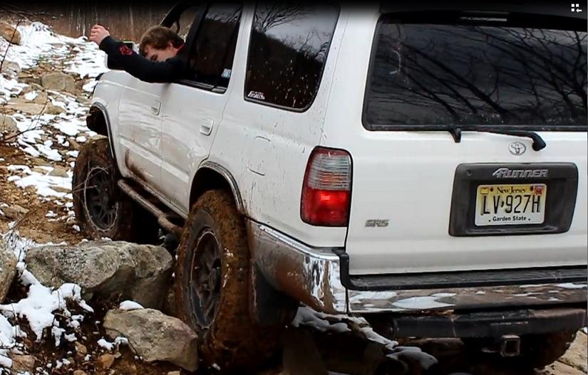

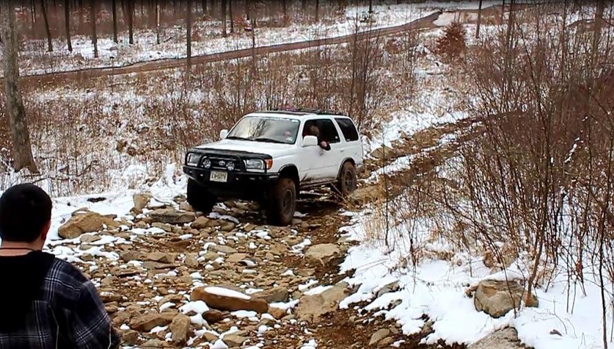

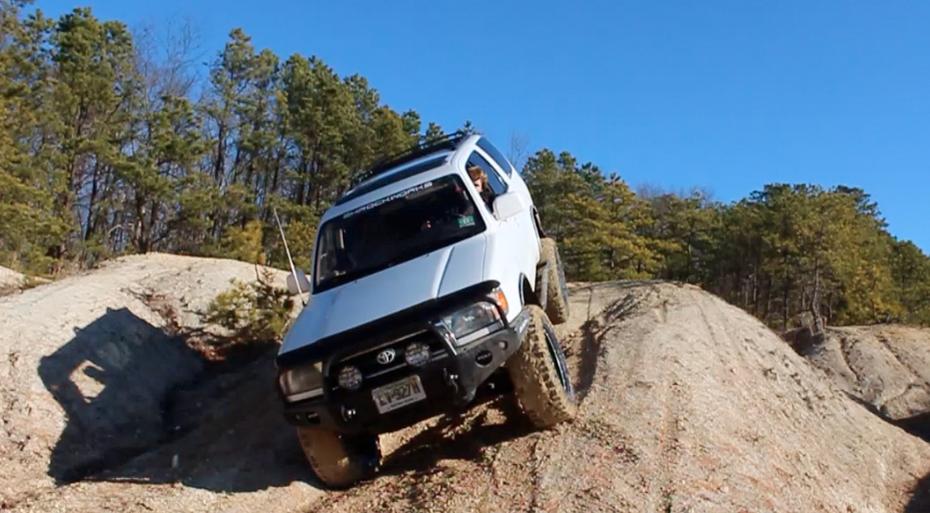

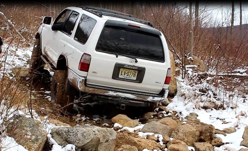

This past weekend me and a Land Cruiser friend took another trip to Rausch Creek Off-Road Park, here are a few pics of the fun times...
