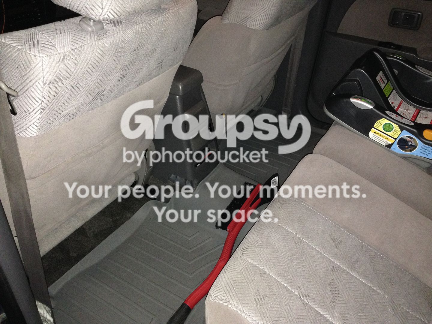

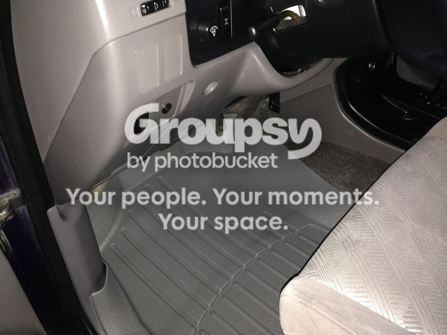

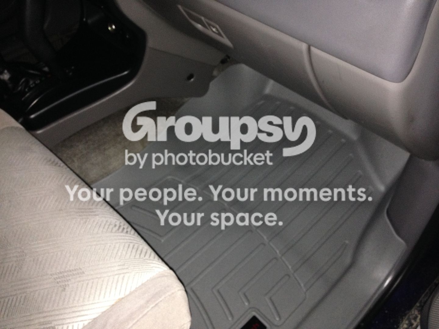

I installed some Weathertech floor mats in the 4Runner. I have these in my '99 and they are awesome! They do a great job of keeping all the snow, slush and salt from spilling into the carpet; pretty much a necessity if you live in a rough climate.

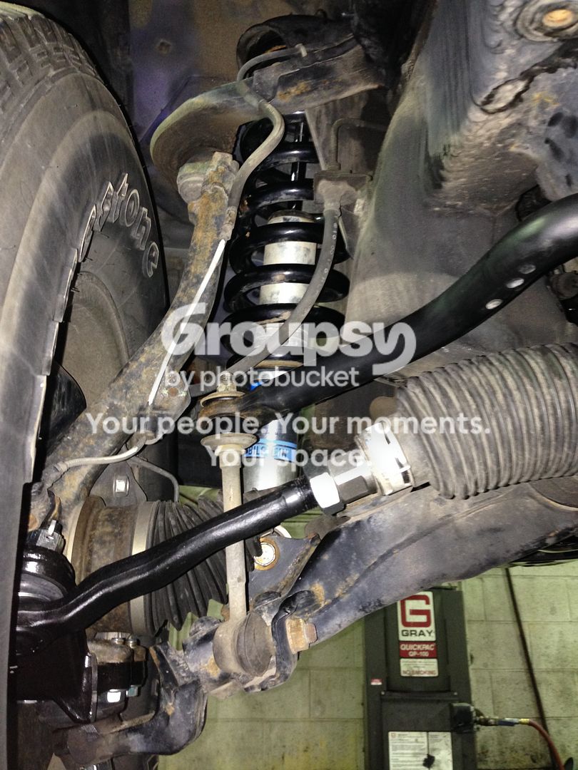

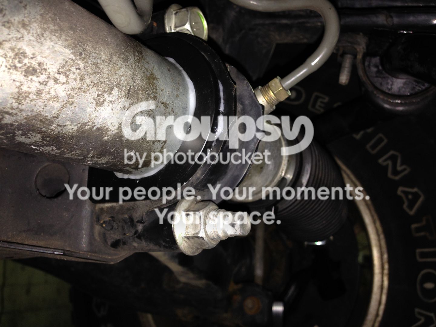

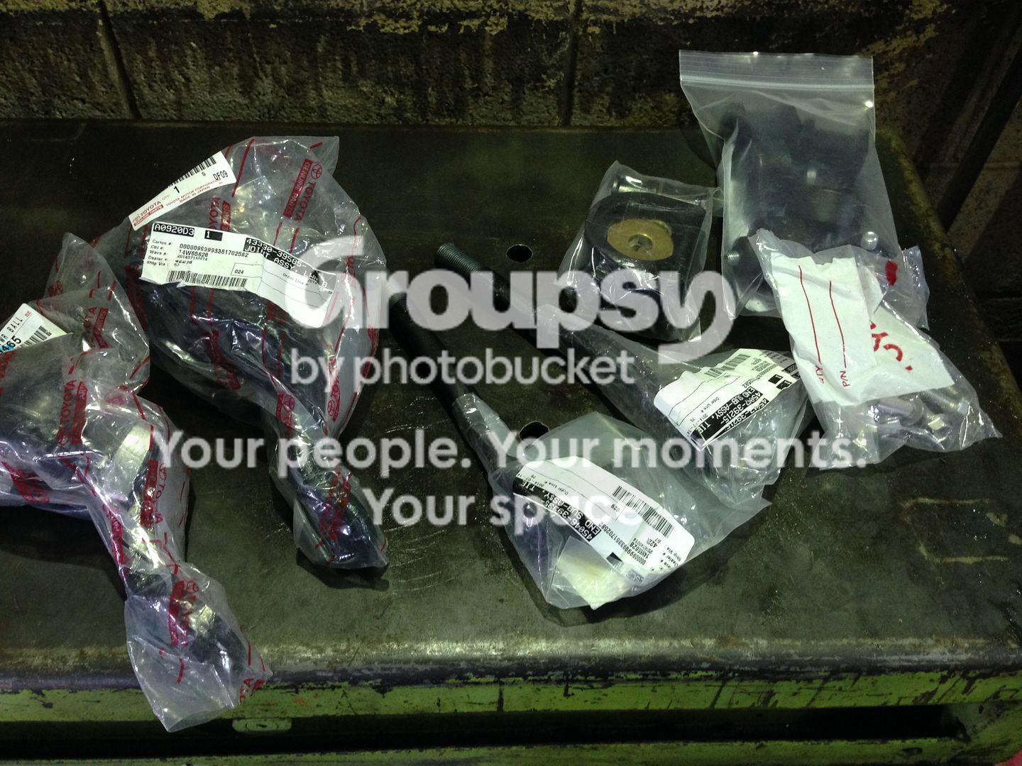

I disassembled the front struts and dropped them down to the two-inch setting, and then I tore into the front suspension / steering. Working out from the steering rack I replaced:
- Steering rack bushings (Wheelers/Energy Suspension)
- Inner tie rod ends (Napa/555 brand)
- Outer tie rod ends (Toyota)
- Lower ball joints (Toyota)
- Lower ball joint bolts (Toyota)
- Front sway bar bushings (Wheelers)
- Front differential fluid (synthetic)

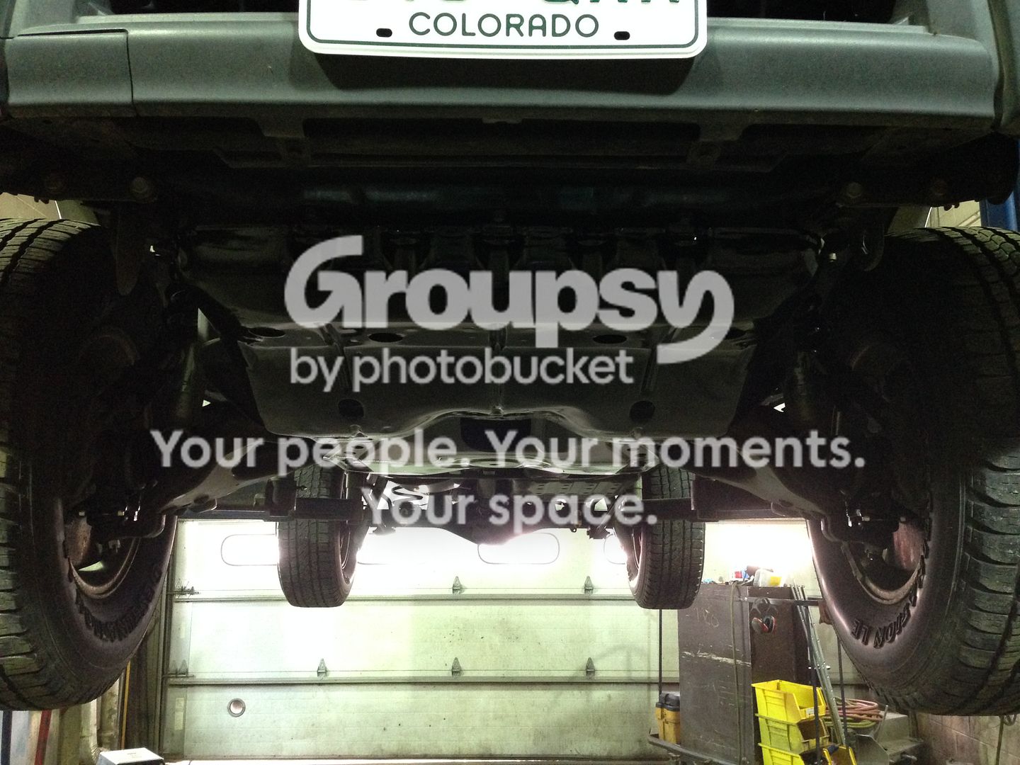

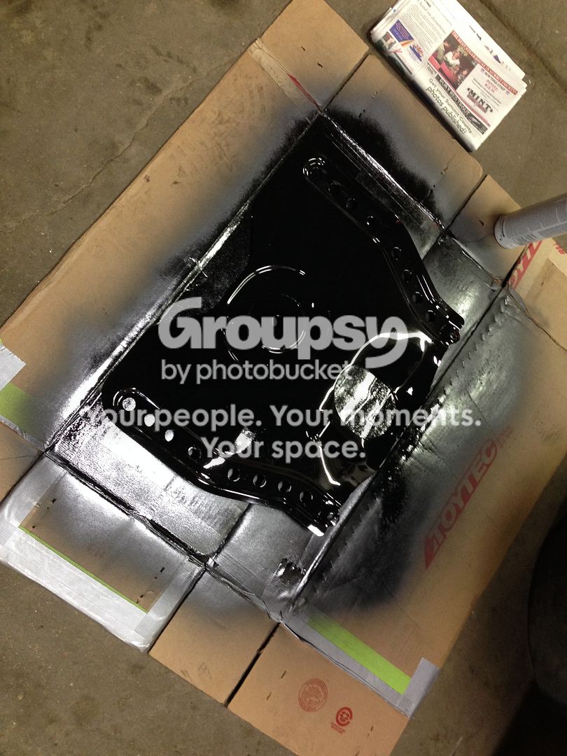

While I had the skid plates off I gave them a fresh coat of gloss black paint, and I also:
- Changed the engine oil (synthetic with Toyota filter)
- Replaced the fuel filter (Toyota)
- Replaced the transfer case fluid (synthetic)
- Replaced air filter (Toyota)
- Cleaned MAF sensor

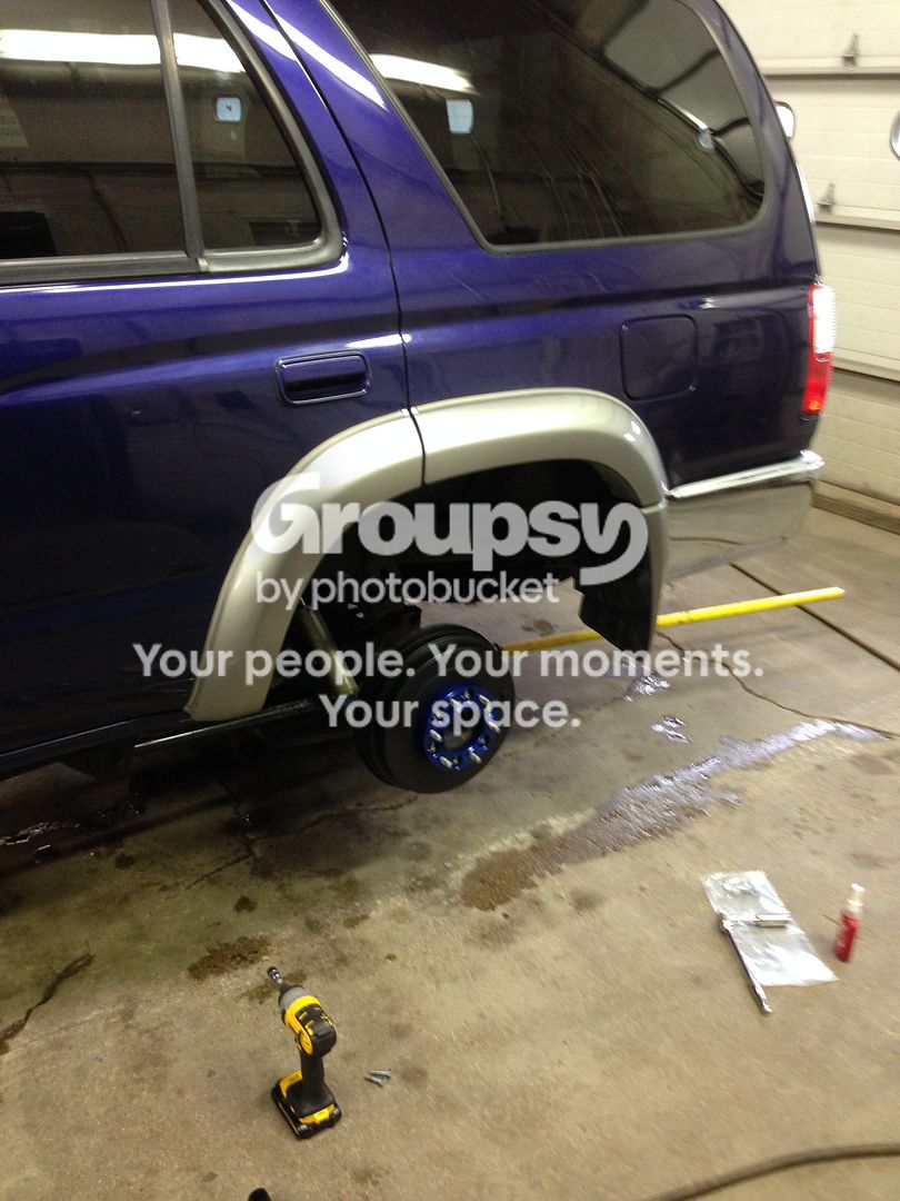

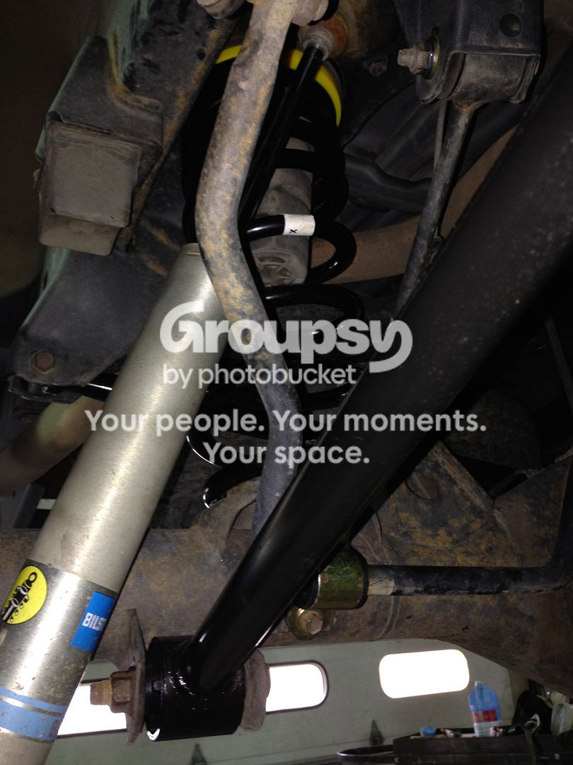

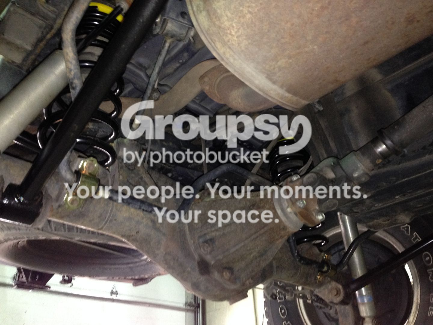

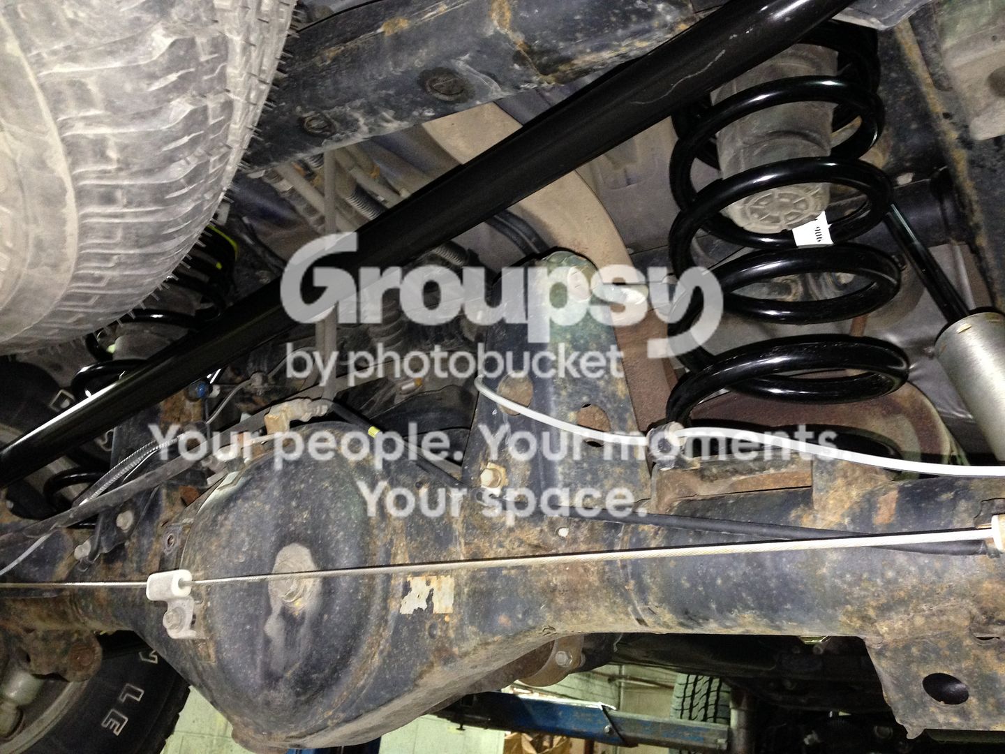

Then it was time to move on to the rear suspension. I didn’t want a whole lot of lift, so I decided on the OME 906 springs with an additional 10mm trim packer. I reused the Bilstien shocks that were on the back of my 4Runner before I made the switch to the “Black” Tokico LC shocks. The bushings in the lower control arms were showing their age, so I installed the used stock arms from my 4Runner that had much less miles on them, along with my stock panhard bar.
I also installed new sway bar bushings and changed out the rear differential fluid.
When I set it down on the ground I noticed the front was setting a bit higher than the rear, so I took the front struts back out and dropped them down to the 1.5" setting (the lowest notch). We'll see how it sets after the alignment.

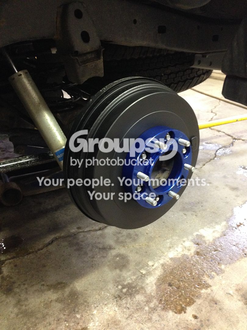

I also have a set of Spidertrax wheel spacers to install, but I'm going to wait until it gets back from the alignment shop. I don't want them throwing a fit about them.

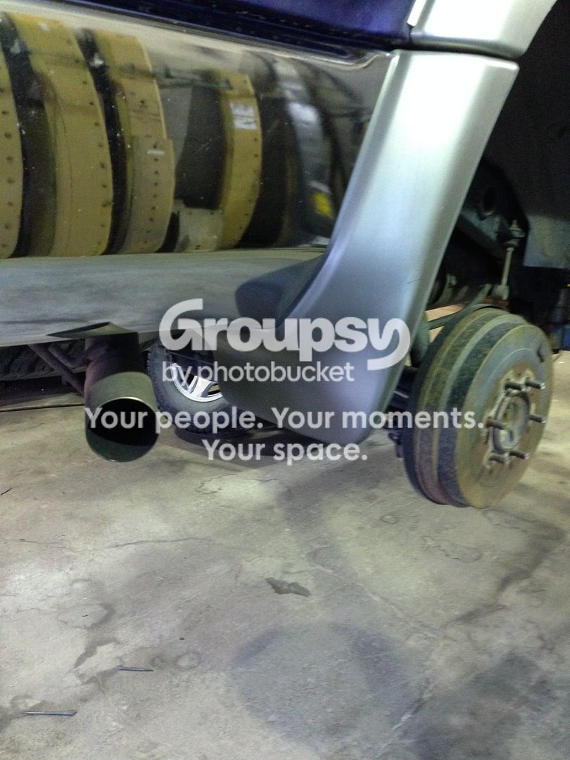

While the 4Runner was in the shop I cleaned and detailed the interior. I also trimmed the lower section off the rear mud flaps.

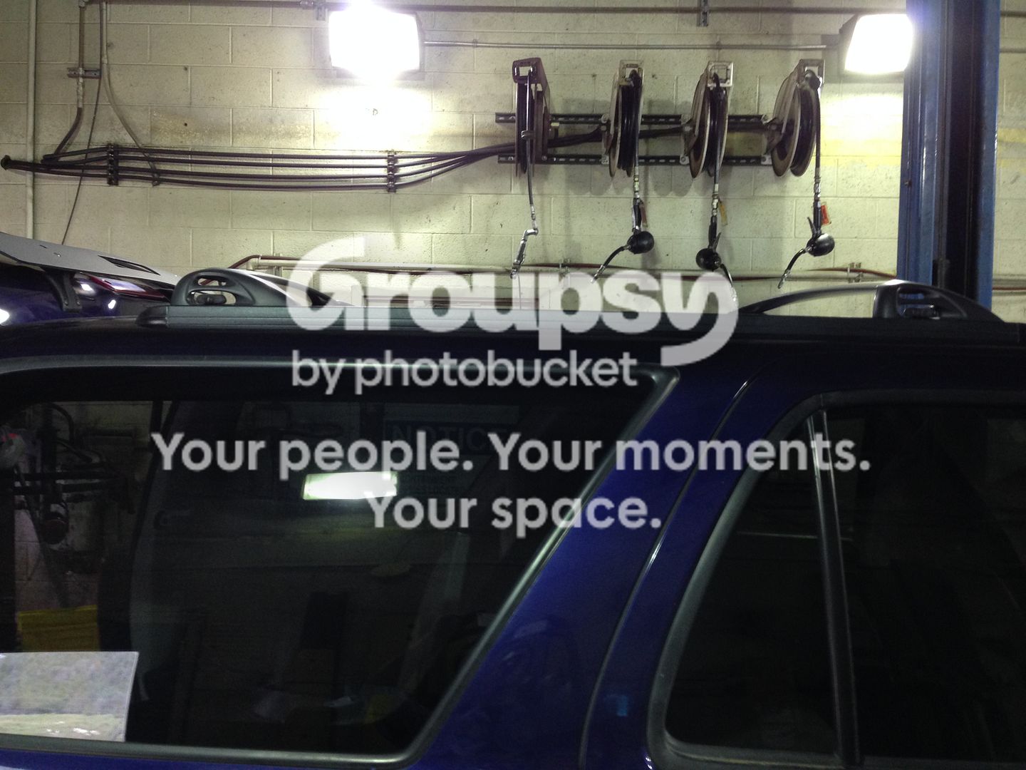

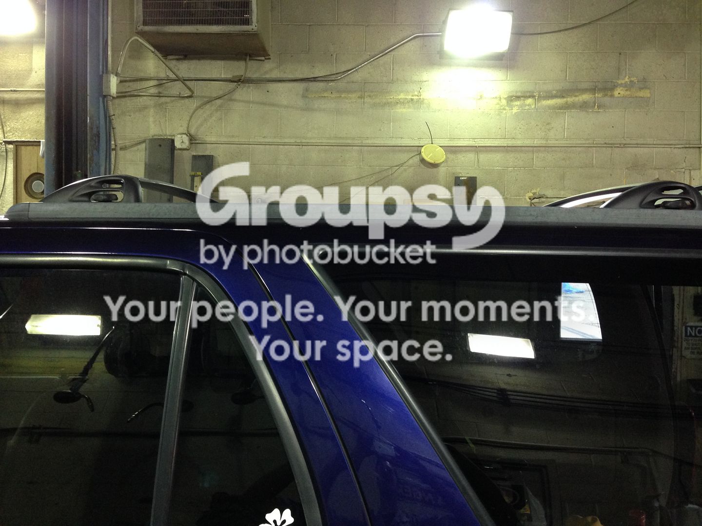

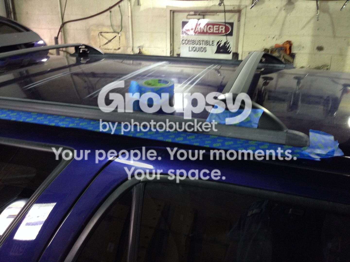

And I hit the upper roof rack rails with some Meguiars ultimate black. They were extremely faded and it really bugged me. It actually worked pretty well. (Sorry for the crappy pictures, the florescent lights mess with my camera)
Before
During
After

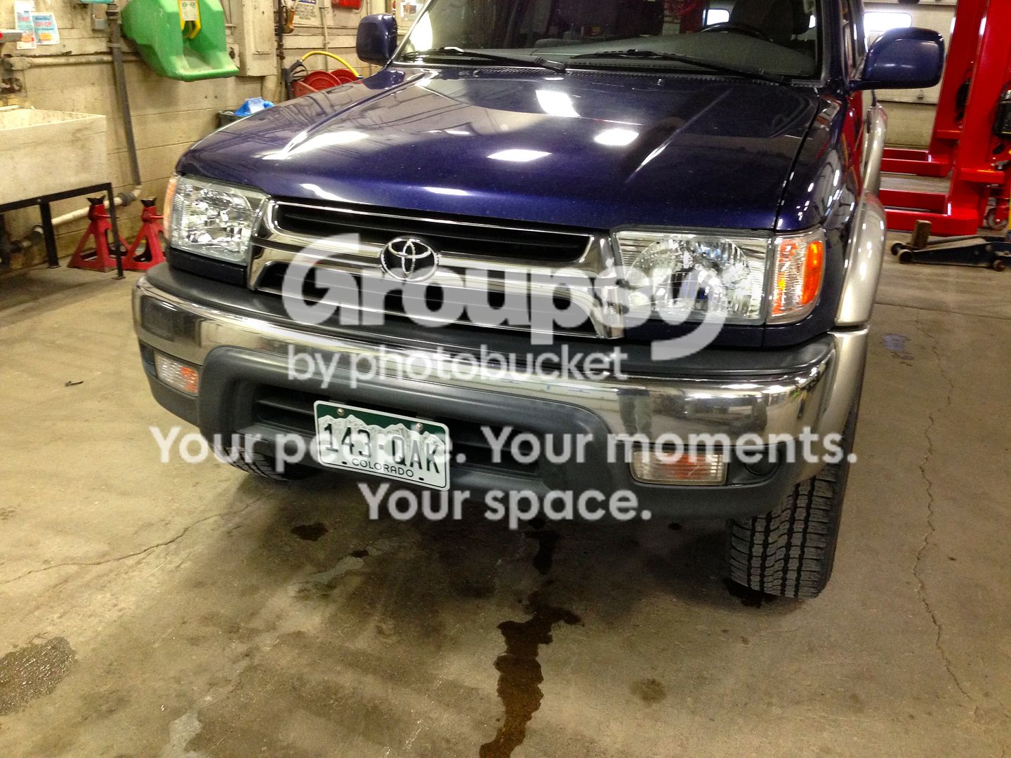

I brought the 4Runner back into the shop for some more work.

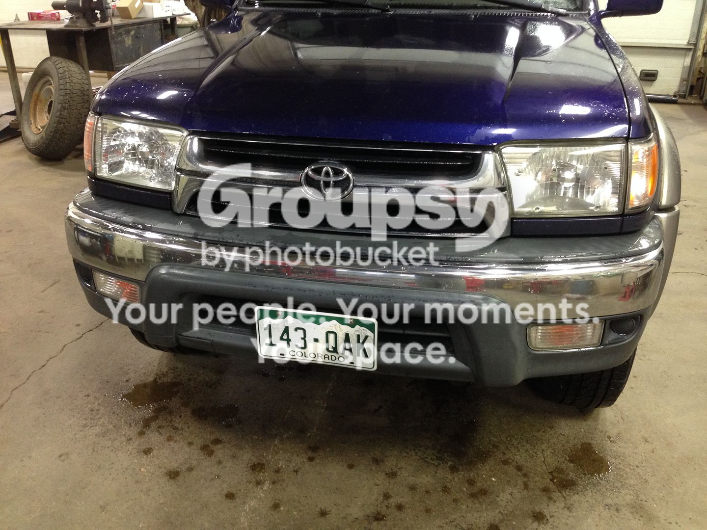

The front of the 4Runner was looking a little sad after 236K miles

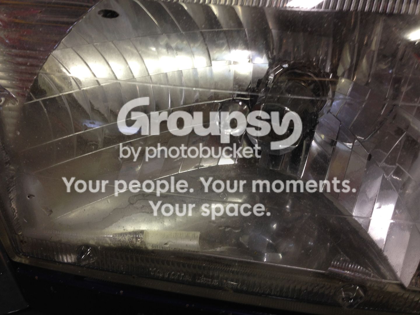

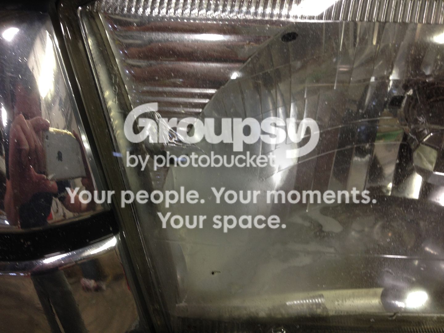

The headlights were shot...

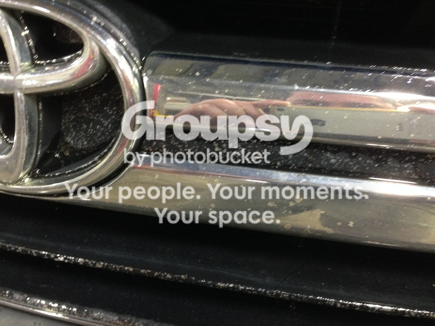

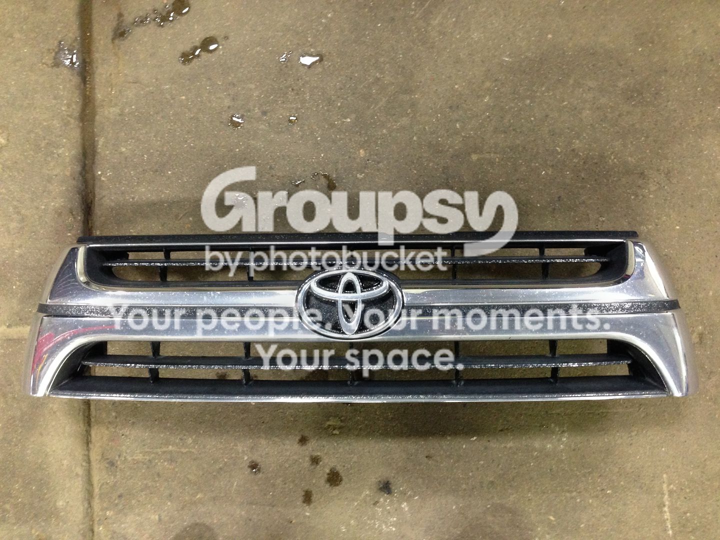

The grille looked like crap...

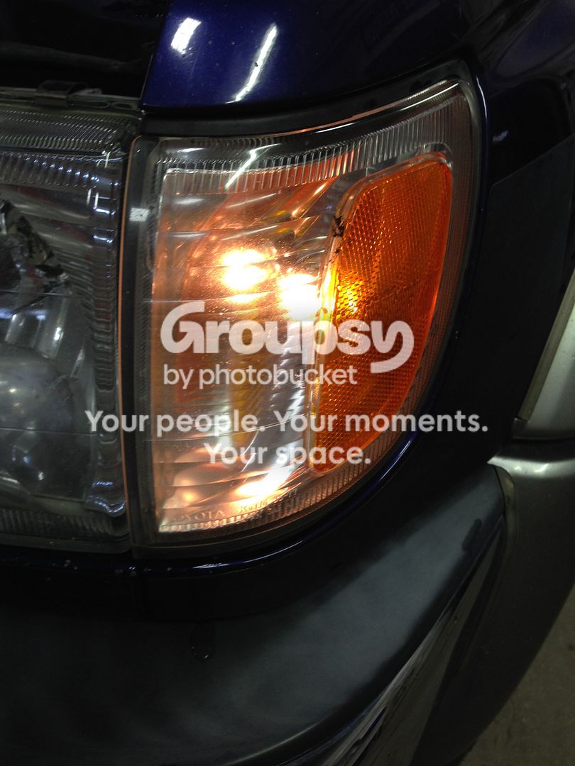

And the corner marker lights were less than stellar...

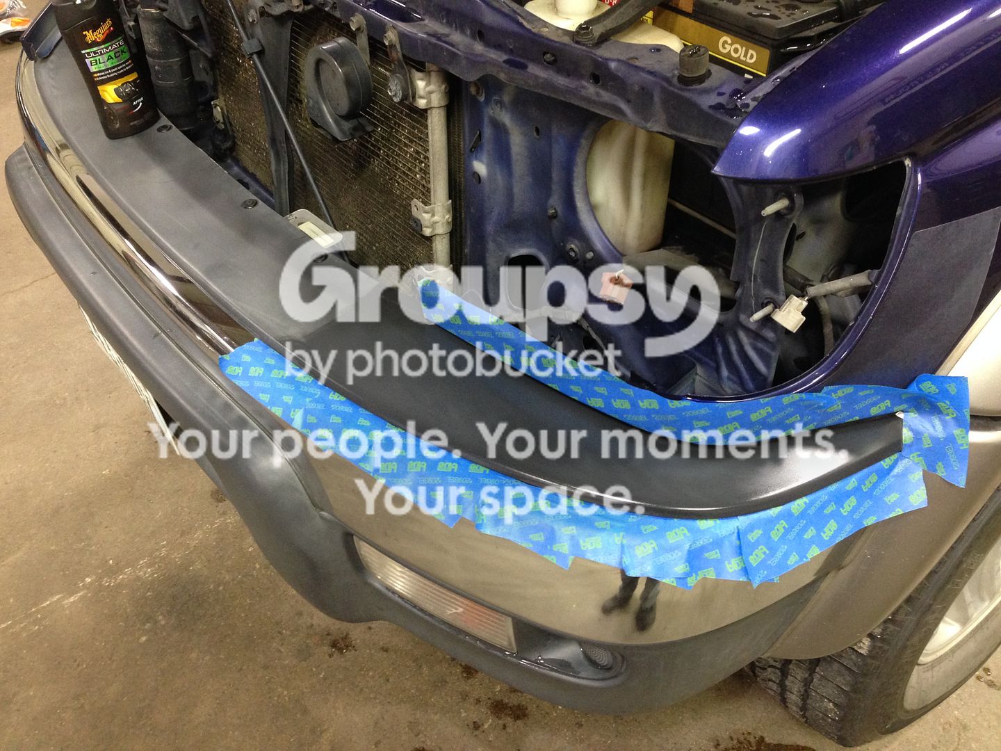

I started out by treating the upper plastic trim

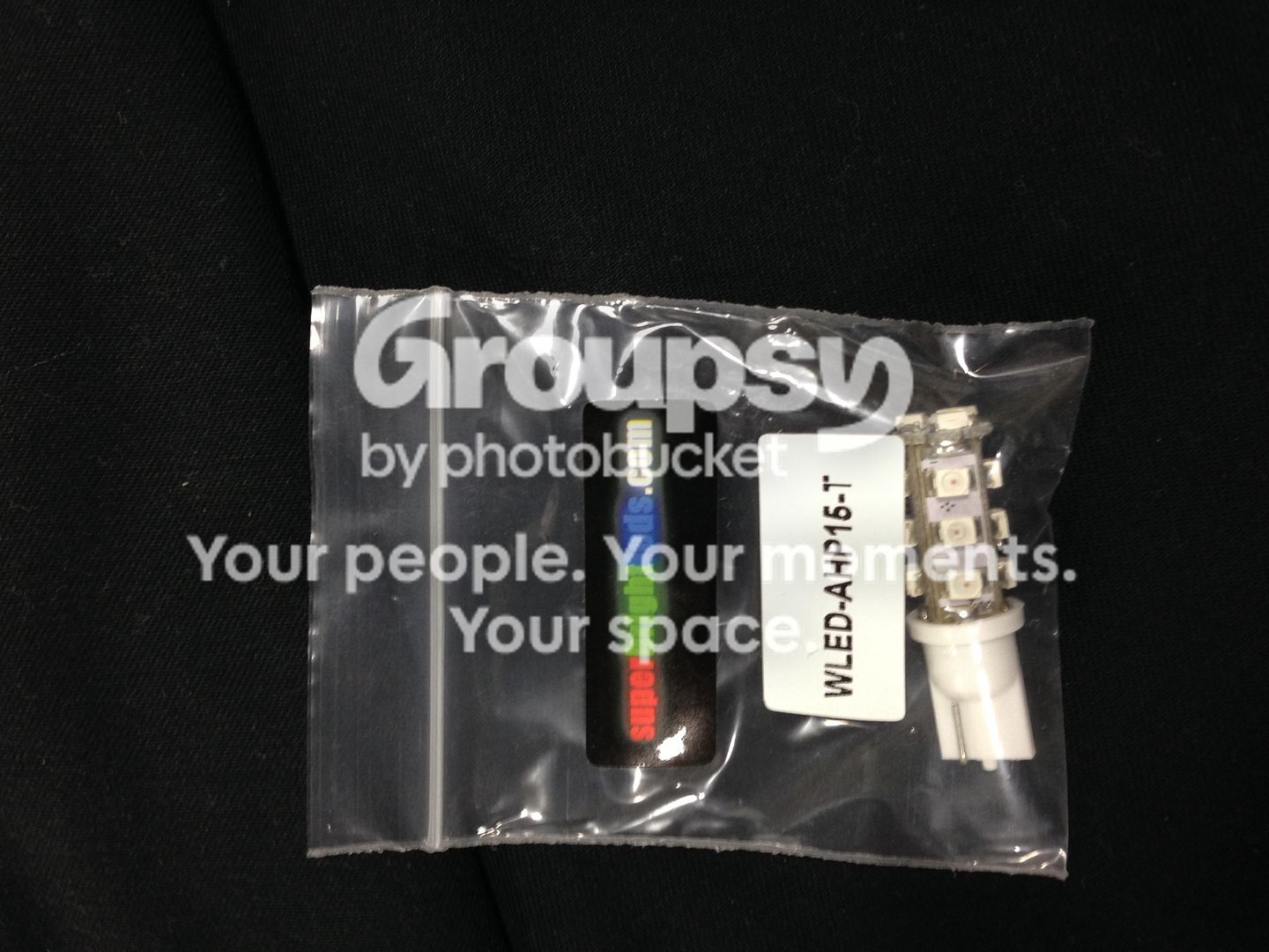

I swapped out the corner marker light bulbs with some LED's

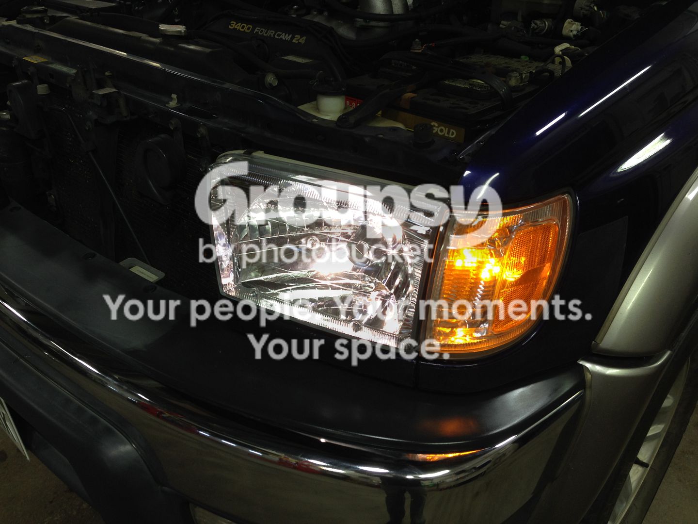

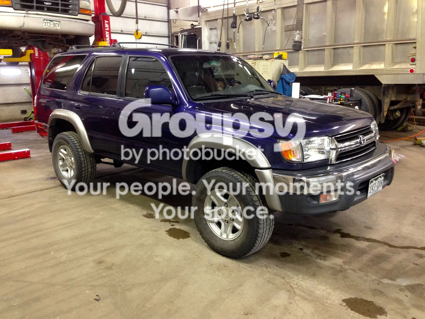

I replaced the headlights with some TYC units, and installed PIAA Extreme White bulbs
And I replaced the grille / emblem

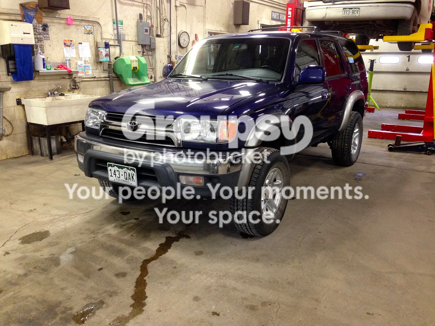

After a couple hours of work

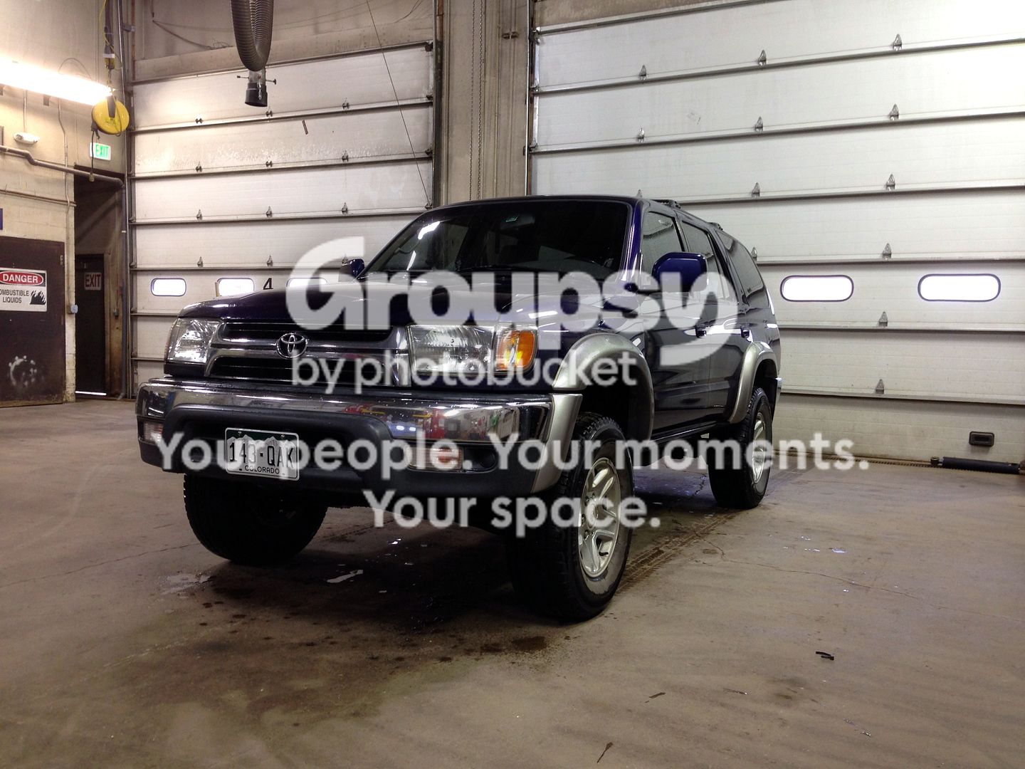

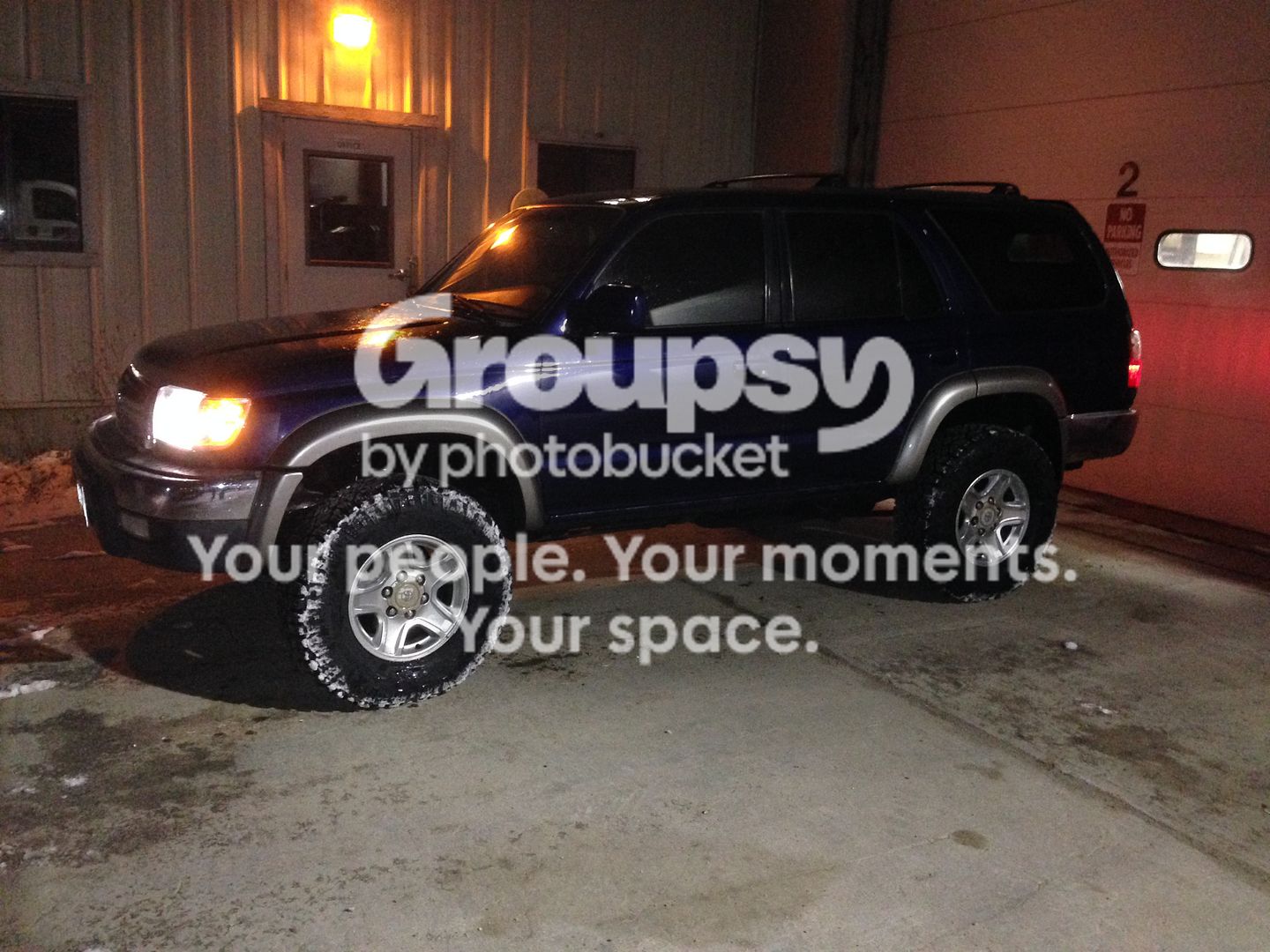

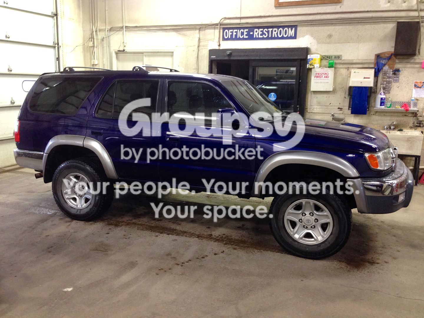

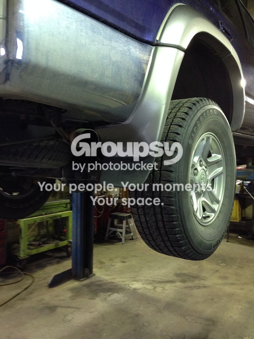

It's been a while since I updated this...
I installed 265/75R16 Goodyear Duratrac's about a month ago. No good pictures, but here is one I snapped right after I installed them. So far the wife really likes them and thinks they do great in the snow.
