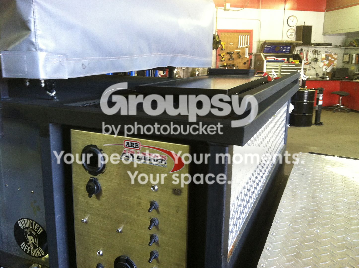

I had a table built into the rear tailgate, but it was something I threw together several years ago and it wasn't very sturdy. I was never happy with the end product, so I removed the table (along with the brackets) and started over.
I figured while I was starting over this would be the perfect spot for a small removable sink.
Progress is going good on the trailer, I'm excited! It doesn't seem significant, but all these little details will change the whole process of camping out of the trailer. Everything has a home and I no longer have to rearrange the trailer several times to get everything to fit; with the slide out everything can stay where it is, no more loading and unloading the trailer to get to that one thing thats in the back.
