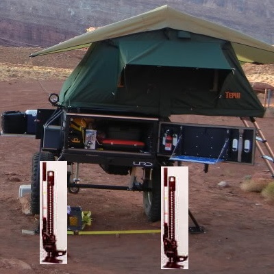

1. if you ever start v2, I bet anyone in this thread would be more than happy to buy your old one :)
2. ever thought about a spare tire mount?
3. looking at the rear ground mounts, couldn't you modify some hi-lift jacks to use as a leveling kit and/or take unsprung weight off the ground?
couldn't you have some mount points on the corner of the trailer to attached the hi-lifts to ?
I think that would be a better solution than using rocks :)
excuse the crappy chop job, I am at work :)
but you get the idea I have behind my previous post, just a thought. maybe not as cheap as rocks though.

hey, my wallet is feeling really thick these days, want to sell me that one so you can build version 2?
1. I'm sure it will happen, it's just a matter of when. I have a bunch of really cool idea's just waiting for the next project. I had planned on pulling the trailer in the garage for the winter and taking care of a few more things I wanted to add, but the 4Runner needed the attention more than the trailer.
2. Yes, I've thought about it. For my personal vehicle/trailer set-up I just don't see the need. I have a spare on the 4Runner that has a matching bolt pattern and is close to the same size.
3. That is a good idea. I had thought about adding crank style trailer jacks in the same spots with pinned drop down legs, basically doing the same thing as your Hi-lift jacks. I decided against because of weight (that's the other reason I don't have an extra spare on the trailer).
Two Hi-lift jacks is pretty close in weight to a roof top tent, same thing with the trailer jacks I was looking at. That Moab picture you posted was one of the first trips out with the trailer, and I didn't choose a very good spot. Normally it only takes one or two 2x4's to level the trailer. I can't justify that much extra weight when there is other options. :)
