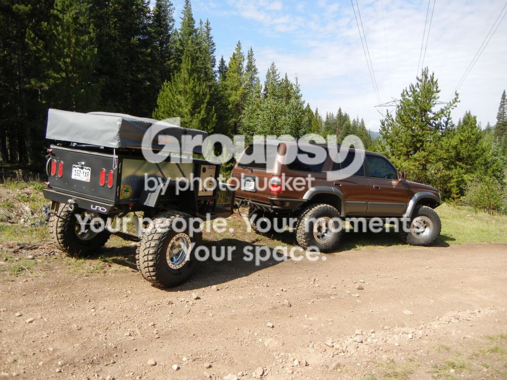

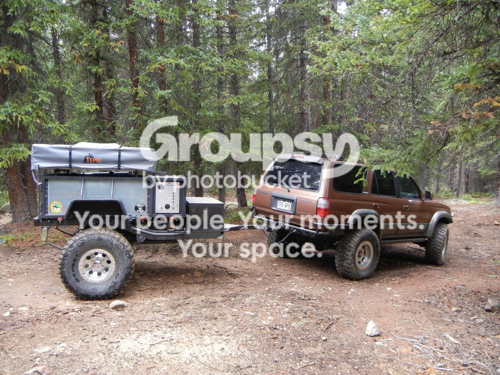

And here are a couple pictures of it out on the trail :)
DSCN1557.jpg~original
DSCN1545.jpg~original
DSCN1560.jpg~original
DSCN1542.jpg~original
DSCN1568.jpg~original

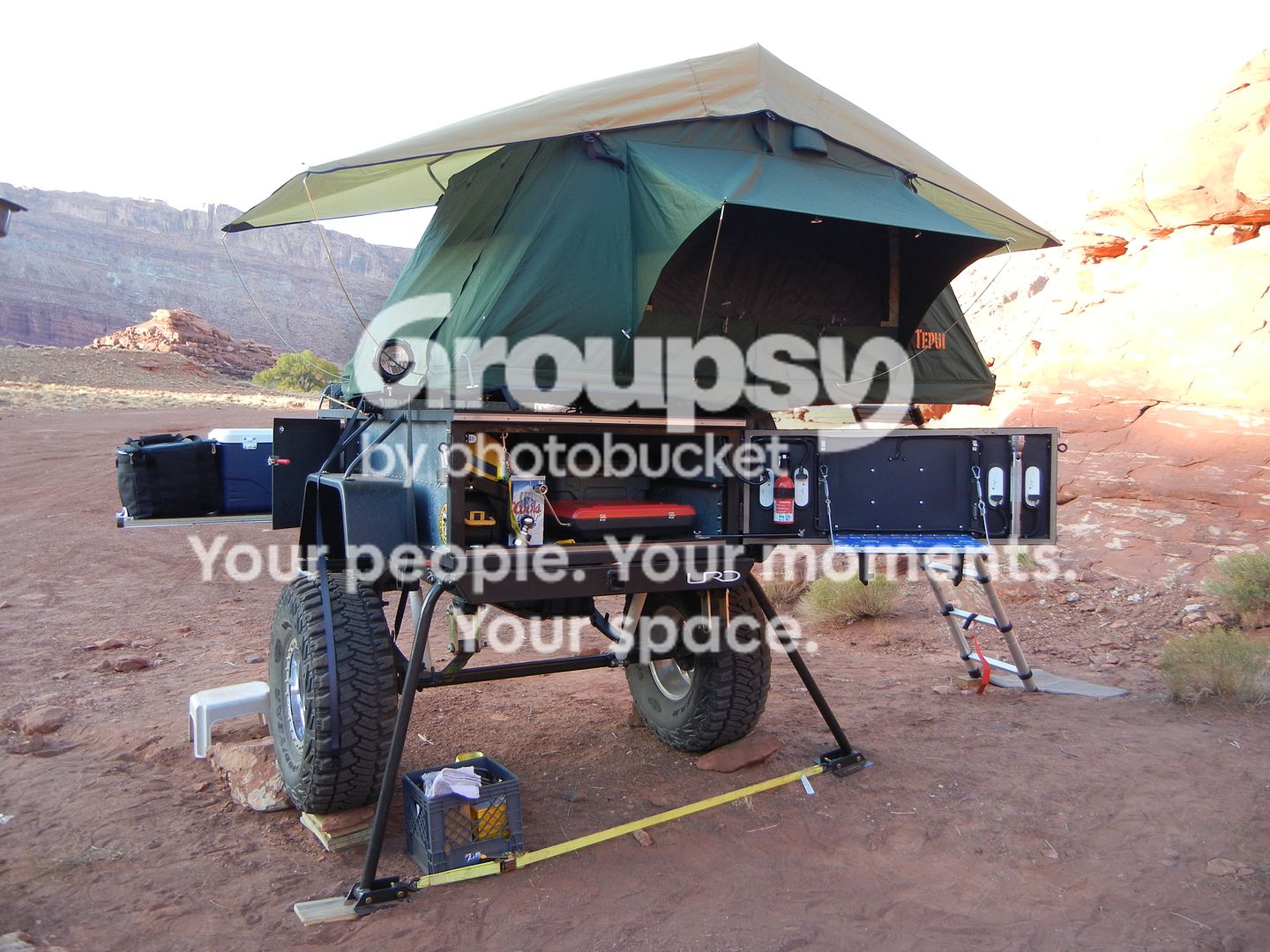

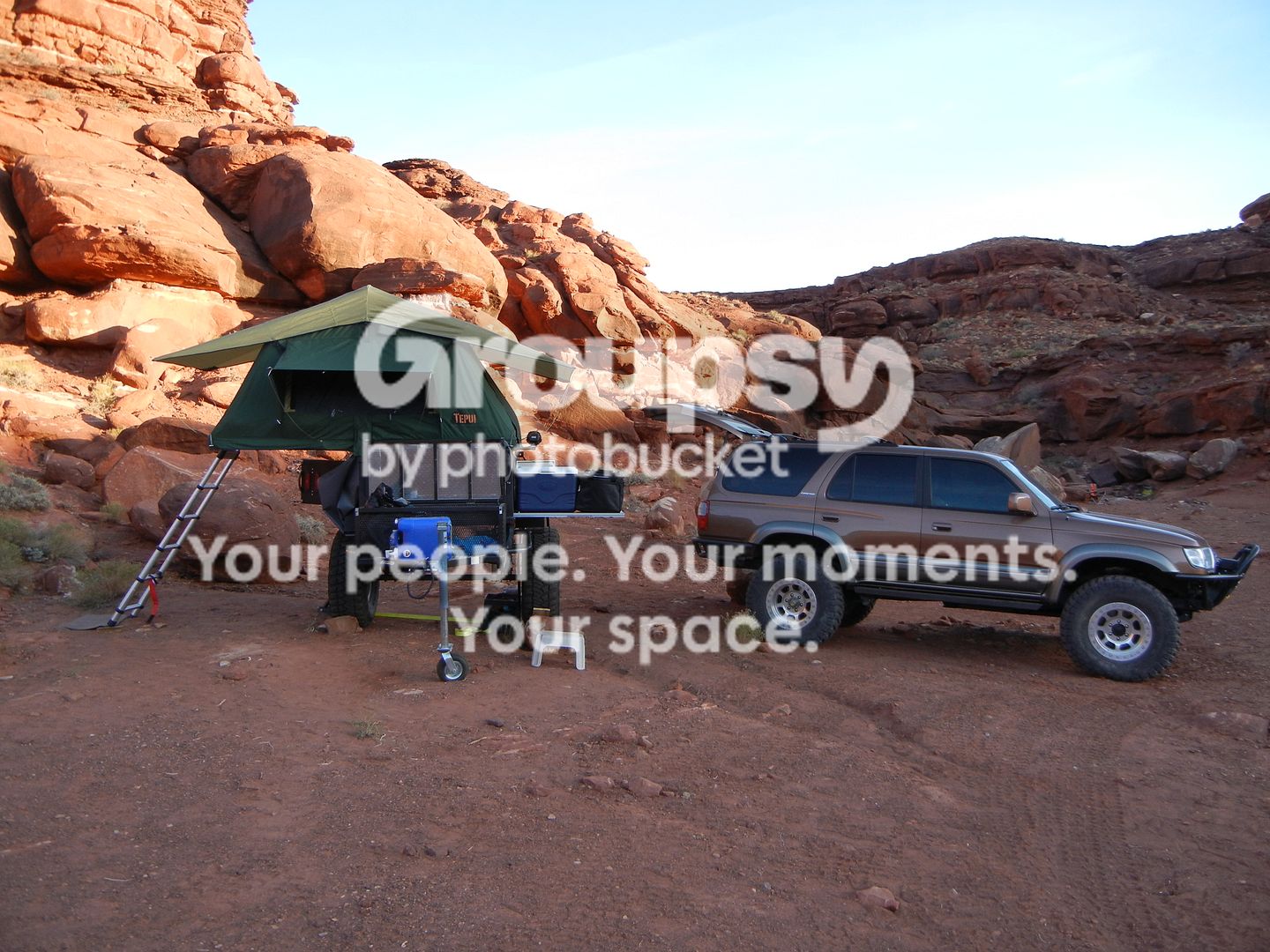

Here's some pictures of the tent and trailer set up in Moab. The trailer does not normally set so tall, I stacked rocks/wood to level it and the stabilizer bars unweight the suspension which makes it taller.
DSCN1632.jpg~original
DSCN1635.jpg~original
DSCN1633.jpg~original

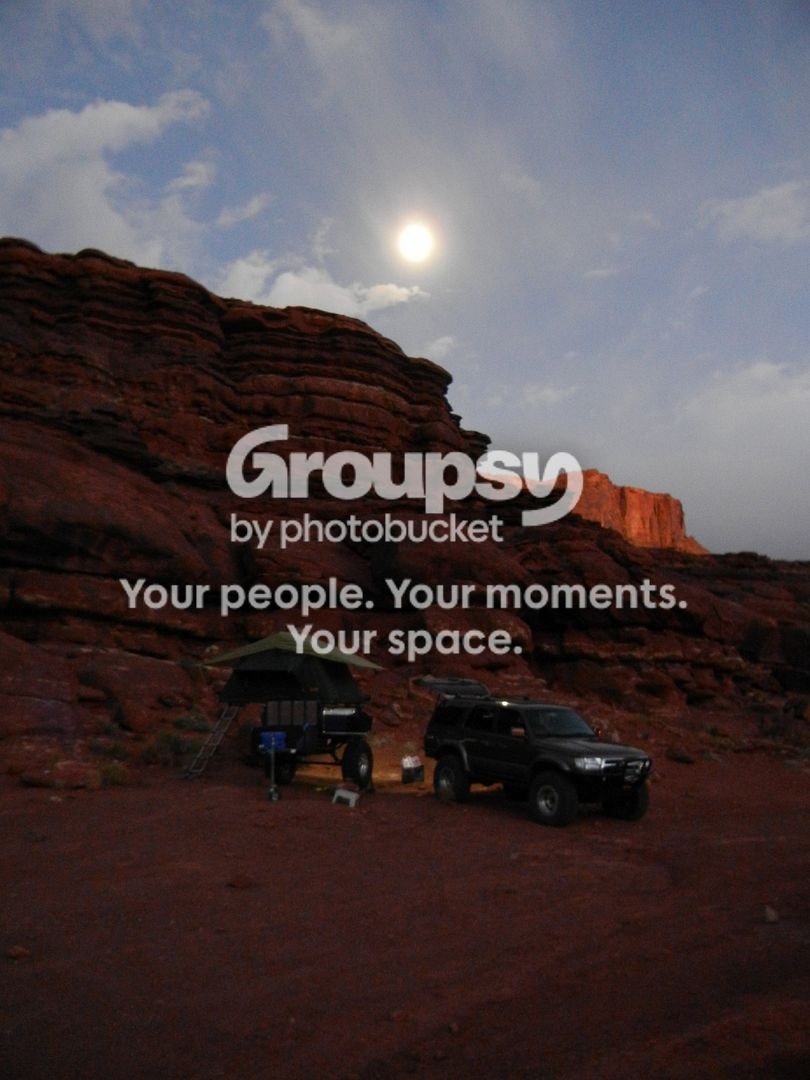

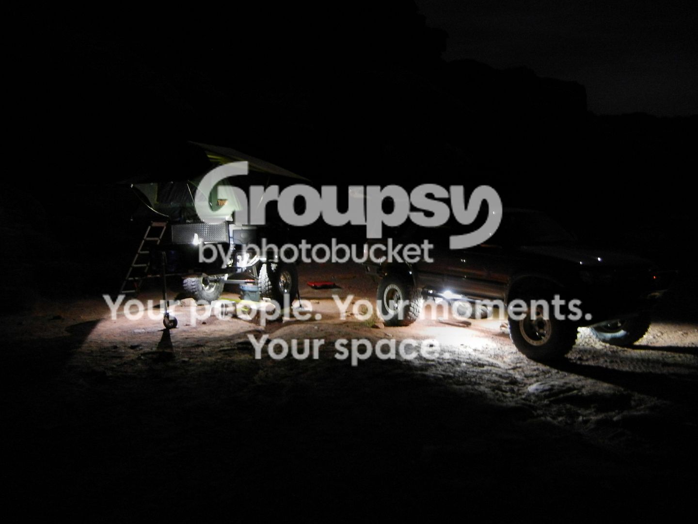

And some night shots :D
DSCN1624.jpg~original
DSCN1660.jpg~original
DSCN1662.jpg~original
