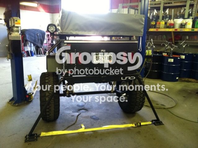

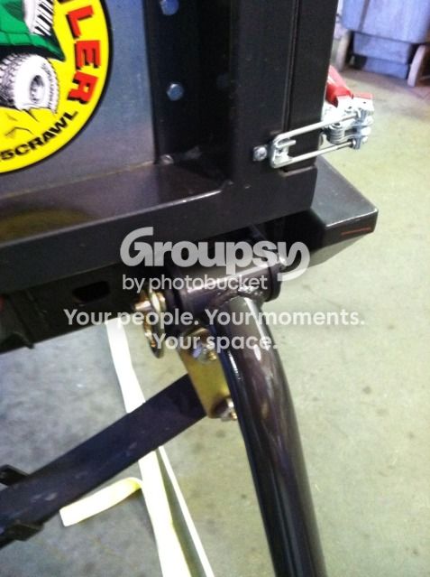

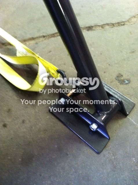

After I installed the RTT I noticed the trailer moved around a lot more than I liked; both getting up into the tent, and moving around inside the tent, it was all a little “sketchy”. So I built some stabilizer bars (kind of like the out riggers on a back hoe) that unweight the rear of the trailer suspension, and plant it down where it sets.
They worked great! But, they took up valuable room inside the cargo area and beat the crap out of all the camping gear inside. I had planned on mounting them outside the trailer last season but I ran out of time. This was one of those things that really needed to be taken care of before I took the trailer back out.
First strut in place
Both in place

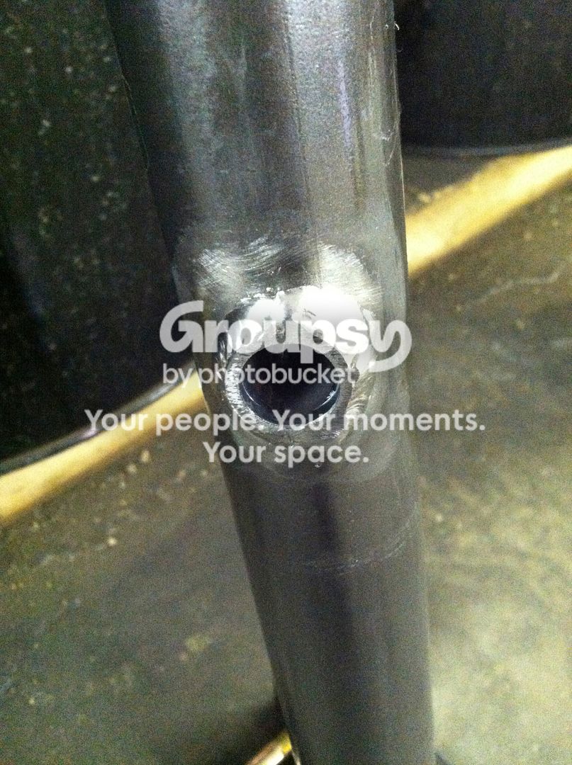

The struts have welded inserts for a tight fit, and to keep water out of them.

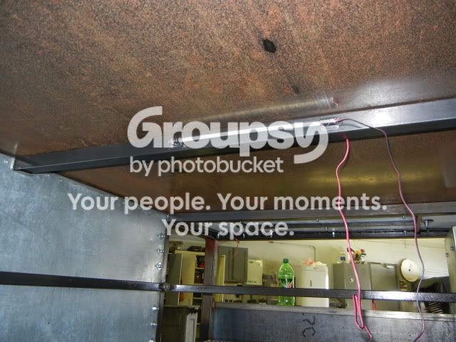

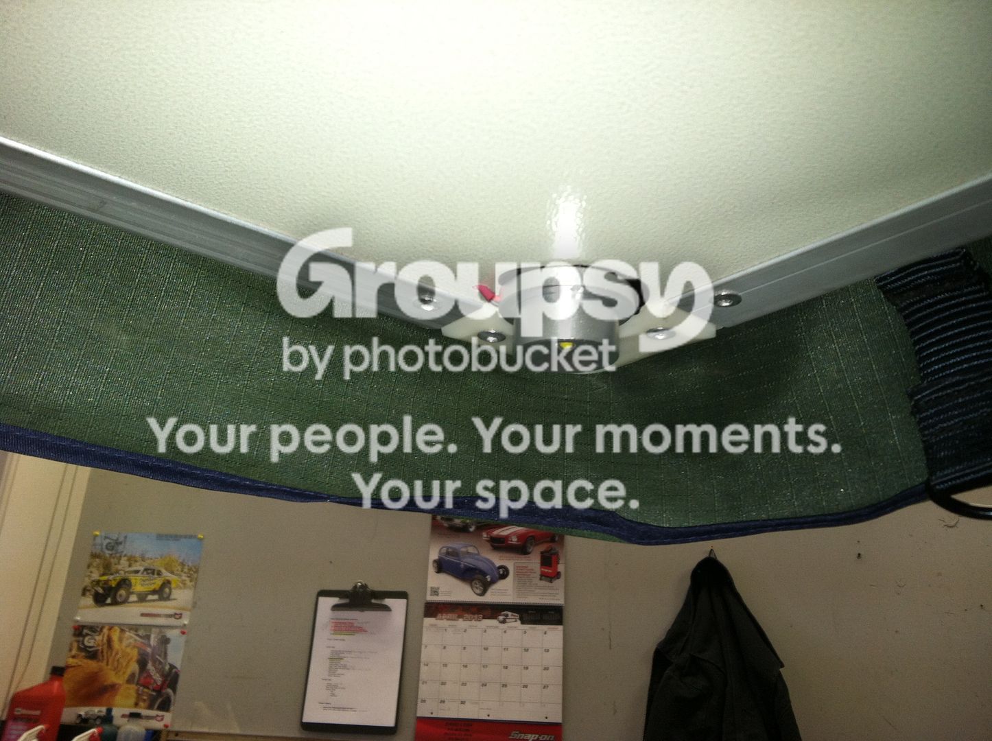

I have LED lights mounted inside the storage area for setting up camp when it's dark. I installed two lights on the center roof support, one on each side. The light output was great, but the light that faced the door was too bright and would blind me while using it. I decided to move it back behind the door so I did not have a direct view of the lights, just the output.
Before
After
