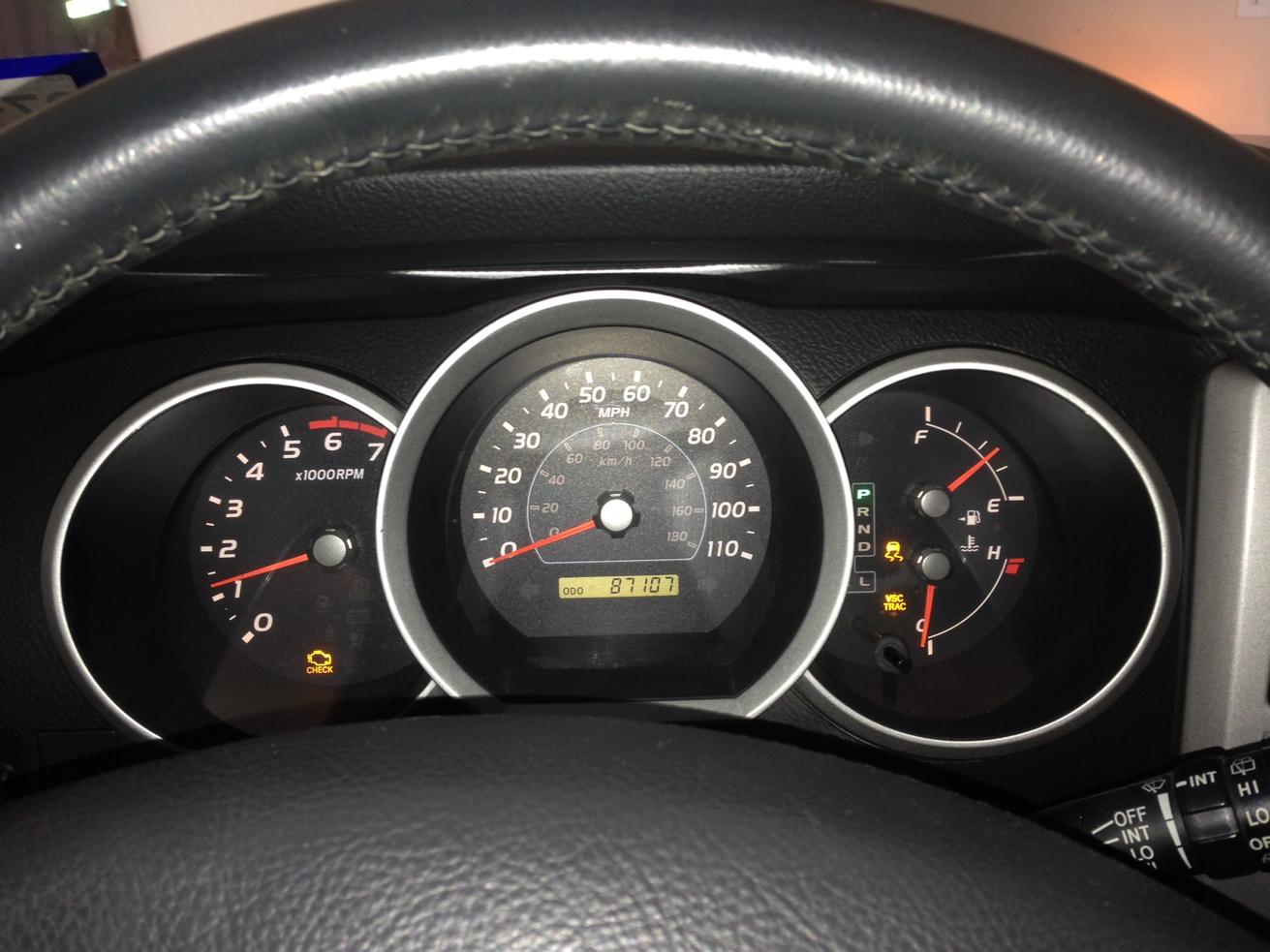

I have a problem where my Check Engine, VSC Trac, and squiggly light come on shortly after starting my 4Runner.
I cannot afford to have this fixed whatever the problem is - and there is no apparent problem. The car drives fine.
I need to get a Texas inspection sticker in a few months and they will not issue them if the Check Engine light is on. Anyone know how difficult it is to remove the instrument panel so that I can remove the light bulb? Is there an easier way to get these lights to turn off?

The "fix" you're describing won't work. In order to pass inspection the CEL has to come on when they turn the key on, then it has to go away when they start the vehicle.
If you unplug the CEL or remove bulb or if bulb is just burned out it will fail inspection due to faulty CEL.
Go to Auto-Zone and get the code pulled. Chances are it's not as expensive of a fix as you are assuming. I'd be willing to bet a new gas cap would take care of it. Surely, you can swing $20.

Texas will fail your inspection if the battery has been disconnected prior to inspection. They will tell you to drive 50-100 miles and come back (This allows all of the T4R's systems to run their system tests and self diagnostics, of which your CEL lights will probably come back on). I would wait for the lights to come back on and go to AutoZone and get the code pulled for free, heck my local Toyota dealer reads them for free as well. As mentioned before it is probably the gas cap. Be sure and get a genuine OEM Toyota gas cap as aftermarket ones tend to cause problems. This happened to me in both my 3rd gen and 4th gen T4Rs, replaced the gas cap drove for a few days and the lights never came back on. $20.

The last time my CEL came on with the VSC and TRAC, I pulled the codes from AutoZone and read the manual regarding the VSC and TRAC lights coming on. The codes from AutoZone had nothing to do with the VSC and TRAC lights, so I called the dealership.
They said that when the CEL is on, the other two will come on. "Some people never see the check engine light come on, so Toyota made it that all three lights turn on."
So having three lights is not a bad thing, just more warnings to get your attention.

Wouldn't ya know it, several hours after making that post the damn lights went back on.
PO430 was the code - not good. No gas cap is going to fix that. $1,100 and a new exhaust manifold/cat later and the lights are off. At least now I can get my inspection sticker. :frusty:
