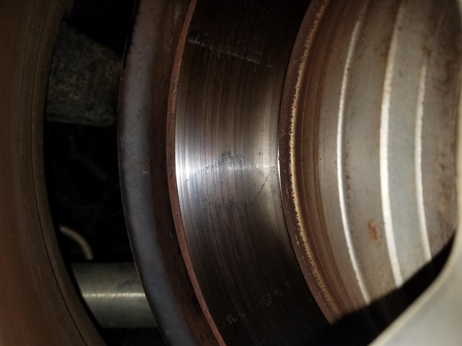

This is a picture of the discoloration i was talking about. Is this glazing?
Hit the rotor with the IR gun when i got home. It is 15-20 degrees hotter than the others. Damn!!!

In your photo the whole rotor surface looks like it's been overheated to me, it appears to have a blue/black coloration to it,
if it does then the rotor needs to be replaced, I suspect you have a sticking caliper there, if it's just the pad to caliper
contact/sliding area and or pins causing it to stick then replacing the pads and lubing with the proper silicone brake grease should
save you from having the also replace the caliper as well, it's more important to lube the area where the pads contact/slide on
the rotor than it is to lube the pins since the pins fit loosely on the pads, but a little coating on the pins is not a bad idea to help
keep down on corrsion on the pins.

Thanks, pads and hardware are going to be replaced tomorrow morning. Hopefully, the rotor can wait till after christmas. I notice that discoloration now that you point it out. Im still new to wrenching, so i appreciate the lesson. Thanks again.
