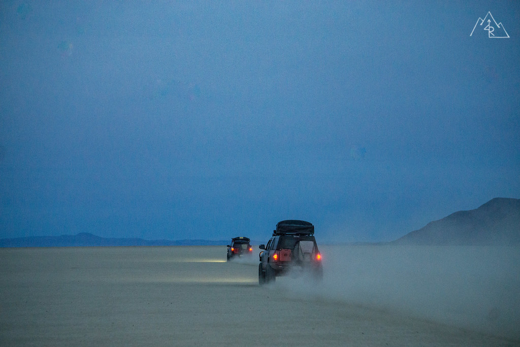

55mph is the maximum engagement speed recommended. Once engaged, you're good to go. Earlier this year I held steady 70+ mph in 4HI crossing the Black Rock Playa for about 35 miles because it had rained about 4 days before we got there. Going slow was not an option.
