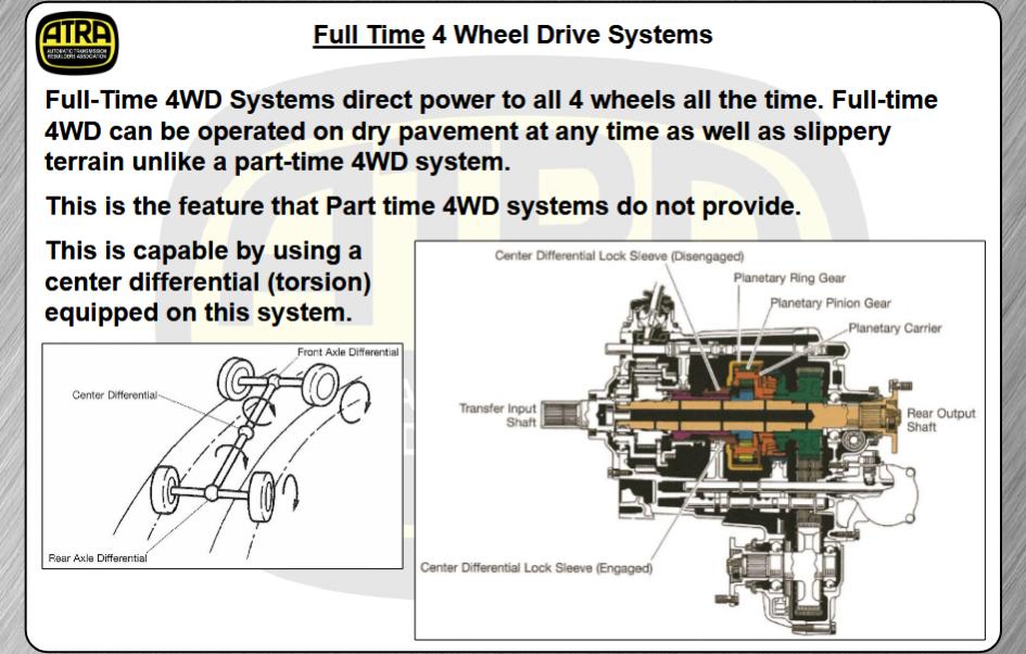

Yes, the center differential is integral to the Full-Time 4WD transfer case.
Here's a cross-section of a Full-Time 4WD transfer case such as is used in the 5th gen Limited 4Runner:
  • Screenshot 2023-02-17 at 10-50-42 Toyota 4x4 Webinar Handout - toyota_4x4.pdf.jpg

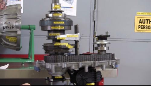

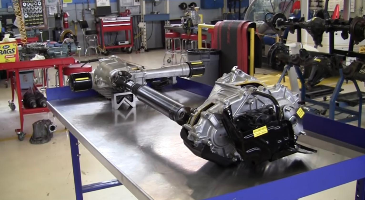

Here are some other videos related to Toyota transfer cases. They don’t address the center differential (but that was addressed in the video I linked to above) but they provide a crystal clear understanding of what’s going on in the transfer case.
This first video shows all the internal components of the t-case working together.
VIDEO LINK
This second video shows the internal components working in a cut-a-way case, with a front propeller shaft and a cut-a-way front differential. The workings of the ADD are also explained.
VIDEO LINK
