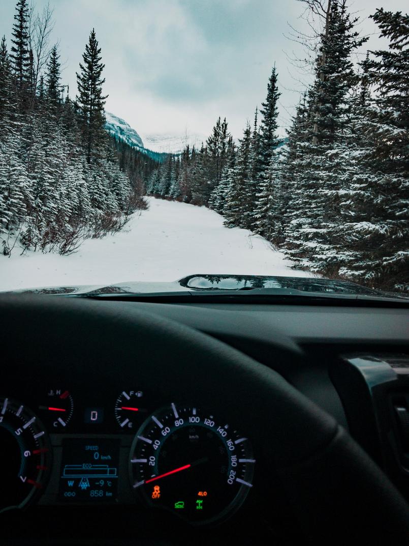

I had mine in 4hi for days on the trans Labrador trail, and again last winter during a blizzard that lasted for days. I use it whenever I want, and I will be happy to replace parts if required.
