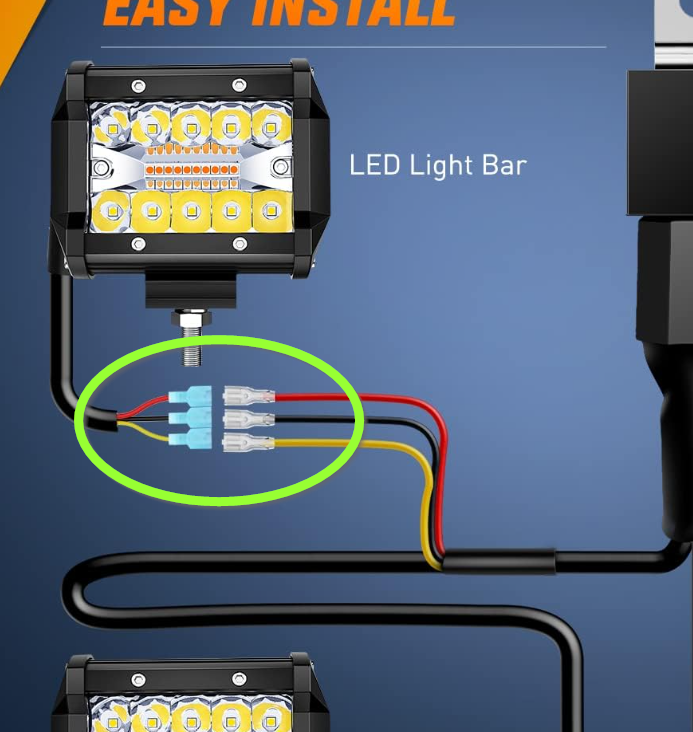

I'm installing a set of ditch lights for my T4R - mounted on the corners of the hood near the side mirrors.
Unfortunately I don't live in the nicest part of the country, so they will be easy prime targets for theft whenever I'm parked on city streets.
So I'm trying to come up with a easy quick disconnect mechanism. By default, they already use spade connectors (3 wire per light) which by their nature is quick-disconnect:
But these are not meant for frequent connect & disconnects.
Is there some out-of-the-box solution for an intermediary connector that I can connect these to, so I can disconnect in one pull, instead of the 3 dainty connectors? Or some DIY solution?

You'll just need a 3 pin connector kit from amazon or ebay. Search '3 pin weatherpack connector kit'.
You'll either have to crimp the connector pins onto the wire or could find some with leads already on the pins, just would need to connect wire to wire with a butt connector or solder and heatshrink.
Thanks for pointing me in the right direction! Found this kit and it should do the trick.
