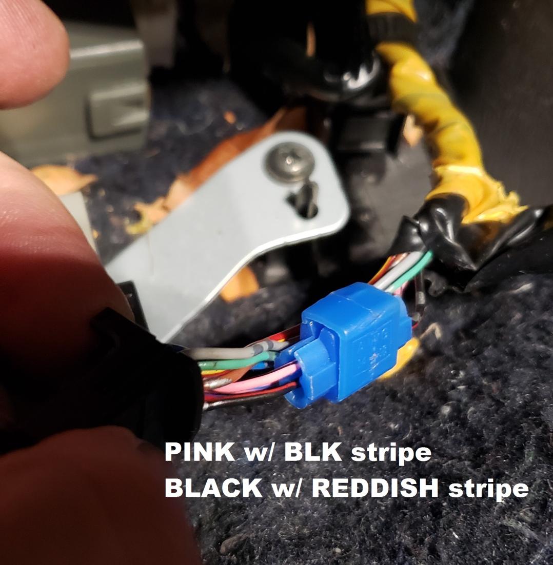

I looked up the wiring, and from everything I read, in my 2008, the correct procedure was to open up the panel, then locate the:
PINK w BLACK stripe wire
BLACK w REDDISH stripe wire
and then use a locking type connector.
I did so, as you can see in the attached photo.
I did that today, this morning.
When I first did it, SUCCESS. The light was gone, I ran the car for 30 seconds to make sure, all was good.
Then I went to run errands this evening, and the light is back. I opened up the panel in the store parking lot, checked everything, seems to be connected, nothing popped out etc
Did I do something wrong? Wrong colours? (I know that the colours are different in the pre 06's, but everyone with an 07-09 said it was the colours that I used)
I want to say that it is the "aftermarket" (non-3M) connector, not splicing through the wire casing, but..... why would it have worked the first time I ran the car after doing it?
Any pointers would be appreciated, things like this drive me insane. It should have worked.
I hope there is an easy solution!
Thanks again!

I bet you it's just the connector. Those really suck. I just jumped the PIN in the harness.
Gotcha, noted. So just a matter of physically connecting them, rather than relying on a crappy connector.
I did want to confirm, those ARE THE CORRECT coloured wires for my 2008, though, right?
I am supposed to be connecting those to one another.
That's actually the wrong colors too. It's PINK-BLACK (TPMS) and WHITE-BLACK (Ground). You're basically grounding out the TMPS wire.

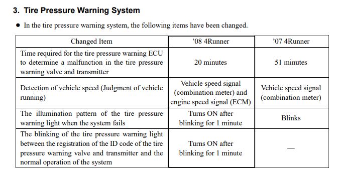

You are correct that the 2008-2009 models had a TPMS change (see attached).
These models also do not have the Ground wire (White-Black) at #11. Rather, I believe, they have the Ground wire at #9 and it is solid Brown.
Although I have not confirmed this, I would try to connect your Pink-Black wire at the #5 position (was #6 in 2003-2007) to this Brown #9 Ground wire.
I think youve got the wires correct to jump.
Ive had issues with those splicers before too. Id carefully open it up. Make sure the wire covering have a nick so you can see copper. really wedge the wires down into the metal bridge so they both have good contact with it. you may want to put some electrical tape in too to hold the wires down, then lock it back up

This also seems to be my suspicion. The connector doesn't look like it would really cut through the casing well. I am curious if maybe I needed either the "smaller size down" one (this was the 14 to 18ga), or .... assuming I have the correct wires, I just splice in and manually connect them
I am 99.9999 % I have the right coloured wires, but man... it should be working then!
