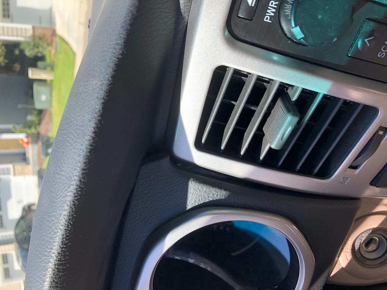

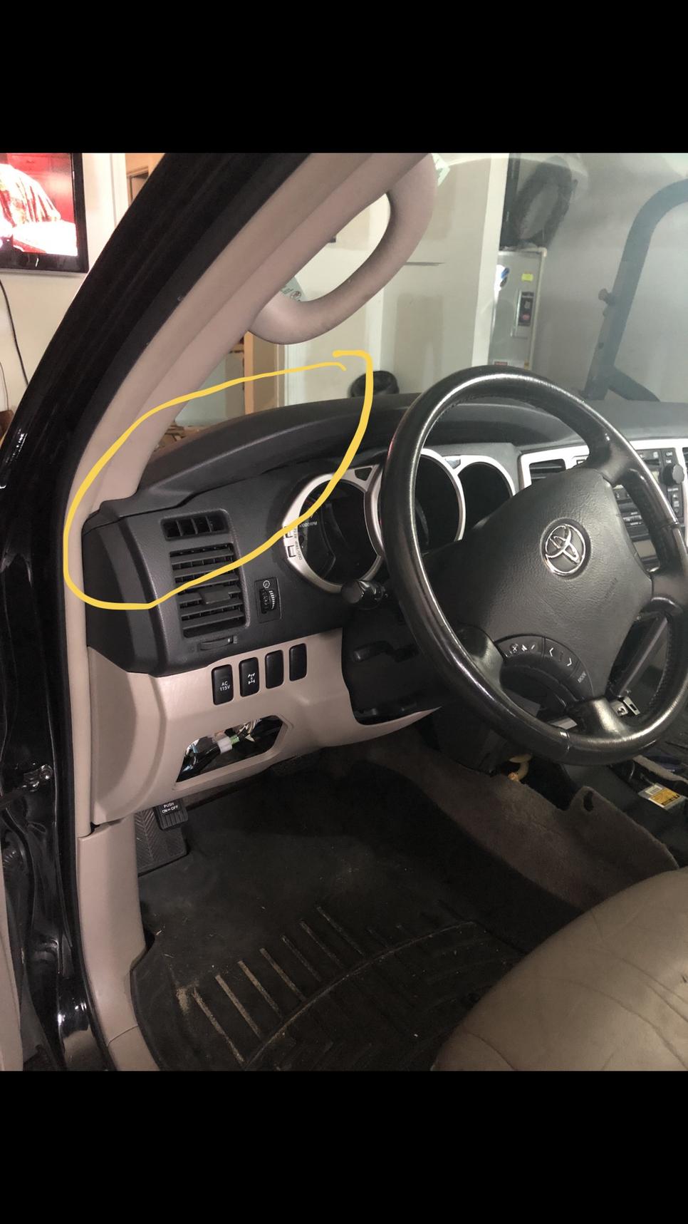

Here is what I Have now-
A 2003 Limited V8 4x4 with
-2003 Limited V8 4x4 Instrument Cluster
-2003 Limited V8 4x4 Instrument cluster Bezel
-A dash from a 2007 SR5 4x4 V6
The problem is although the Instrument cluster stayed the same size and shape. The Instrument Cluster Bezel did not. If you look at the top left part of it you can see the slight change. (Pictures are not of parts I have. they Are screen shots from online)
So with the install right now I have the entire 07 dash in. And I have the 03 instrument cluster mounted and working fine. And I was able to get the 03 instrument cluster bezel in, but not flush. The clips on the back are different as well and the shape being different.
Options I see myself having moving forward.
1- Find a 06+ instrument cluster and instrument cluster bezel to fit. That will involve figuring out the wiring harness and rewiring the pins to accommodate the blinkers and trip reset.
2. Find a way to alter the 07 dash slightly to fit the 03 instrument cluster and instrument cluster bezel.
3. Keep the 03 instrument cluster and just get a 06+ instrument cluster bezel (will involve moving trip reset buttons and finding a creative way that does not look cheap to do the blinkers.)
What do you mean by not flush? Did the overall bezel fit and not flush on the plastic cluster cover?
Maybe the picture will help.
The Bezels are different shape and will not go in flush.
This is the only picture I have currently while at work. I can take more this evening.
It looks even worse from the passenger side view.

Oh wow, that would bother me to no end. The dash is nice and clean so don't give up on it just yet. A dremel here and there on the mounting points could do you some good to get that dash in nice and flush.
Absolutely! It will be getting fixed. And definitely don’t want to give up on the dash. Taking it slow and exploring all options. Want to have it look OEM when all is said and done. Don’t want to take a dremel to the dash unless I have too and know it can be hidden.

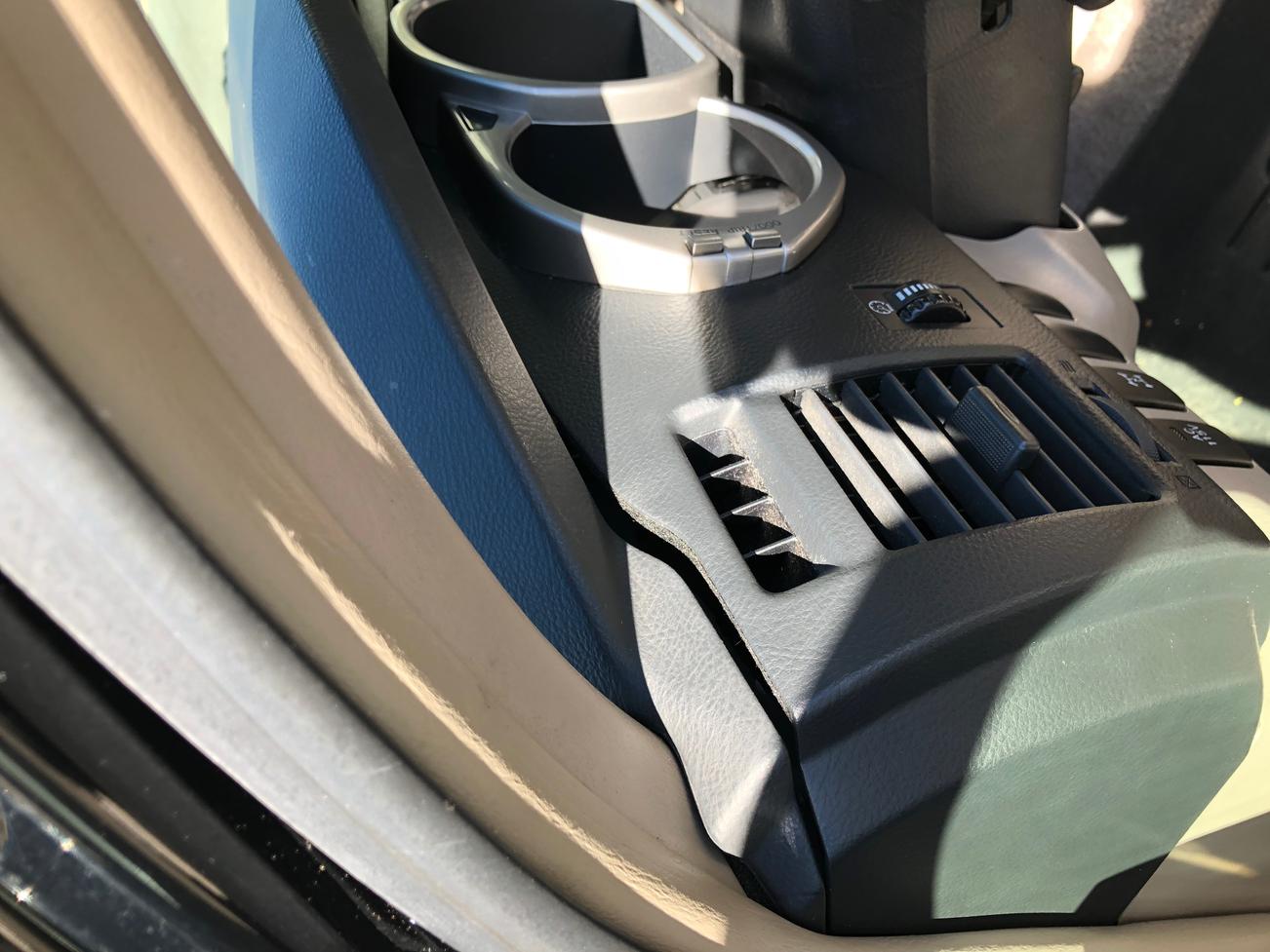

More pictures

just trim the instrument cluster bezel to fit for now. look like the whole top needs to be trimmed down. measure from the kick panel up to the dash and trim slowly. if you ruin it you have to get a 06 up instrument cluster bezel anyways and have something to use for now. if that was my rig i would end up buying the trim and cluster but waiting till i can get it at junkyard pricing.
it looks like you have the time and you just need to decide how much you want to spend. Your option one is the most pricey, #2 is insane and #3 is cost effective
Solid advice. I will work on trimming and moving the brackets on the one I have now for a temp fix until I can find a cheap 05+ bezel.
I like plan 3 and I am willing to wait for one to pop up in a junk yard. The trip buttons will be easy to move to the kick panel. I am still struggling with how to do the blinkers and not have it look like trash aftermarket crap.
That is the main difference with plan 1 and 3. Where do I put the blinkers with plan 3?
