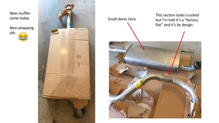

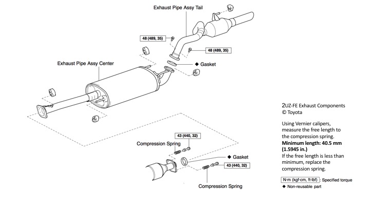

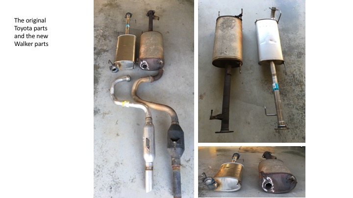

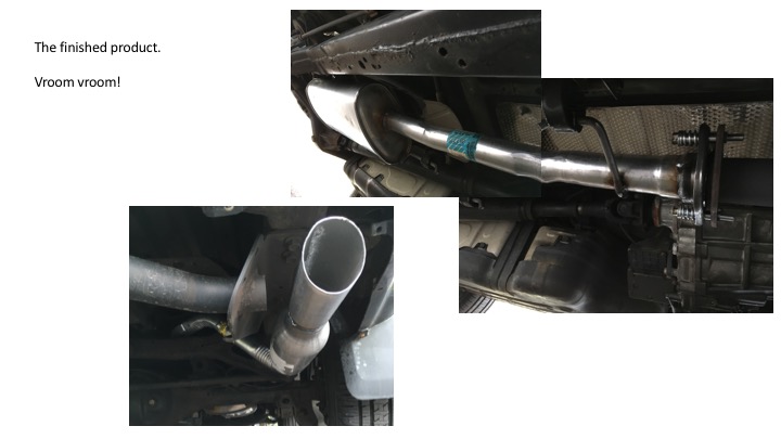

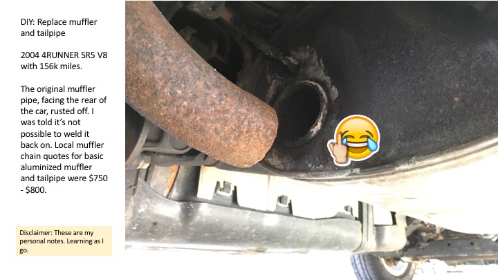

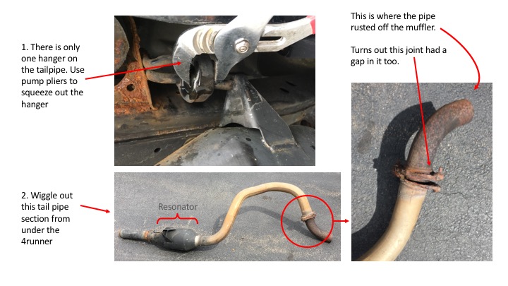

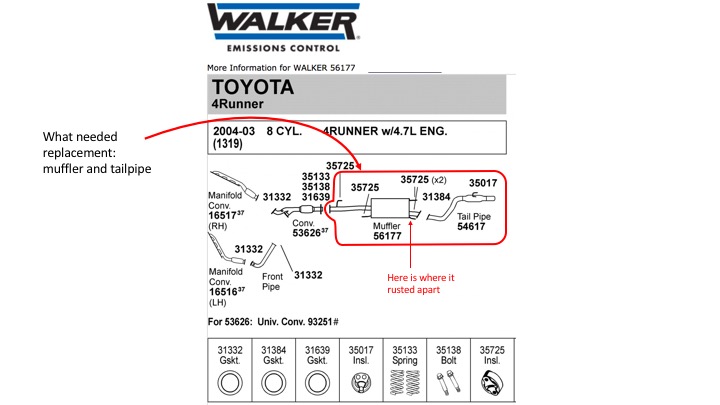

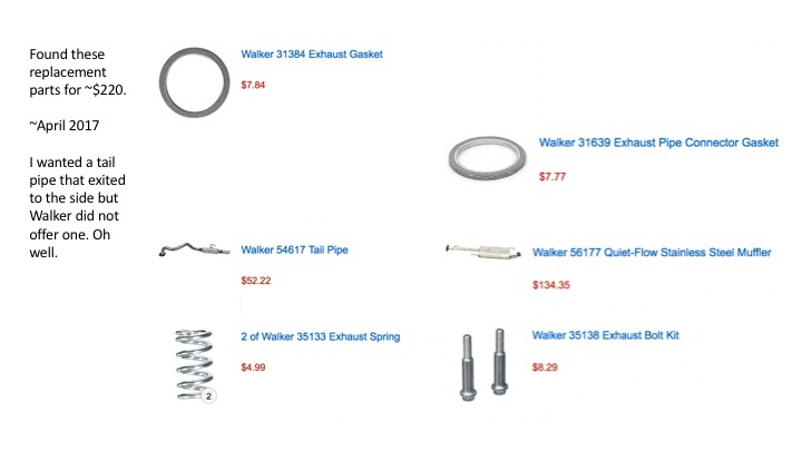

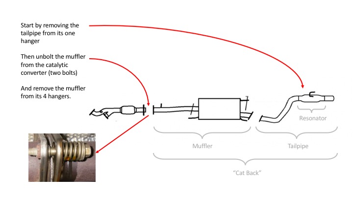

DIY Replacing muffler and tail pipe. 2004 4RUNNER SR5 V8 with 156k miles. I had a bunch of links saved talking about Borla and Magnaflow etc. But when it came time, practicality (Walker) won out :(
to be continued below...

1. Rusted bolts would be the only regret. Be ready with drill outs.

Just holds the exhaust together, nothing bolted to the undercarriage. On my 3rd-gen I cut the bolts off with a sawzall,went through several blades in the process. I replaced everything but the tailpipe (was still in good condition) with Walker components, the two cats plus muffler, it's been over two years so far.

So let me ask you this - if my primary concern is rust and overall durability, couldn't I just buy the Walker catback at an economy price and just hose it down with hi-temp rustoleum? Otherwise, I would probably just go with the basic Gibson stainless (#618815). Do cheap exhaust systems perforate/break/etc more readily, or are they less expensive because of performance & noise issues (which I don't really care about - it's a 200K-mile grocery getter)?

You should be alright actually. Luckily there's only two bolts to remove, the two at the converter flange/muffler inlet, I wouldn't even worry about saving them and just let them break off if it happens. You're not saving the muffler anyway so you won't have to drill anything.
That's what I did; sprayed the components with some high-temp engine paint from a previous project, let dry overnight, then installed. OEM replacement systems are less expensive because they're just cheaper to manufacture (mild steel instead of aluminized or stainless, crush-bent pipes, mufflers crimped together instead of welded) the cheaper manufacturing also make it less durable. I'm cleaning my 3rd-gen's interior at the moment, I'll take a look underneath to see how the Walker parts are fairing.

Ben, if you have an '06 I'd guess it's the original muffler. If so, I don't think PB Blaster will save you. As others have said the bolts connecting to the cat will need to be replaced anyway, so you can saw those out, but (don't recall all the details) I also had to drill them out in addition to using a wheel cutter to saw them. Caution: those compression springs will decompress and shoot off when you cut off the bolts.
Painting the new muffler with high temp paint can help its durability. I've been meaning to do so. And jack up the car if you can because you'll need the room to work under there. If you're unsure, you can always take the parts to a local mechanic, and pay for an hour of labor.

The walker system cat back to tail pipe is stainless but the tail pipe is steel. about $225.00 the Gibson kit can be had for 375 delivered well worth the extra cost.
