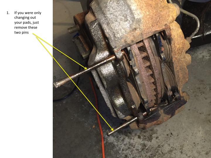

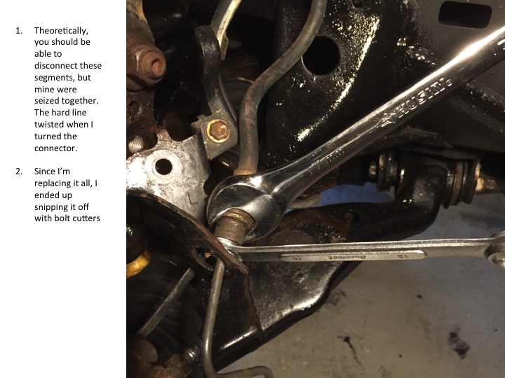

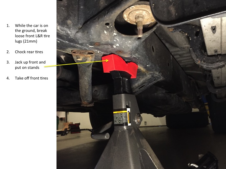

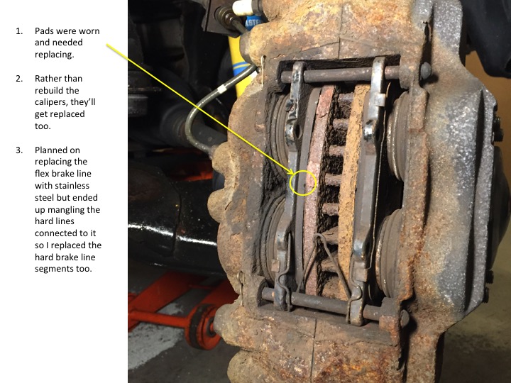

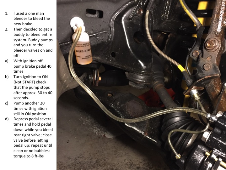

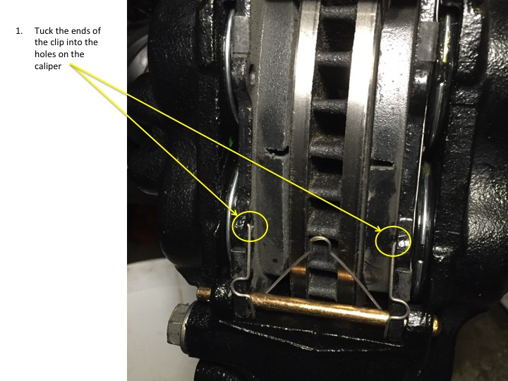

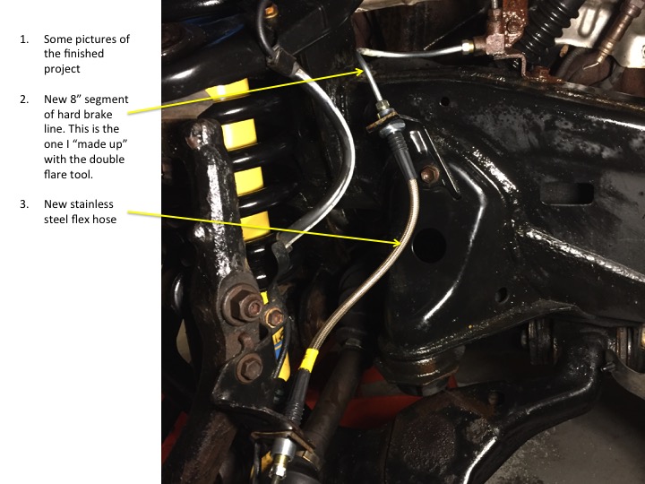

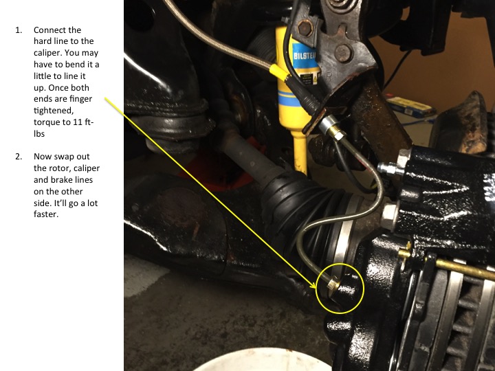

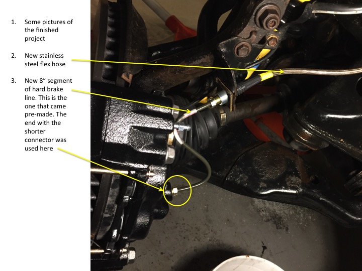

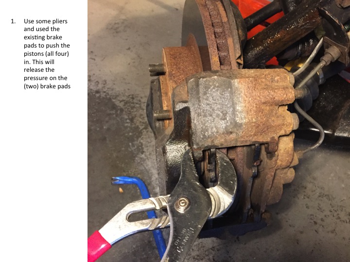

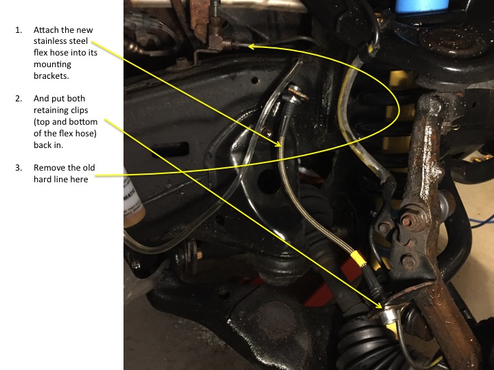

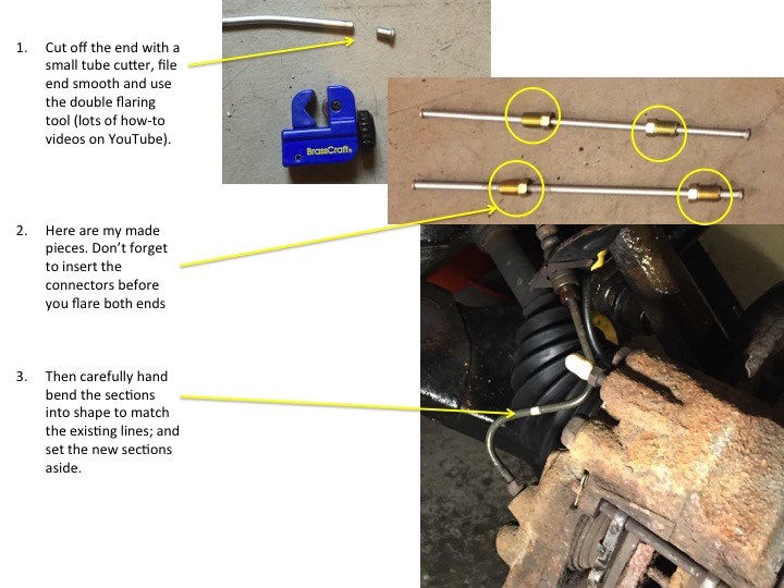

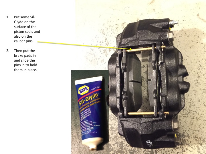

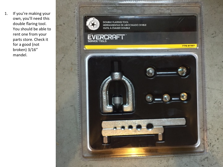

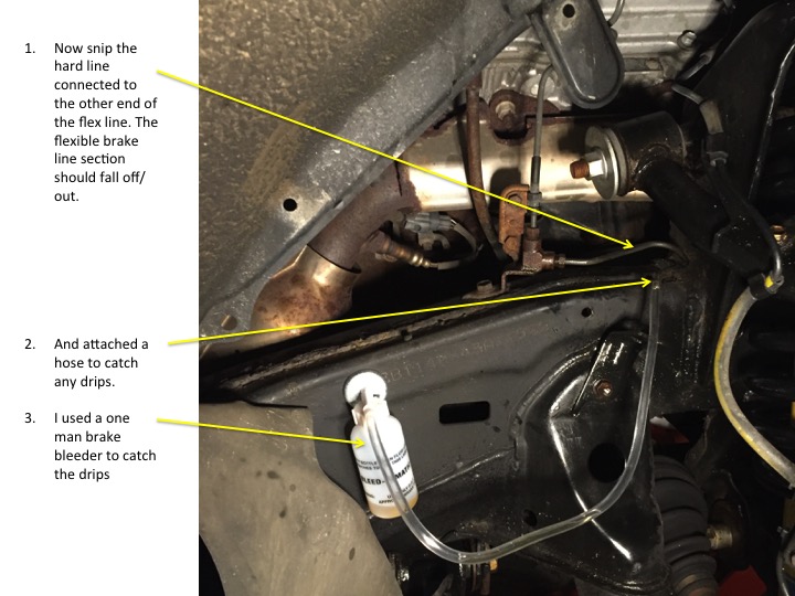

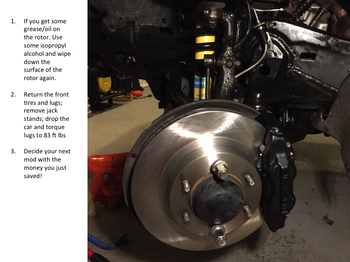

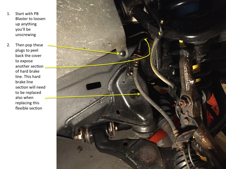

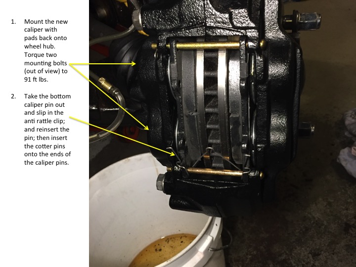

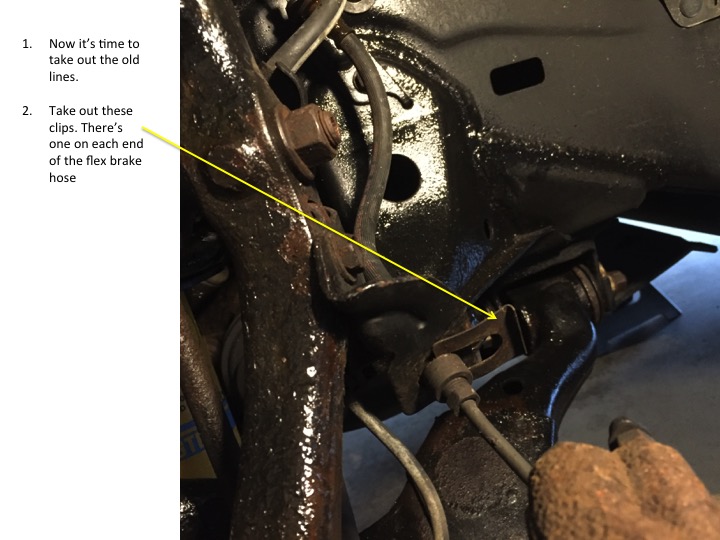

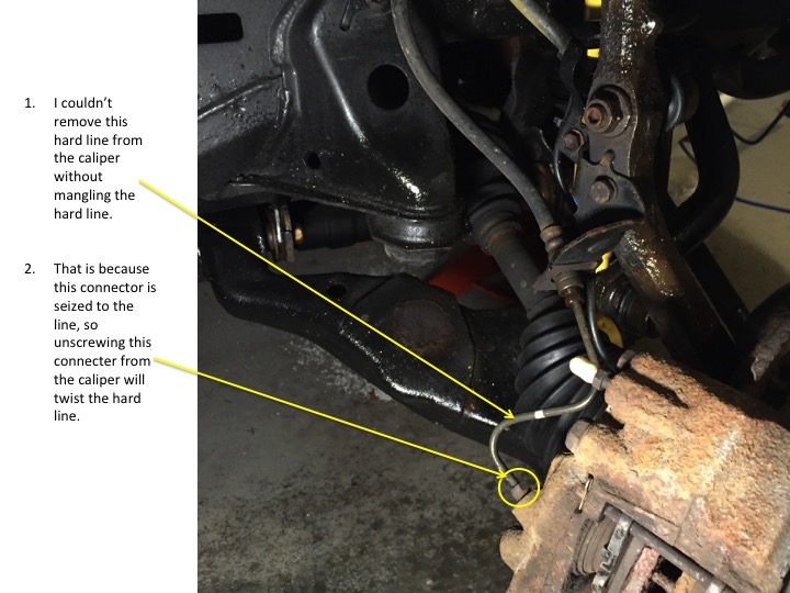

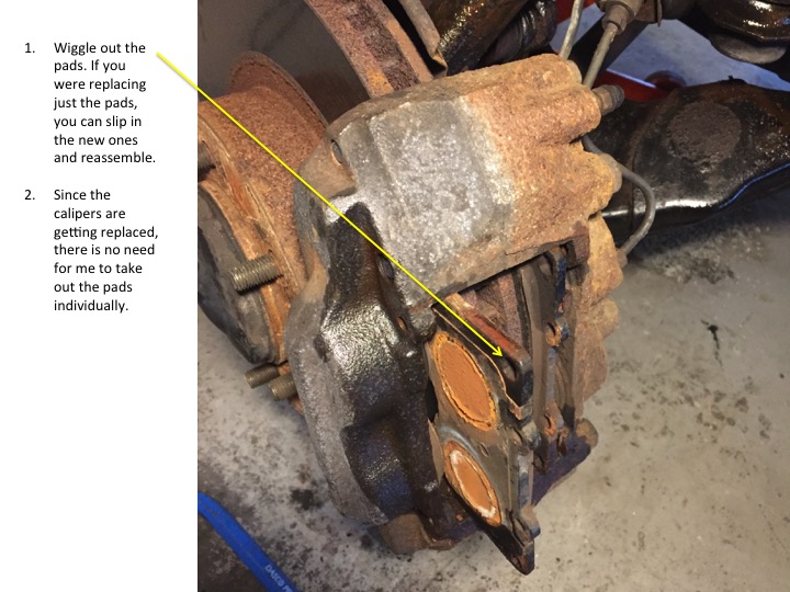

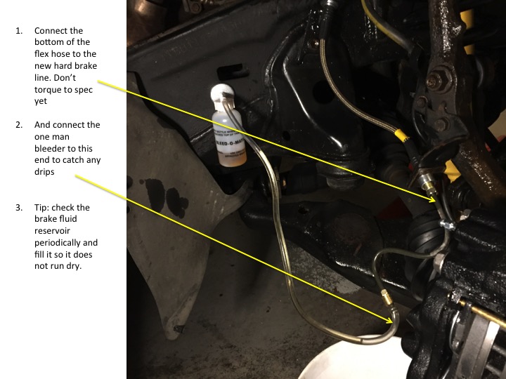

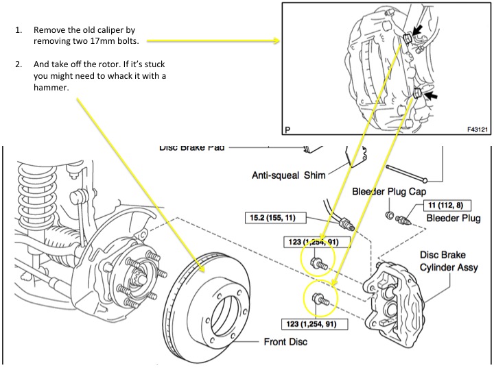

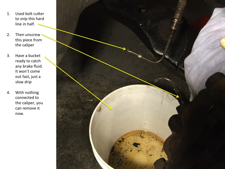

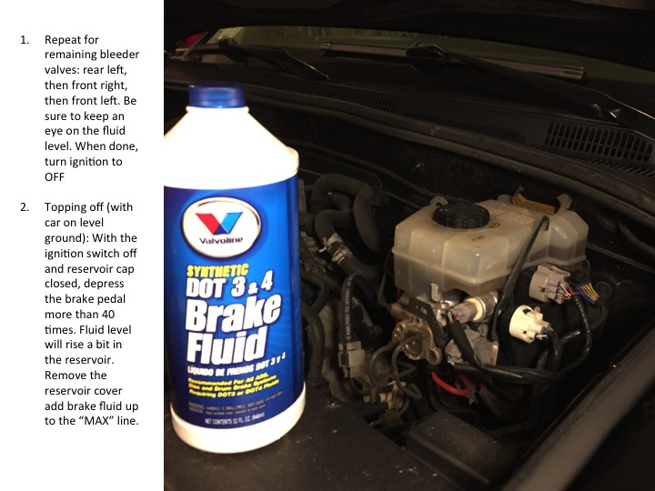

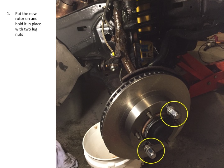

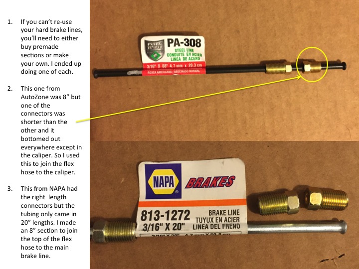

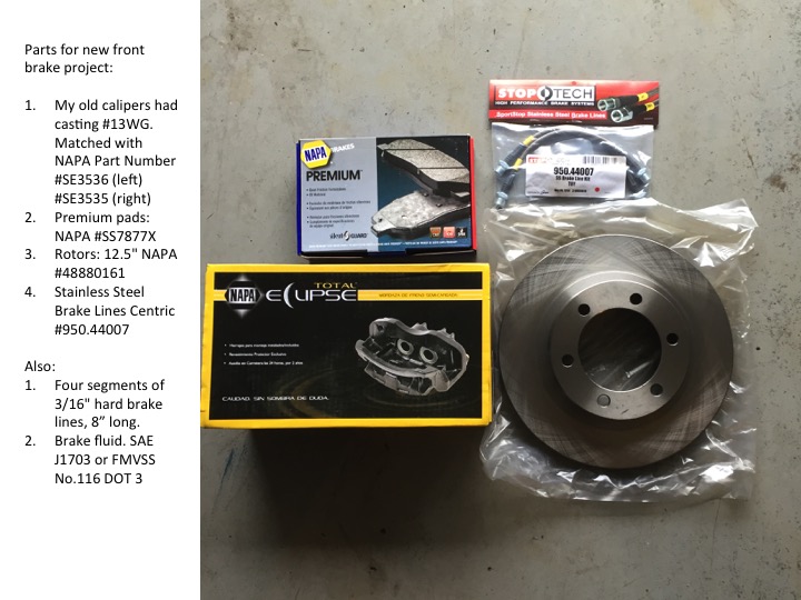

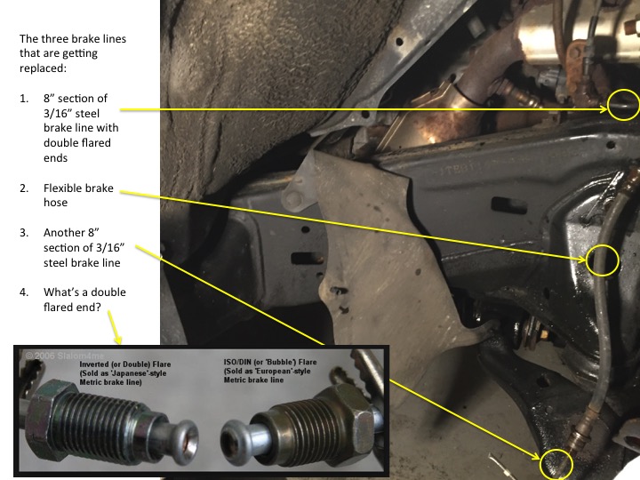

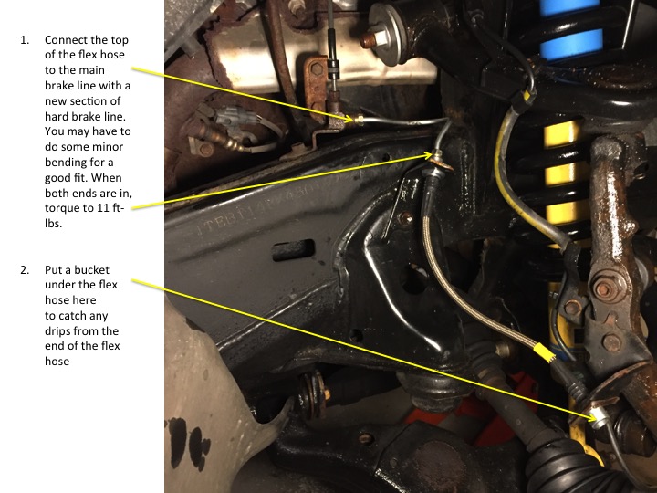

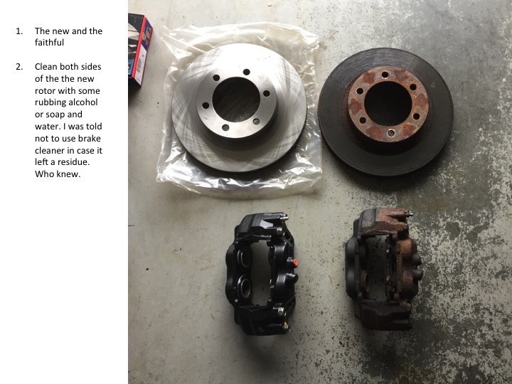

Replaced the front brakes (calipers, pads, lines, rotors) on my 4th Gen 2004 Toyota 4Runner SR5 V8. I'm not an expert - just applying what I learned from the forums :)

Thanks. I had my hands full making the double flares (trial and error). rebuilding the pistons would have added many more hrs to my project!
Very nice. Ran into a problem though.... got the new caliper (reman because I’m not paying Toyota $400 each) and the new caliper mounting holes are to small. About 2mm too small. Tried two different locations, autozone and oReilly’s. Both not fitting. Any idea what the deal is....
