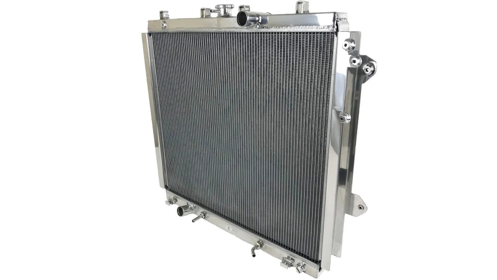

While installing the SC I "plan" on installing the CSF aluminum radiator at same time. Would that be a smart move or adding extra problems? TY for this entire write up again and was thinking of replacing trd pro airbox with the AFE Momentum GT cold air intake unless thats wasting money My only concern is will the AFE hook up to safari snorkel no prob.
If I ever win the lottery, that's exactly what I want to do. Can you keep us updated on your progress?
