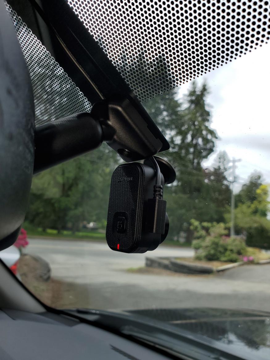

I’ve seen pictures of the Dongar setup and I don’t think it’s as clean as a typical hardwire kit run from under the dash. That goofy heat-shrunk circuit board hanging there just bugs me.
I’ve seen pictures of the Dongar setup and I don’t think it’s as clean as a typical hardwire kit run from under the dash. That goofy heat-shrunk circuit board hanging there just bugs me. ��
I agree. That's why I hid my Dongar adapter up in the headliner along with the other cables.
