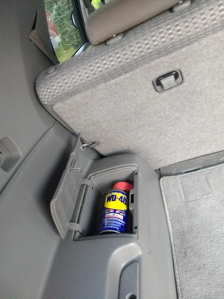

I concur...Great Instructions!!!. I am glad that I searched this forum before attempting the repair. It would not have guessed that some type of "programming" would be required for changing the lift gate lock assembly. We had been spraying the lift gate lock assembly with WD40 that was kept in one of the wheel well storage bins.

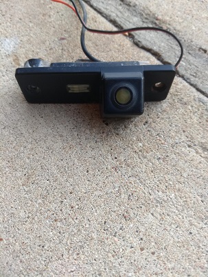

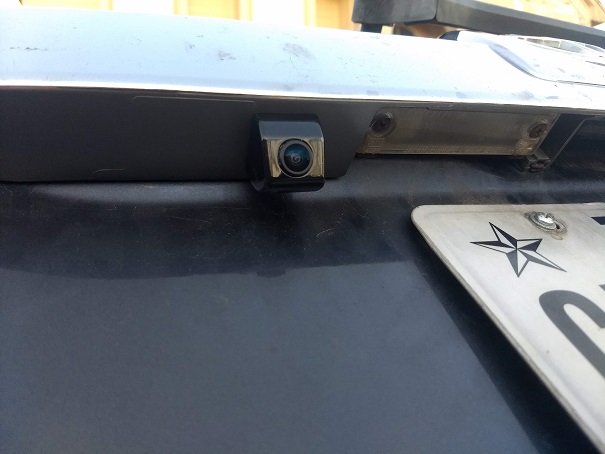

I purchased the lift gate lock assembly on EBay ($169.48, Part # 69110-35090). It is estimated that removal/programming/installation took 30-40 minutes, but I also replaced the backup camera ($16.99, LeeKooLuu Backup Camera on Amazon). The previous camera was okay until the plastic/polymer lens became "foggy" (discolored) after 1-2 years, but the best feature was no mounting holes had to be drilled since it mounted in place of one of the license plate lights. After some searching, the same mounting style backup camera with a glass lens could not be found for sale. The new backup camera has a glass lens, but a mounting hole had to be drilled into the plastic cover of the license plate light. Hopefully, this new camera will last longer.

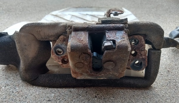

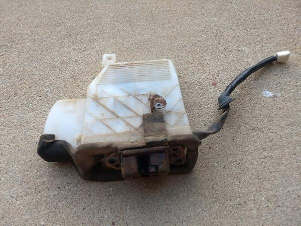

Good question, I was worried about that too before I started. If you look at the first picture, on the left side of the old part you can see two levers. Pulling on the smaller one opens the latch.
Also, I don't think slamming the gate causes the problem. The part looks and feels very sturdy and solid. I think dirt getting inside the assembly is the problem. And looks like Toyota knows that too because the new part has insulation around the bottom of the new part while the old one did not have that.

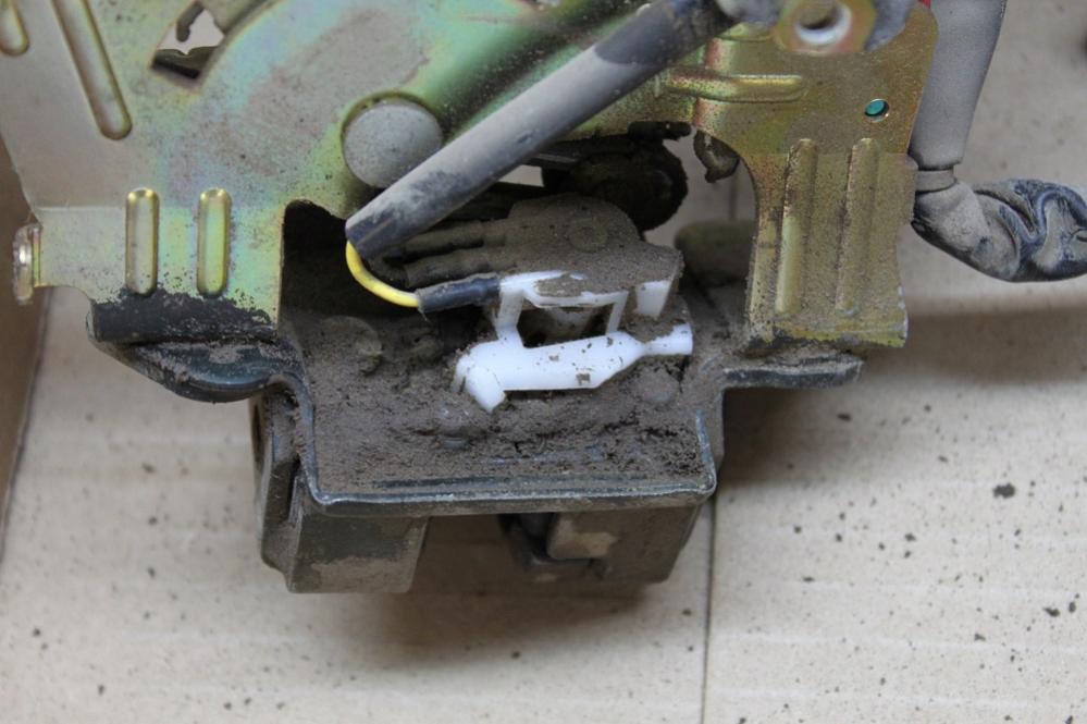

Pulled it apart... was full of mud, 2-3 cups worth in the tailgate.
Cleaned the latch all up with a toothbrush, brake cleaner and air compressor with a shot of red spray grease to finish it off.
Dang i think its working!

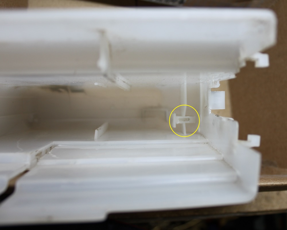

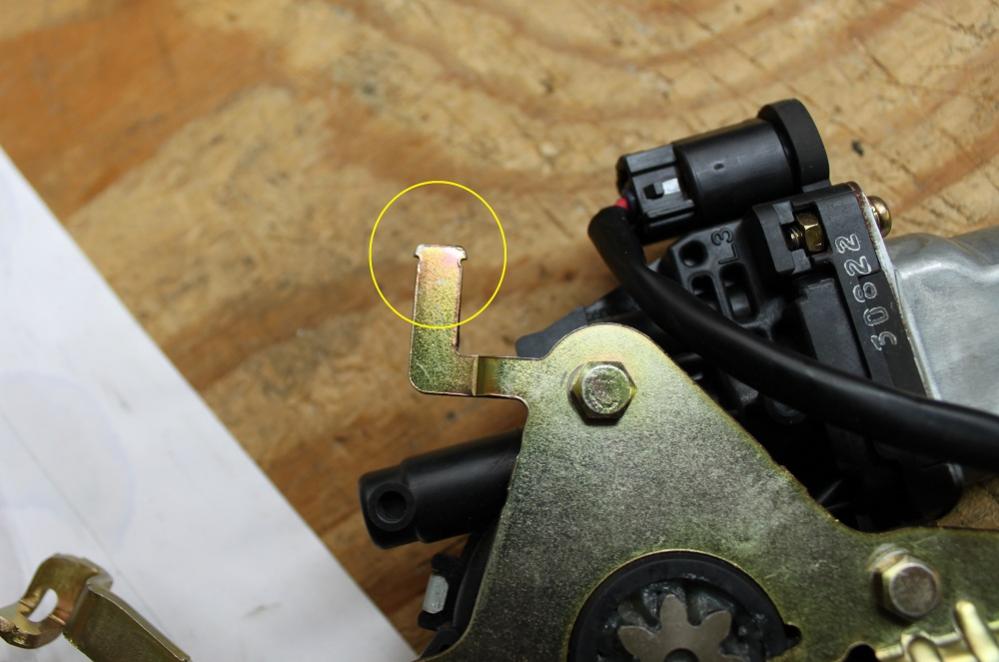

The cover has a hidden tab that you cant see... In pic...yellow circles.

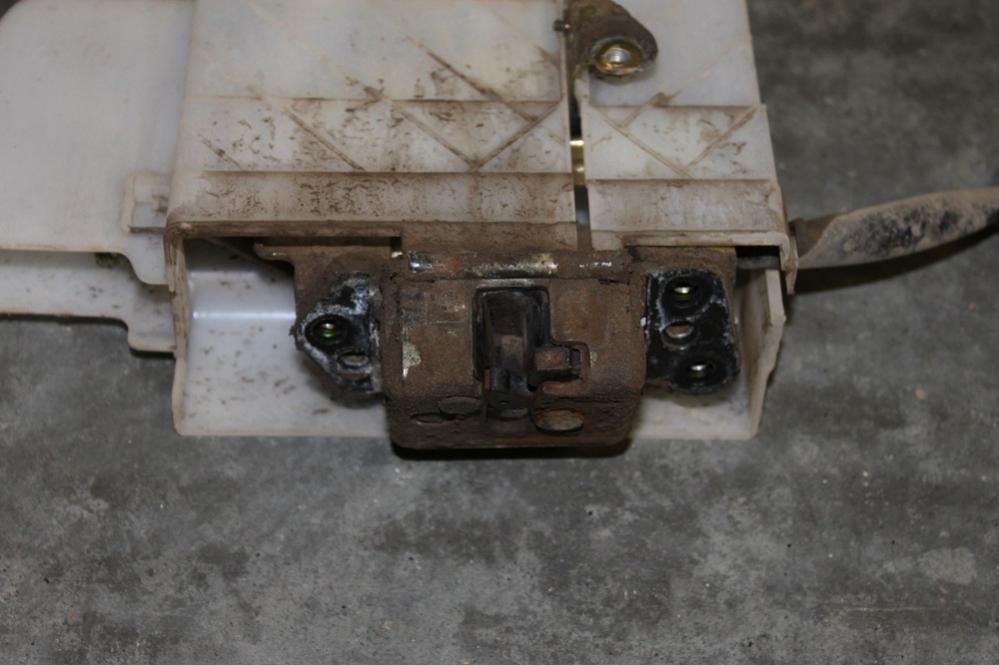

Had the same problem..wouldnt completely latch close and hatch opened when I came off my driveway. It was filthy did a full clean and grease service..no problems since
Hi there Derek, thank you for the pictures and apologies for resurrecting the old post. I've been struggling so much to get the actual mechanism out of that plastic cover. Did you have to just pull hard with force or is there any tip/trick you can share so that I don't damage the cover or any of the metal components inside. Thanks so much.
Pulls up, hard... is also a small phillips head screw, kinda hidden behind that metal piece on the front.
I see, thanks. Got that screw. The middle part seems to move fine. The bottom's what's holding it back. So just pulling it as hard as I can seems to be the only way to go, right?
Pull HARD. :)
I just went and looked at it, maybe wiggle and pull.
That little tab really has a good grip on the white cover on.

Pull HARD. :)
Found the actuator on ebay for $140.
Great, thanks so much. I'll try wiggling it this time. I was trying to be a little careful to not damage anything, but I don't seem to have an alternative at this point. I'm hoping clean-up and lubrication can fix the issue. I've sprayed it with WD-40 a couple times, and it seemed to work fine for a month or two each time. I know WD-40 is no fix, technically it's not even a lubricant but I didn't really see a point in doing thorough lubrication without having the mechanism fully exposed.
