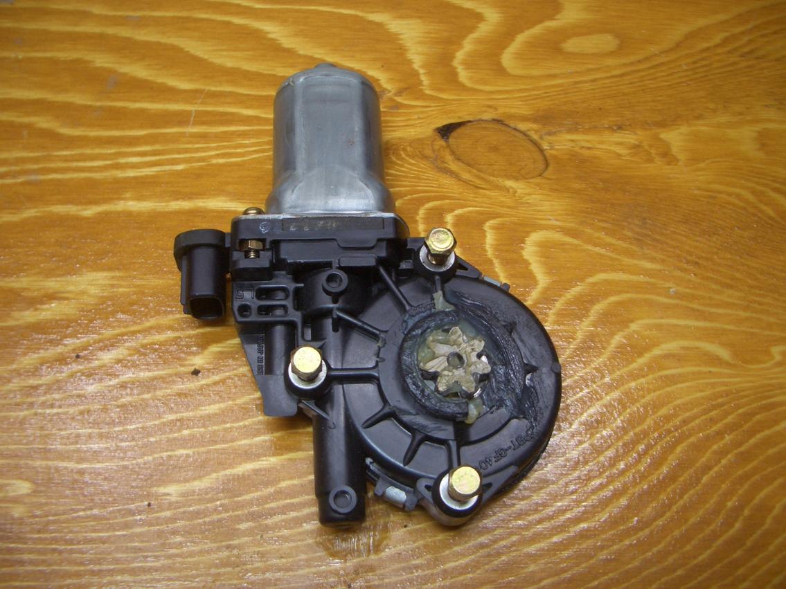

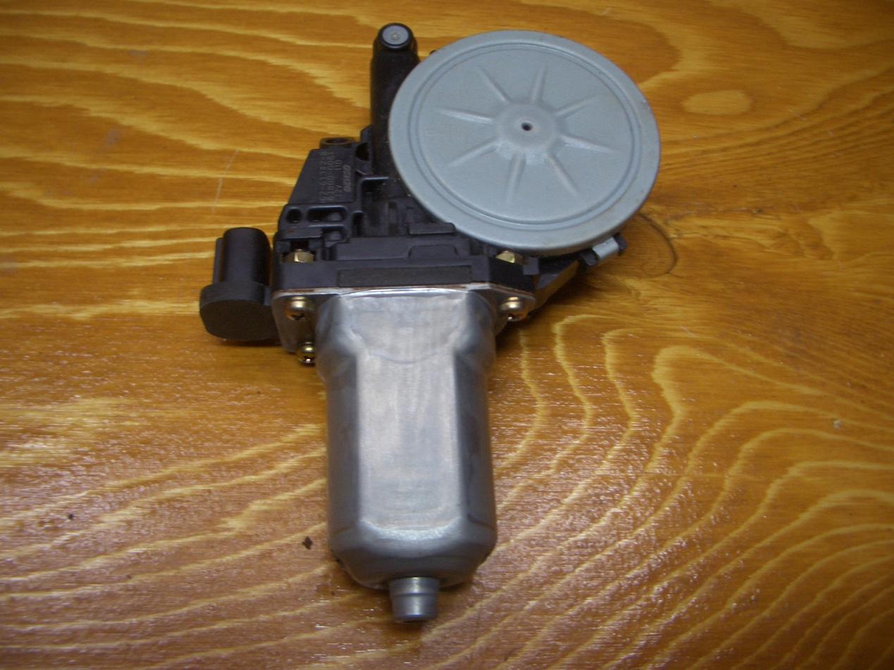

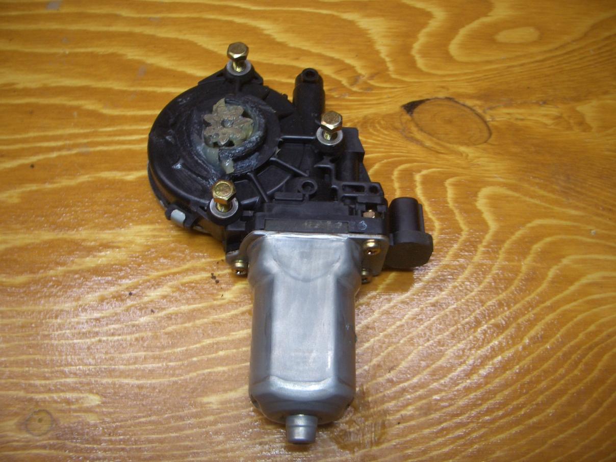

Motor up for grabs
I had a problem with the locking mechanism for the longest time. It would lock and immediately release again. Something wrong with the sensor. I finally gave up and ordered a new unit from Toyota. When I removed the old lock I took it apart and salvaged the motor which looks and works like new. So, if anyone out there feels inclined to repair a lift gate lock with a burnt motor, feel free to contact me. I am willing to part with it for $30 plus shipping.
