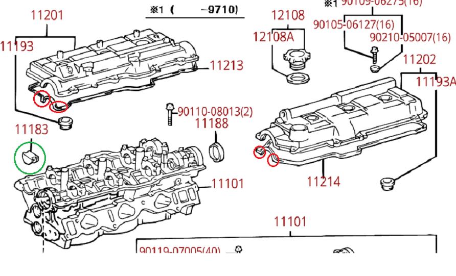

Look at the picture and the red circles you will need to put FIP-G (Form in place gasket aka silicone sealant) where ever the gasket makes a right angle upwards to go over the cams. Also circled in green there are 4 cam plugs (2 PER HEAD, FRONT AND BACK). You NEED to and I repeat NEED to remove these and clean the old FIP-G and re apply new FIP-G or they will leak and your time and money will be wasted.
I wasn't planning on using FIP-G or cleaning the cam plugs. This is why I joined this forum. Thanks for the advice.
