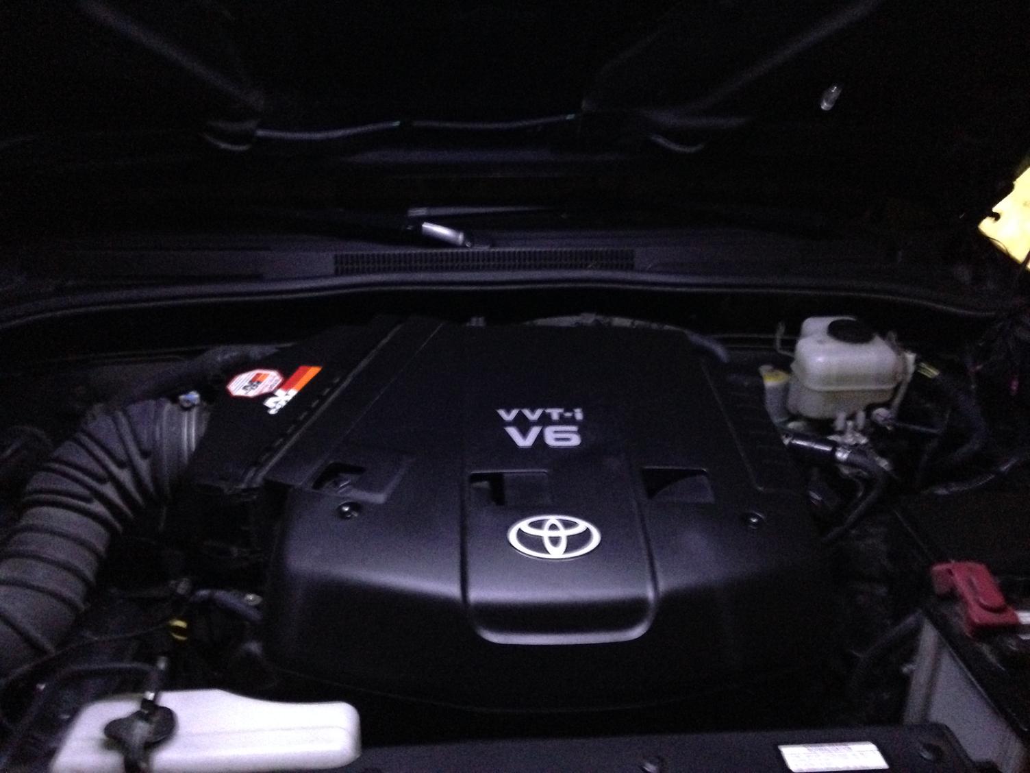

Finished right as the sun set. Thank you for the write-up!

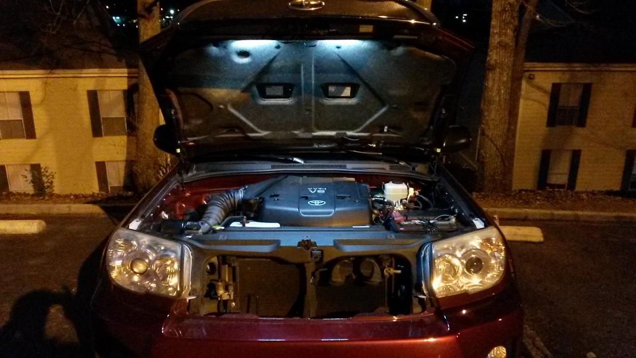

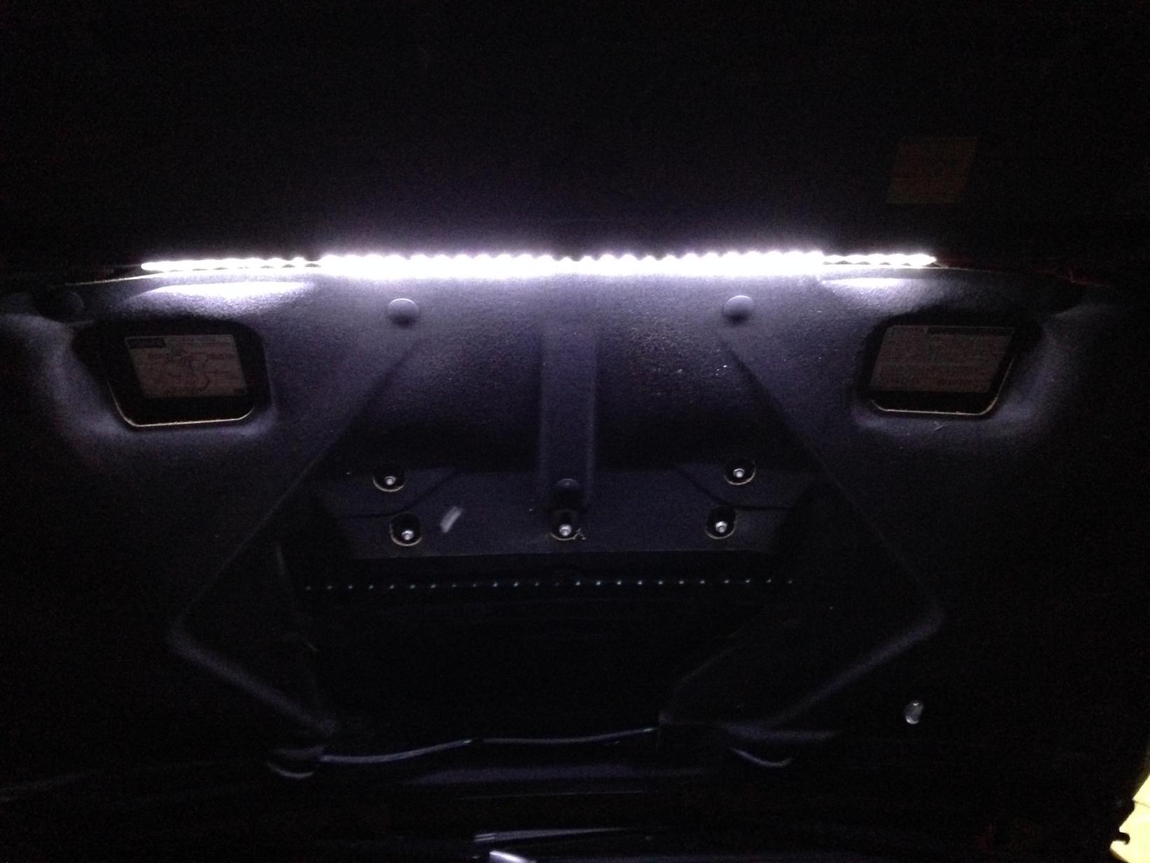

Just installed my LED lighting under the hood mod and love it! In all cost me roughly $40. All thanks to eBay :D
