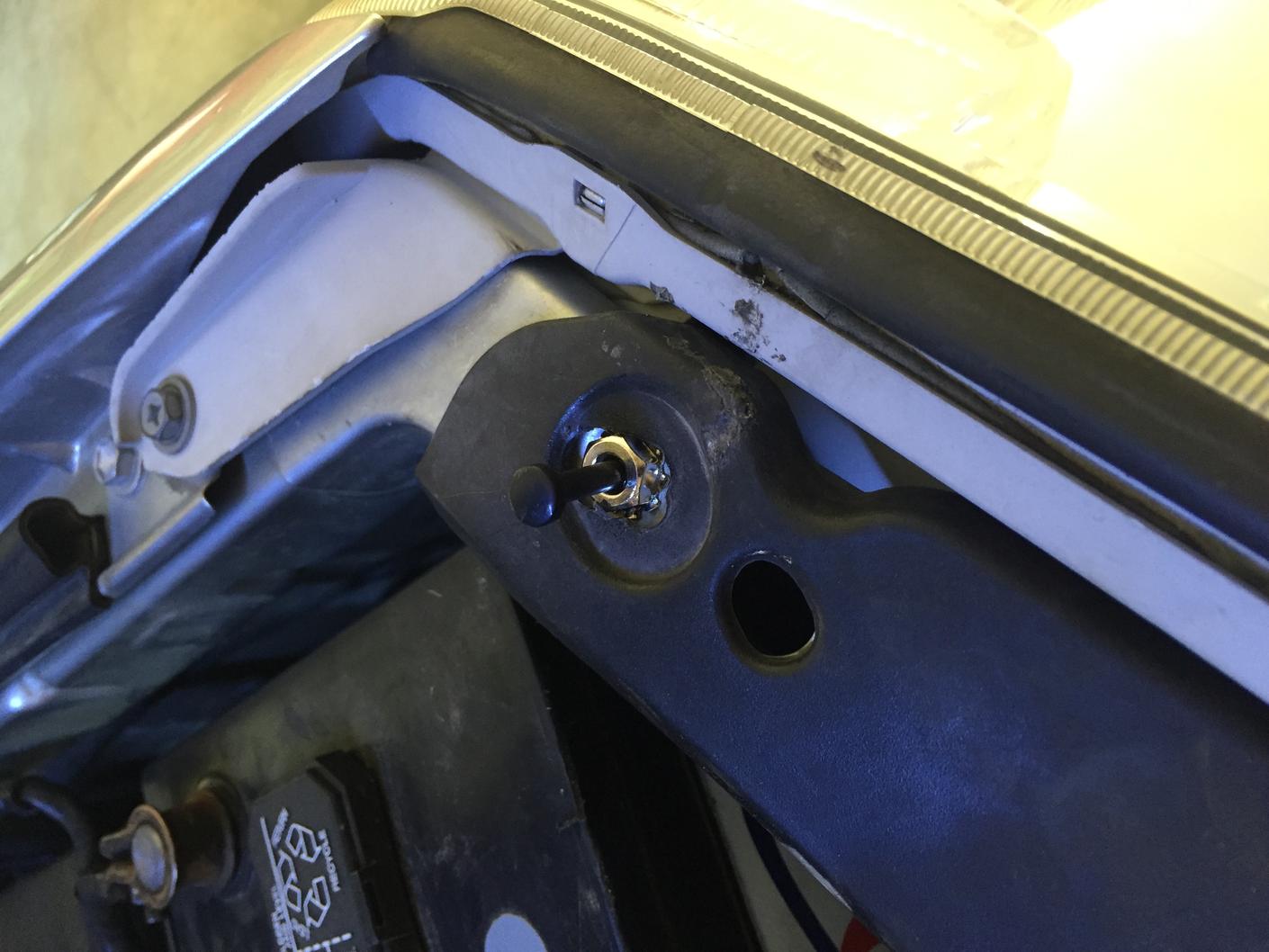

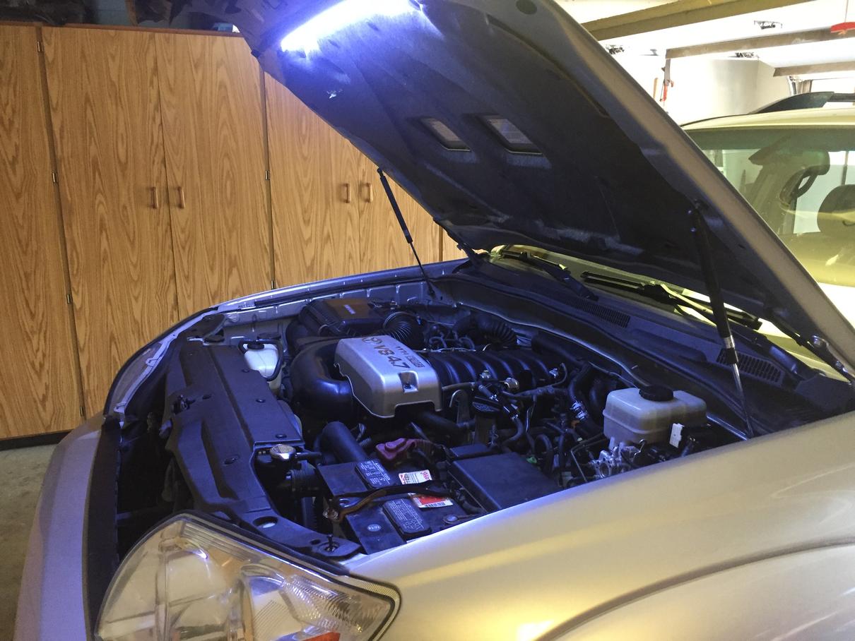

So all my parts finally arrived, and I did the install yesterday. I tweaked it a bit though. I used a hood pin switch, and also added a toggle switch so I can easily turn it off if the hood will be open for a while. Only complaint is the eBay light strips aren't as bright as I'd hoped, but if that annoys me I can always upgrade to something legit. Here's a few pics... image.jpg

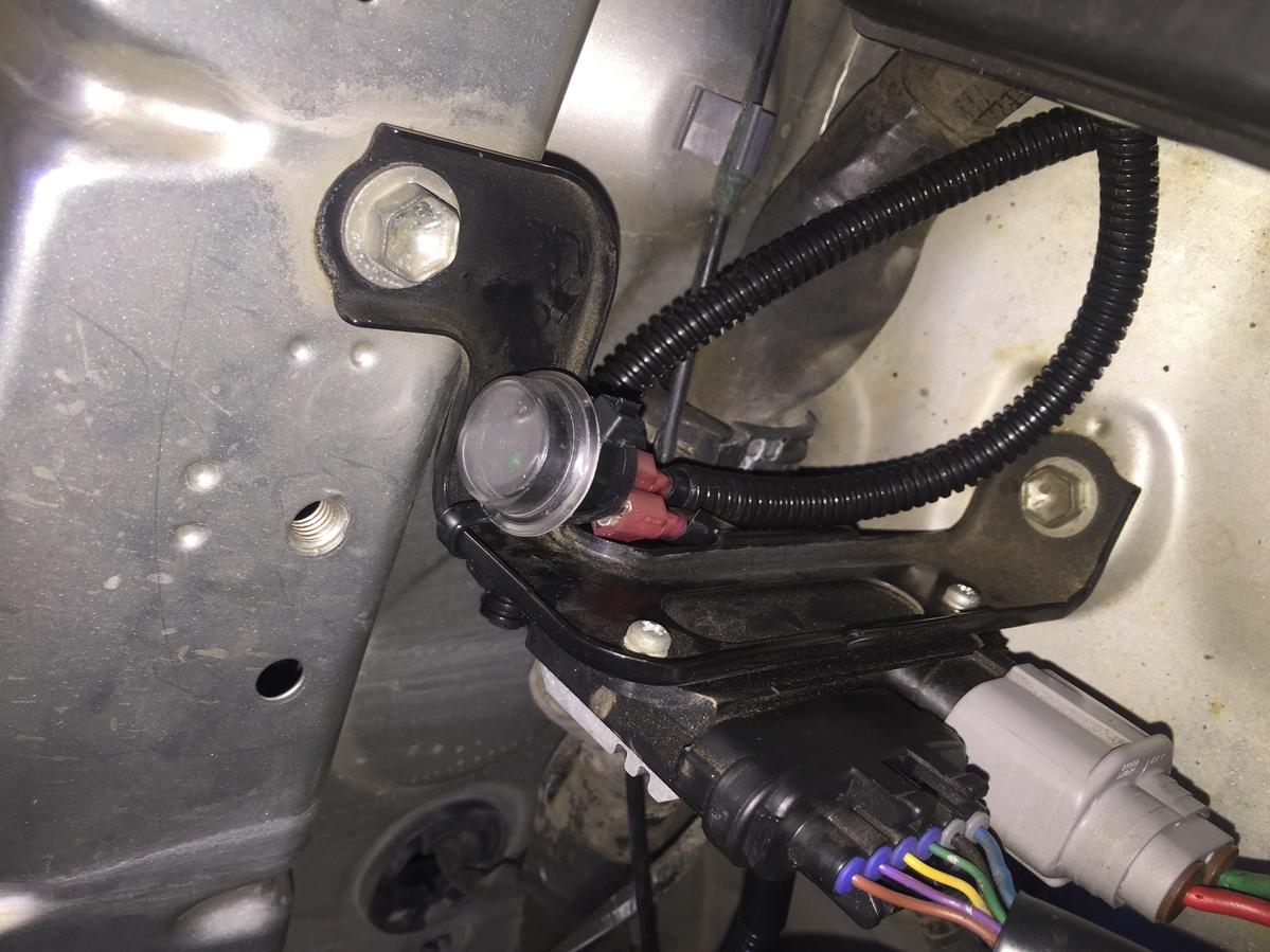

Another... (Sorry, I can't figure out how to add more than one pic in a reply). And yes, I did use zip ties to hold the switch in place. image.jpg
