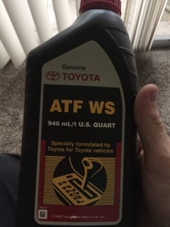

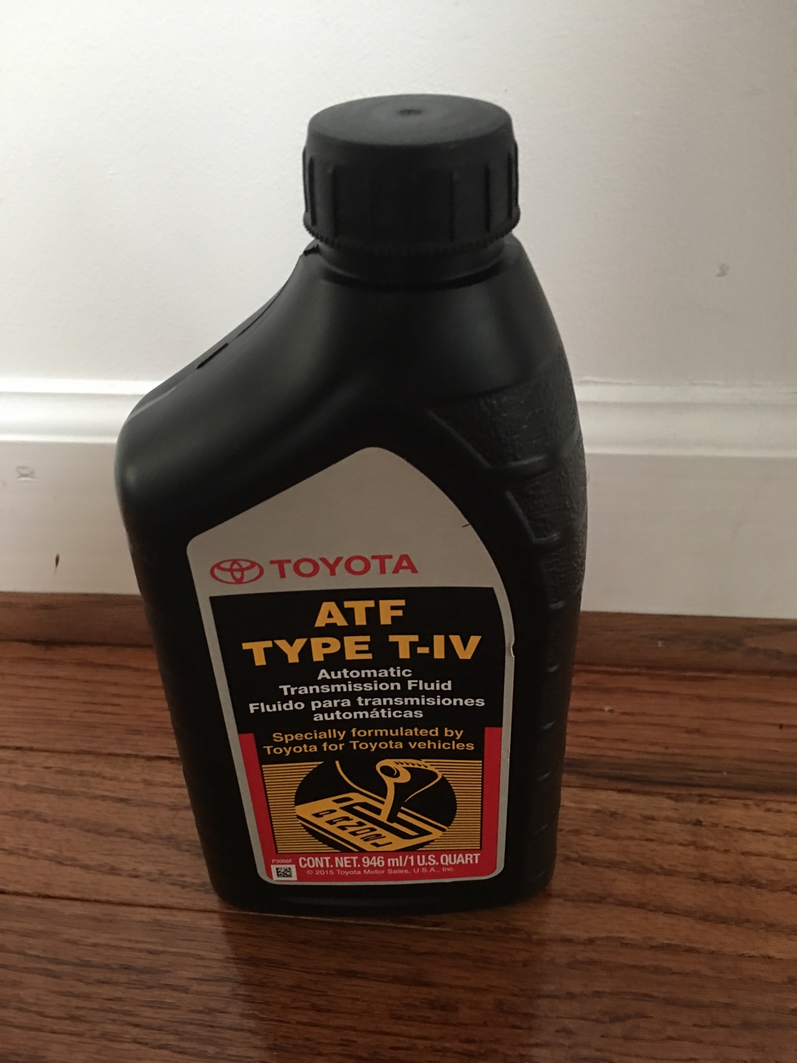

When I search "toyota power steering fluid" on amazon the first item that shows is Toyota Genuine Fluid 00718-ATF00 Dexron III Transmission Fluid.
This is what I used, manual states automatic transmission fluid, I went down to my local dealership and they gave me these bottles.
It's there any difference between those two? They look like they're the same thing with an added "type" on the label.

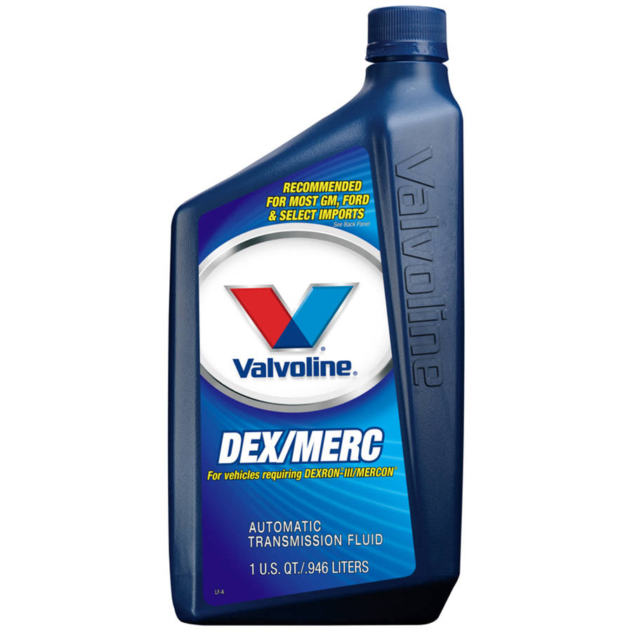

Does it matter what kind of fluid I use. In particular can I just go to autozone and get and atf dextron III for the flush
I did this using your method a year or so ago... Worked well. I used Valvoline ATF. I believe it was 2 quarts total. I bought three and have an extra on the shelf.
