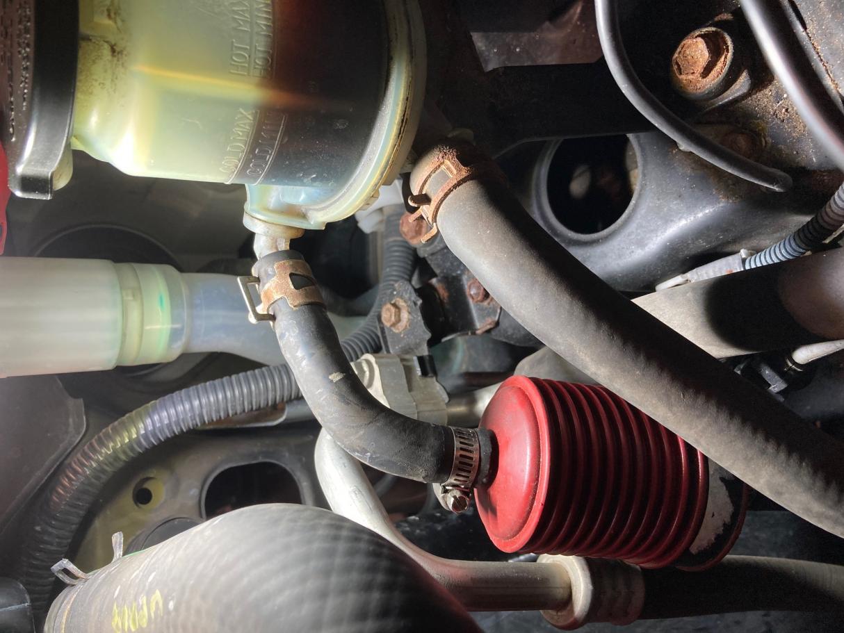

It only takes 1 qt to replace the fluid. And at $8 a quart, thats all I use. Valvoline max life ATF is great fluid for this. So heres a tip, use 1/4” ID clear vinyl tube instead of vacuum hose. Shove it into the return hose until you feel resistance. No zip ties needed, there is no pressure in this line. You will see immediately when the ejected ATF is coming out clean.
And lastly, install a Magnefine inline 3/8” filter. This will keep the fluid clean and help prevent wearing of the rack and pump seals.

Yea it’s definitely not cheap! I appreciate the advice too I hadn’t thought about installing a filter.
I’m hoping this will fix the PS growling on cold days. If it doesn’t, was going to try that Lucas PS stuff.
