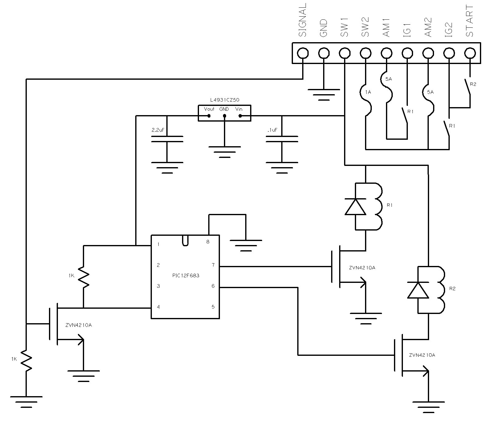

I've done a fair amount of testing with the 4Runner's systems and have a solid design in progress. Whether or not it will be as good as a professionally installed system, that's hard to say...

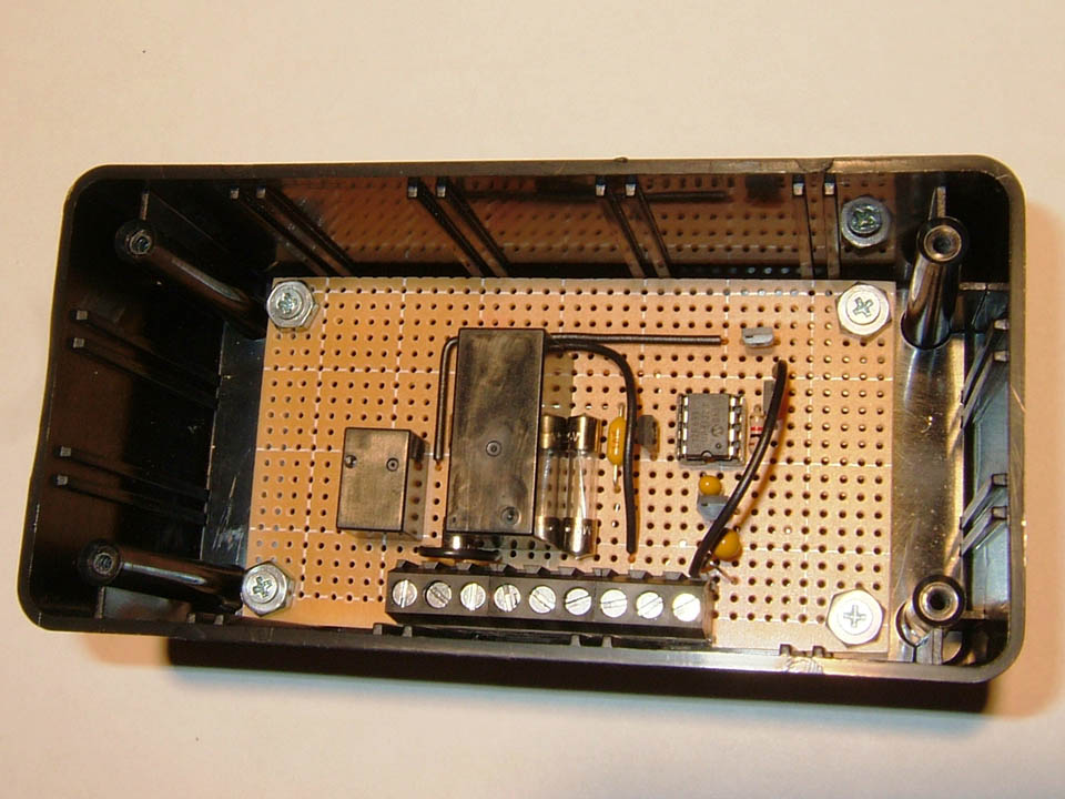

I'm not sure how many people are following this thread but I thought I conclude it with the confirmation that my DIY remote starter is installed and working nicely. The factory keyless entry remote starts the engine, which will shut off after 15 minutes unless the ignition key is turned. The two places I need the remote start feature are low theft risk, so I just leave a key in the ignition and lock the doors if I want to enable remote starting.
The bottom line is that DIY starters are not rocket science, but will require more than a couple relays to get the job done. As with my MPG display calibrator, I used the trusty PIC12F683 microcontroller for the brains of the operation.

I don't think I can post a video, but I'll post the schematic and a picture of the assembled circuit. I'm considering having a real printed circuit board made up and putting it in a smaller enclosure. The breadboard and moster huge Radio Shack enclosure add a significant cheese factor.
Starter Circuit-
