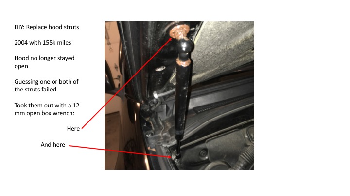

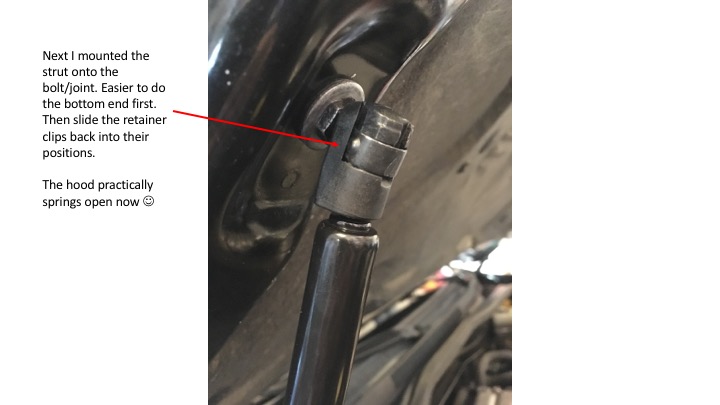

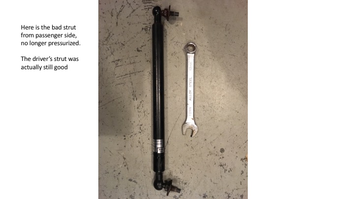

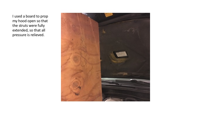

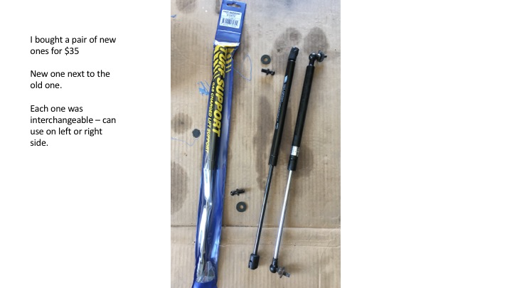

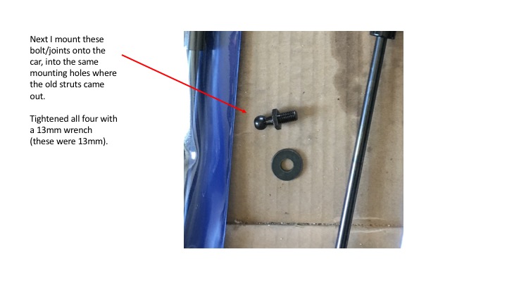

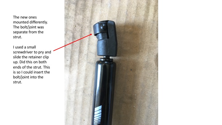

Hood no longer stayed open. Time to replace the hood struts.
Tuff Support Hood Lift Supports 2003 to 2008 4Runner ($31.33 on Amazon)

Do you recall the part number of the struts? Based on your picture those are Monroe ones.
They’re like $150 each from Toyota dealers in Canada. These are one of the few repairs where OEM is probably not worth it.
I picked up the StrongArm 6228 struts from Amazon.ca last summer for $23 CAD each on clearance , they are usually around $45
They’re identical to the Monroe, I believe they’re sold under a number of different brands.

ME TOO!! I just bought two (Monroe 900105) at Pep Boys for $53.20 US out the door.
I saw similar on Amazon, but didn't say "Monroe" and had no reviews so didn't want to risk it.
Installed exactly like the DIY in post #1...so simple even I could do it, even after getting concussed and having my arm pinched off by the hood slamming down on me yesterday.

Has anyone had issues with the ball screw not fitting into the hood? I purchased Sachs replacements and the screw does not fit in the hood. The original is about 1/4” longer and not threaded for the first 1/4”. I have an 05 Limited V6.
I want to purchase the Monroe 900105 but the screw looks the same as the Sachs model that does not fit.

My lifts went south a year ago. Bought replacements ("Autosaver88") from somewhere. Noted one side would occasionally pop off of its ball fitting. Scared my teen driver when she was checking the oil -- she wasn't shy about getting under the hood until it came down upon her head (insert Beatles medley).
The Autosaver88s didn't have clips or any obvious spring/mechanism to keep them on their balls beyond the pressure of the lift against the fitting. One side was stronger than the other, so the weak side always let go.
Finally had enough of that nonsense -- bought the Monroe-branded replacements. Pulled off the old strut, undid the 12mm ball fittings, put on the new (13mm) Monroe fittings, noted each end of the Monroes have spring clips in the ball socket. Literally popped the Monroes on (nothing more than a palm slap seats them, no disassembly). They are stiff and dang near perfect. The girl is out there changing her oil now.
