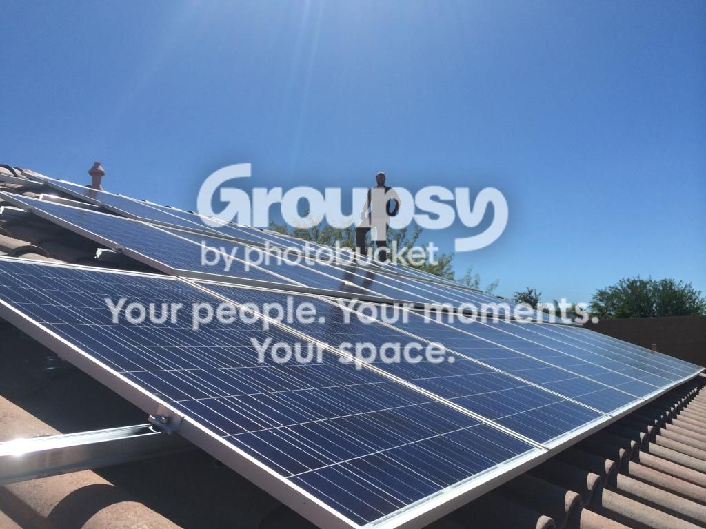

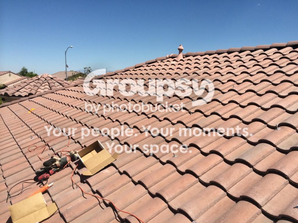

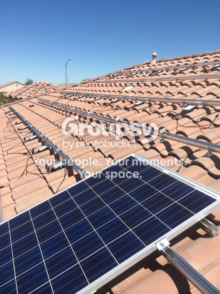

So if you look closely you can see each roof mount, this by far is the most time consuming aspect of the job:

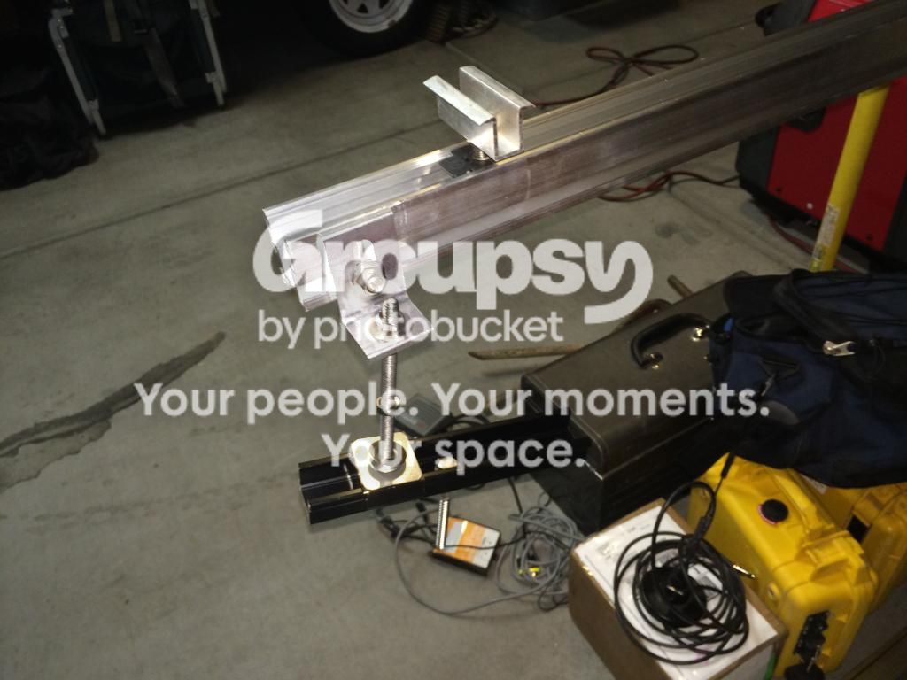

Now, I didn't get any shots of the mount under the tile (I will add them later cause Ive decided to add a couple mounts to longer rails I decided not to cut down), but essentially the install goes in the order of this photo:
From bottom to top:
1. The "Tile-Track" base and lag screw is drilled into the truss under the tile.
2. The "Tile-Track" receiver is adjusted along the base to correspond with the up slope of the s-tile, which has a hole drilled though.
3. The "Tile-Track" receiver holds the threaded bar that runs up through the tile hole. As shown in the previous photo the flashing and nut is then attached leaving you with a threaded anchor for the "L" bracket that holds the rail.
-Copious amounts of roof sealant are used in each penetration.
-If you have flat tile or composite shingles this wold be a far easier task.

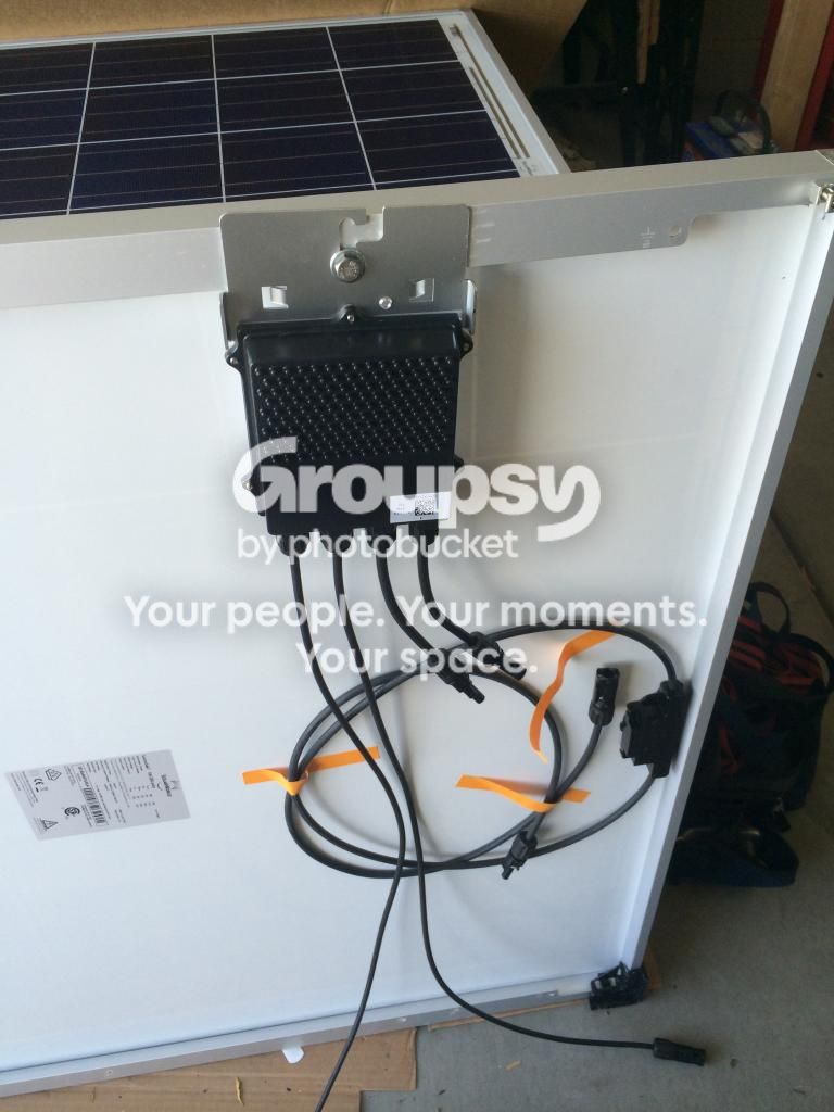

The optimizers (if you get a system with them)(micro-inverters will be the same) can be installed various ways, just as long as they are clear of the panel edges. This photo is of one way...I didn't go this route but it is an option. Also, this shows a close up of the connectors, the panel connects to the shorter optimizer leads and then the longer leads from the optimizer goes to the neighboring optimizer. + into - and so on.:
I choose to attach the optimizers directly to the rail like so:

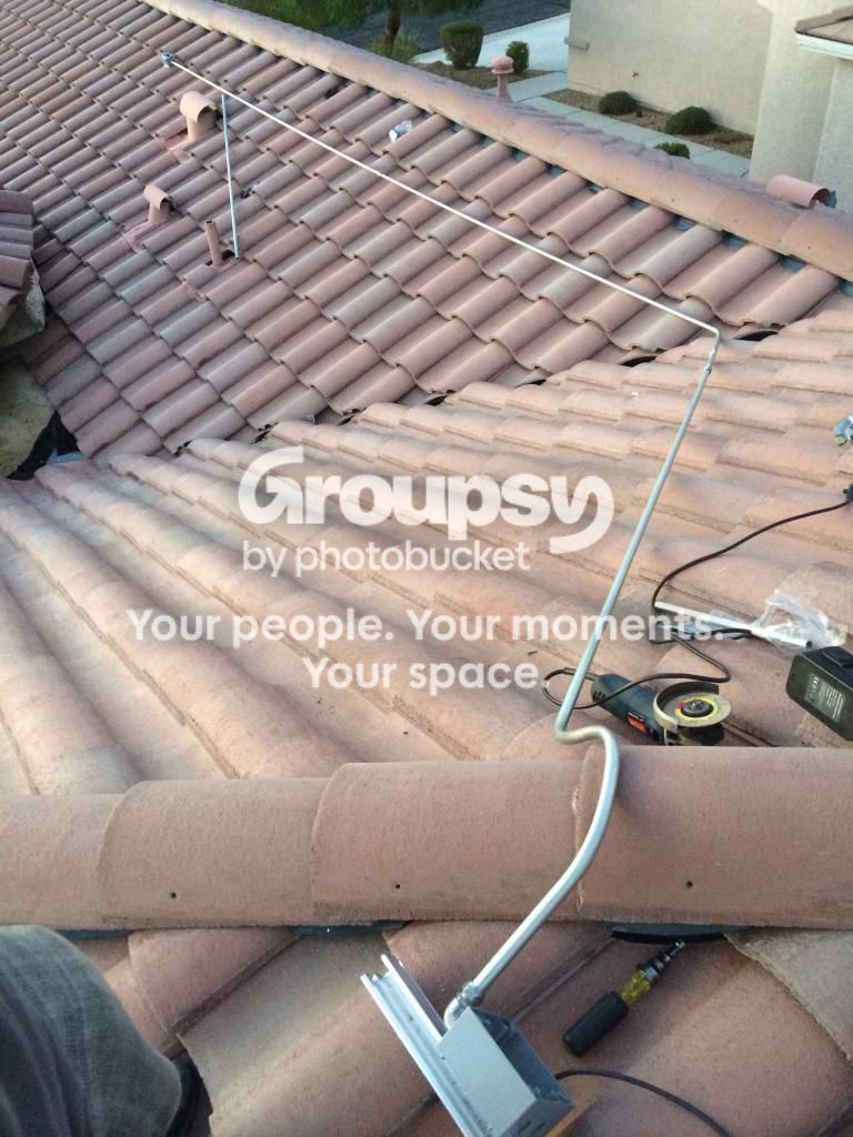

I did two runs, as this diagram shows. From the end of each + & - run I ran leads to a J-Box:
J-Box to J-Box. The J-Box on the far end is over my garage attic, so this run drops into the attic. Essentially, I have two J-Boxes sandwiching the roofline on the far end:

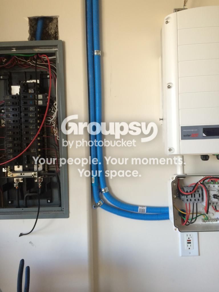

I have no pictures of the run in the attic, I can get some if you guys want them, but the DC runs come down into the garage right next to the main panel / the AC goes right back up and drops into the main panel:

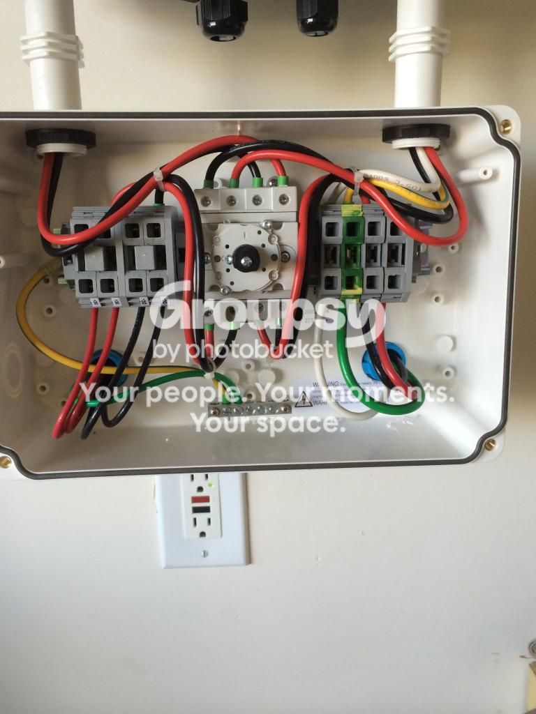

Inside the Inverter:

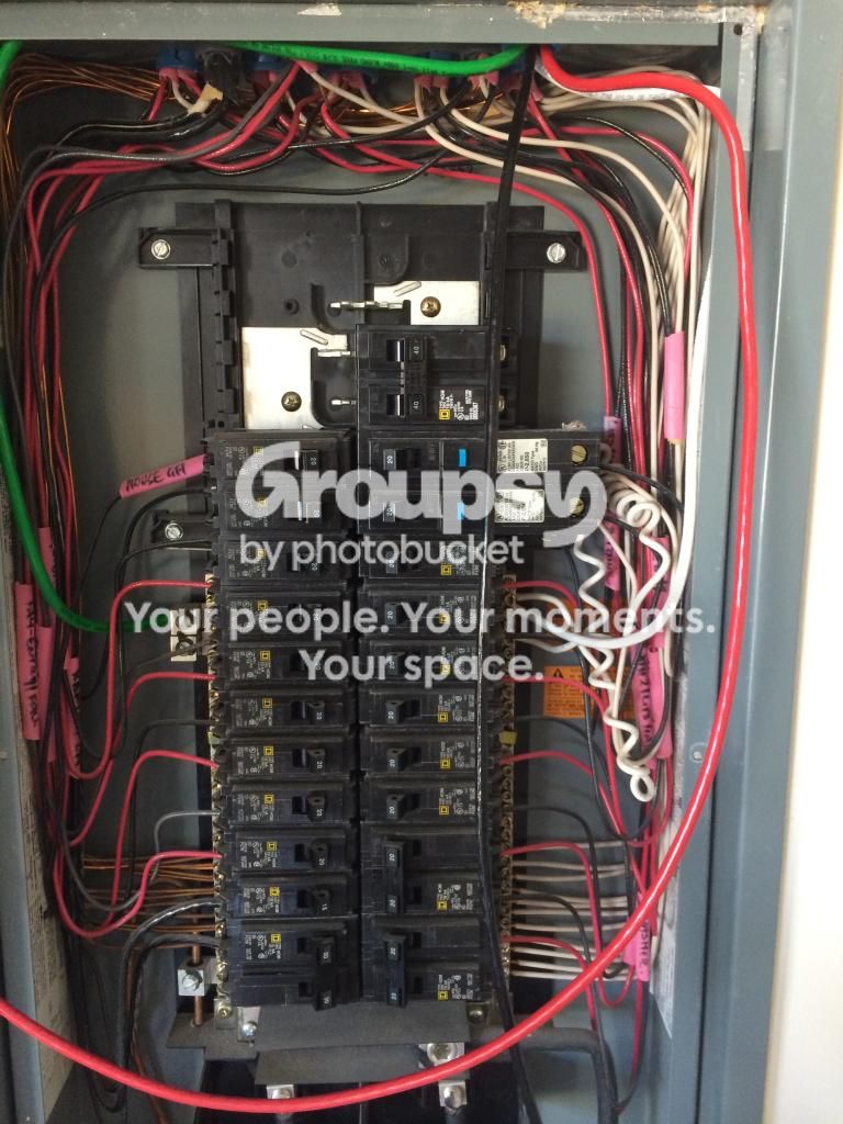

Inside the Main:

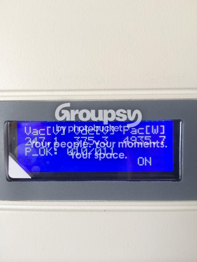

Operational (note this was just a test, as the city inspector will be by next week to, well...inspect):
Inspector came today and I was left with only two corrections. One, the attic needs to have metal conduit and two, the run from the array to the inverter has to be labeled as "live" every 10'.
