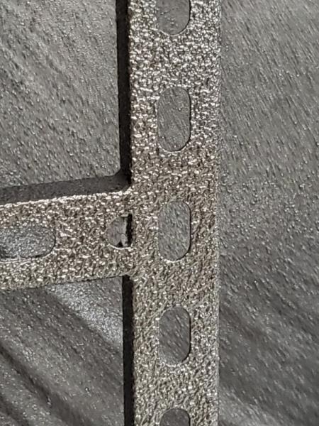

I modified the design from the DIY in several ways by adding extra cross supports, using 14g steel, making the outer frame fully-enclosed/sealed, making the rack full length, including designing a wind deflector, adding side mounting points (1/4" thick), wider load-bearing mount surfaces (more on this later), etc. I was not in a particular hurry so I actually Tig welded everything on both racks:
Although my garage floor is far from flat, we used it as a starting point to get the outer frame. Another design change is that we made the inner struts sit exactly one inch from the top of the frame, which gives a 1" lip to prevent items from potentially sliding over, but also means that longer pieces can fit flat against the outer edges of the frame. I literally used hockey pucks to get the 1" spacing:

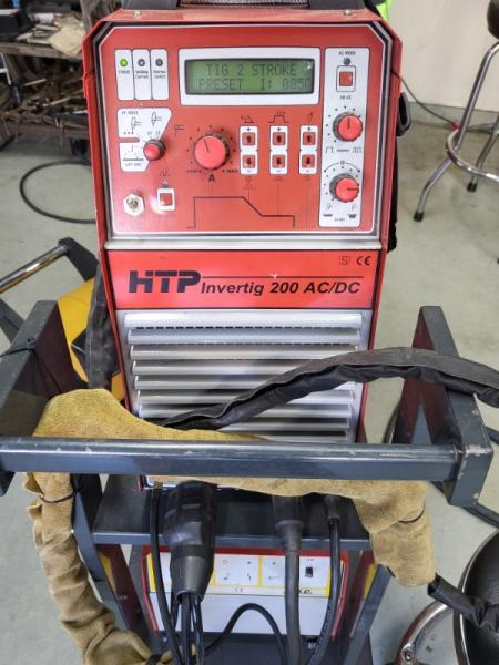

I used my "old" circa-2003 HTP water-cooled Tig welder for everything. Not as modern and lacking options from the more recent HTP 221 model, but it still works well. This is my second HTP welder (my other one is the 2100 MIG welder) and I am super impressed with HTP:

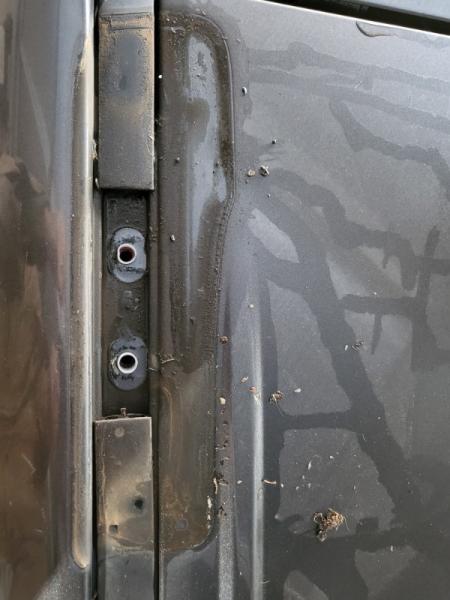

Several roof racks are installed with all of the load/weight placed on spacers, then bolted to the roof, which is not the way the factory roof rack (nor Gobi) does to spread the load to a larger bearing surface. Here is the wide area used by the factory Toyota mounts:

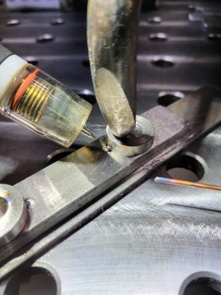

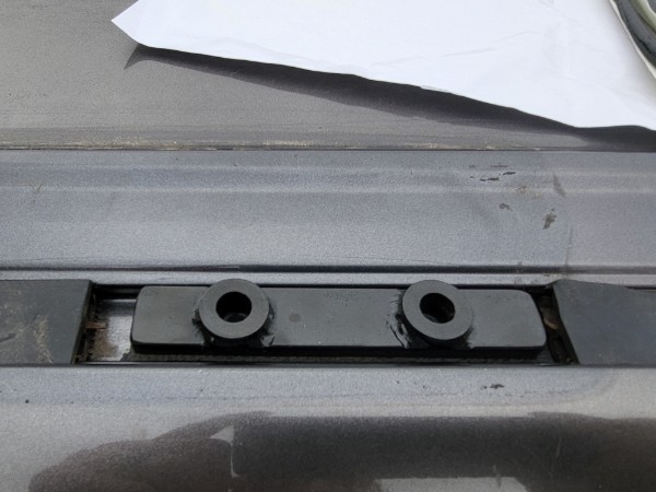

So I designed a two-part system to spread the load. First, I designed a wider mounting plate with welded spacers as a single unit, which will be bolted to the rack, and 2, a wider mounting plate on the rack which spreads the load over the factory/OEM rubber pads, like in this preliminary picture:
Here you can see me using a fixture I created (since I am doing 8x of these - 4x mount points times two racks, one for my friend and mine):

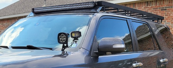

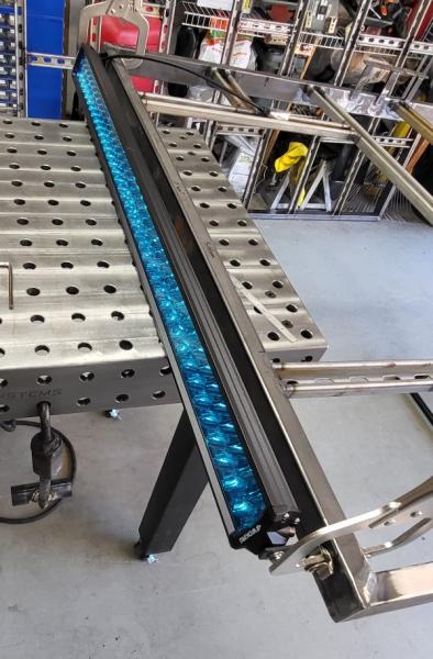

I then designed and fabricated custom mounts for the LED light bar:

The rack and the 6x mounting feet (4x bolted to the OEM locations) are going to be fully painted/protected, but the spacers in the roof need protection as well, so I used temp-cured Molyresin for those.

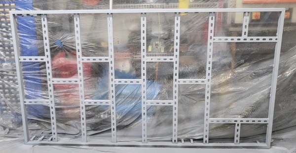

For priming the rack I used Raptor Acid Etch Primer for the "easy to reach" spots, and Rust-oleum high performance metal primer (oil-based, applied with a foam brush) to reach into the nooks and crannies, specially inside the lips of the strut pieces. Once I covered all the tough places with Rust-oleum, I then spray painted the frame:
I then used the Raptor coating to give it one coat on the bottom and two coats on top (where it will see wear):
After 3x days of curing indoors, I then proceeded to use butyl tape to seal the roof openings (same OEM style material Toyota uses), layer the rubber spacers, the steel spacer, and then I was ready to bolt the roof rack for good:

And here with the LED light bar in place:
