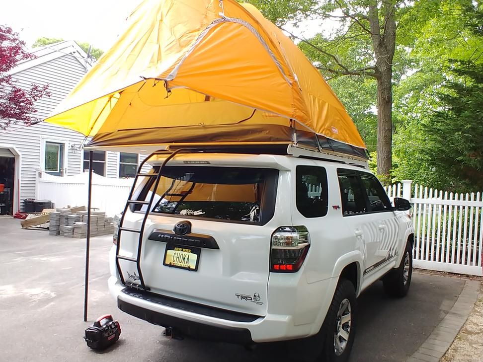

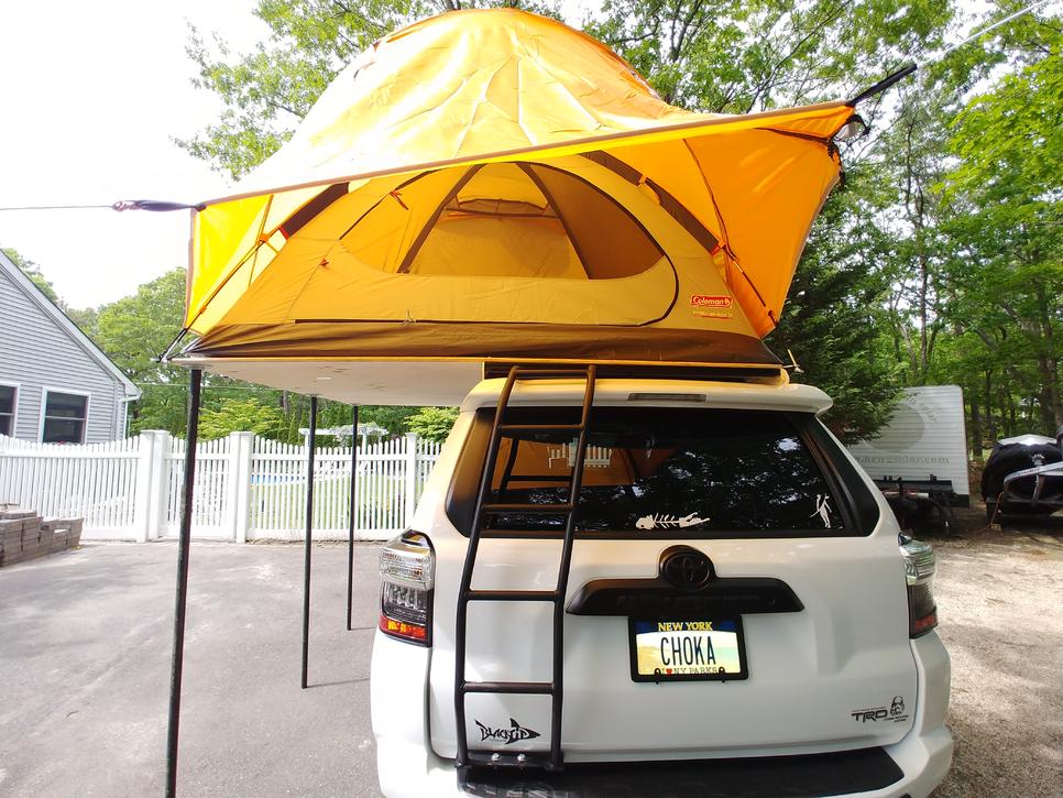

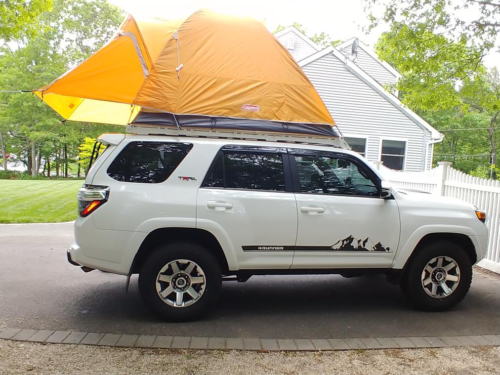

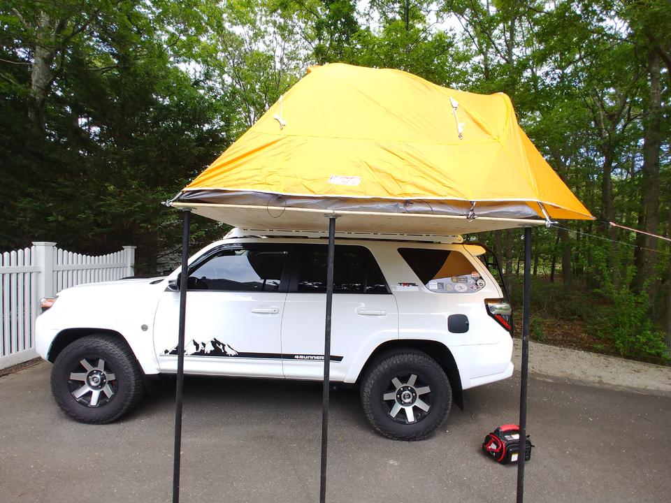

Very happy with this DIY RTT Build-

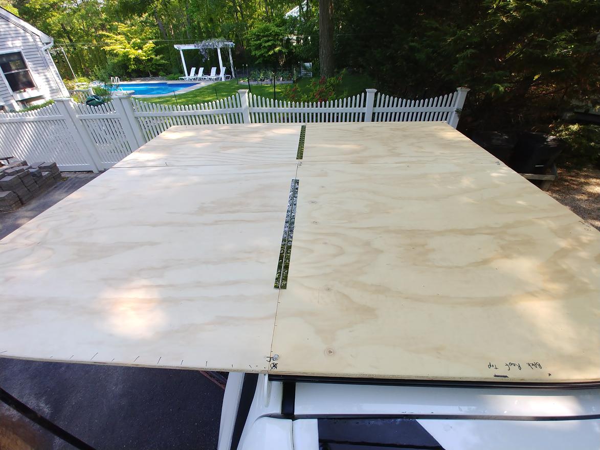

Put it all together, 2 platform tops, 1 is 4' x 8', 1 is 3' x 7', each fold in half with a piano hinge.
this made it much more manageable for me and easier to store. I especially like how this project worked with my Prinsu Rack and Baja Ladder. overall it feels very sturdy and the tent is secured very well to the eye bolts. I weight about 180 and will sleep with my torso over the rack and my feet over the overhang.

Qty 2 - 4'x8' 3/4 inch sanded plywood - cut in half to make qty 4, 4'x4' each
- Cut 2 boards to 4x3

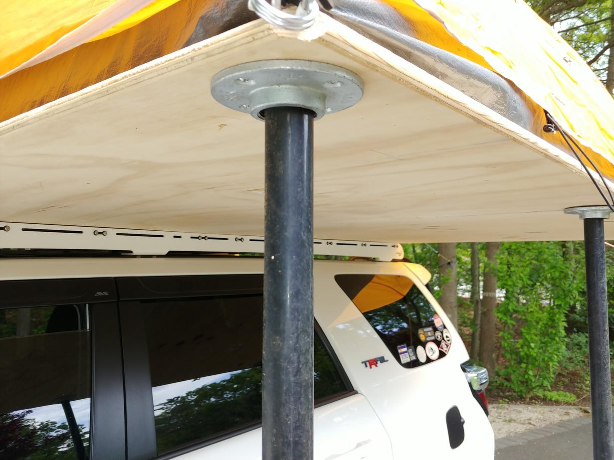

3 Posts - 72 inches (used old chain link fence top rails)
3 top fence sleeves $15 - https://www.homedepot.com/p/YARDGARD-1-3-8-in-x-6…/204510279
$9
3 - 1 1/2 inch pipe flanges - local Hardware store
$18
