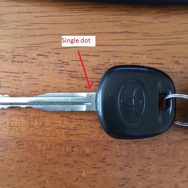

1. Bought a new blank Toyota transponder from eBay (about $12, it has a dot near base the of key shaft; see picture). Although advertised as an “OEM Toyota key”, it appears to be a Chinese clone (different metal color). Toyota part number: 89785-60160
