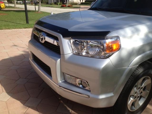

I use an AVS AEROSKIN bug shield which attaches directly to the hood with 3M tape. I would not use OEM shield because over time the clips will definitely rub off the paint. I had this happen with other vehicles.
