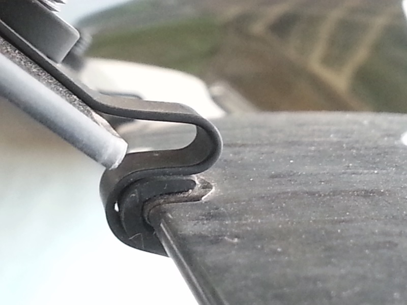

You're over thinking it buddy...just use what I posted above if you are worried. As you can see below, what I did was put on a small piece of vinyl material (the kind people use to wrap their cars) onto the edge of the hood; then I cut a small strip of that door edge molding (found a few posts up in this thread) and clamped it over that to protect the edge. After that you just need to adjust the bracket a little bit to fit over the molding and presto, you're done.
There's no chance of metal to paint contact anymore, and the paint under the door edge molding should be protected from scratches by the stick on vinyl. Please excuse the dirt and crappy picture :)

Can you zoom that out a bit? I'm trying to visualize what yours looks like. It seems the nose of your deflector curves significantly inward.

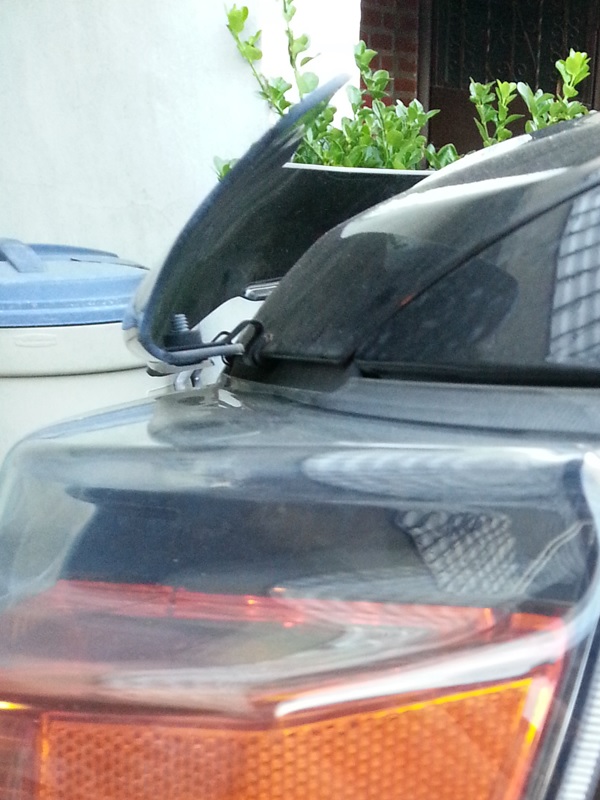

Does this help? That is the same bracket that I was taking a picture of above. I think the US one stands more upright vs the CAN one that seems to hug the hood closer.

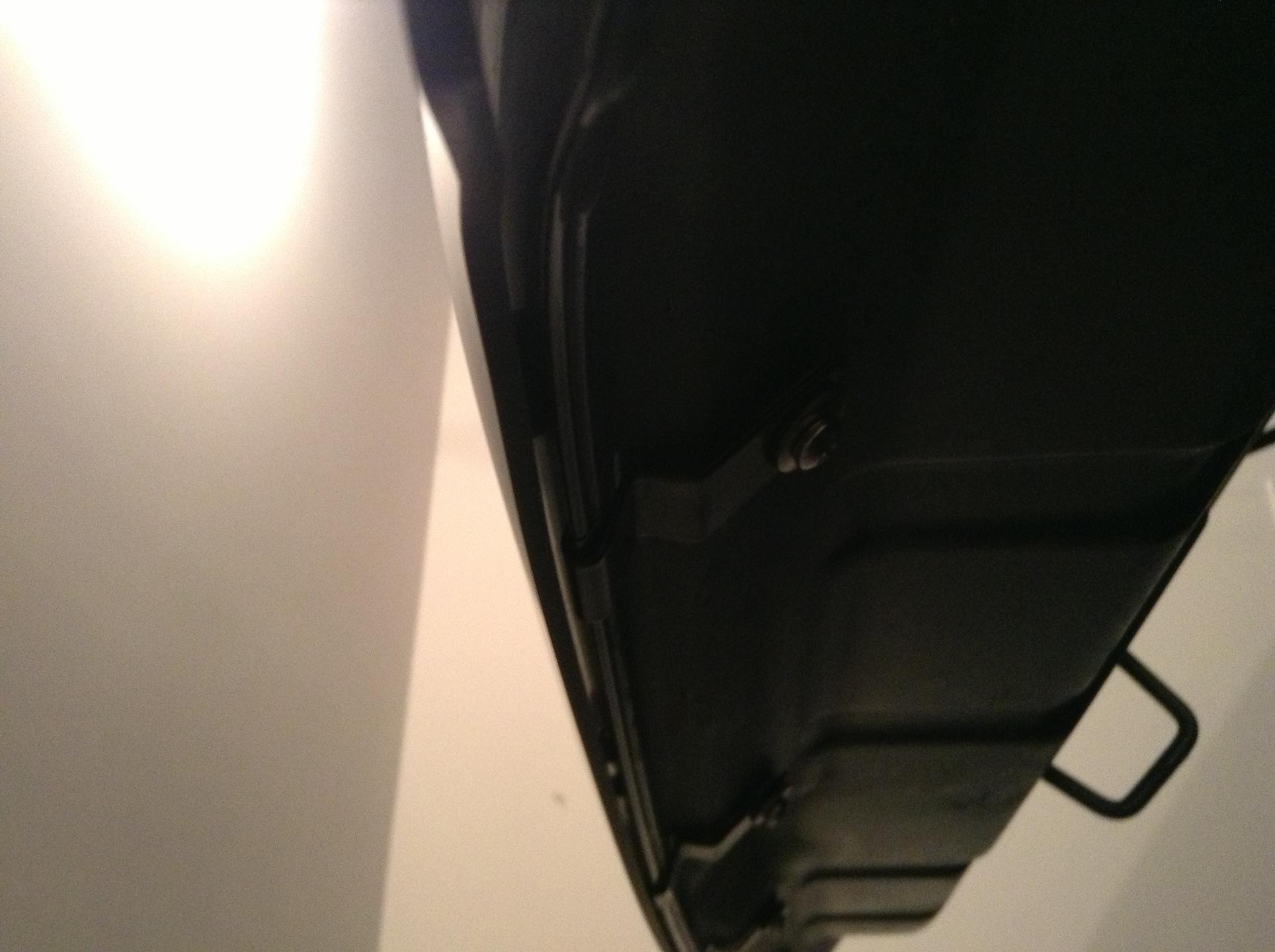

Wow, that's a big difference. Instead of bending outward toward the front the of vehicle, the bracket on min just continues up the hood. From there you out a pin screw thru the deflector down into the bracket, you can sort of see what I mean here. This is only the inner 4 brackets. The 4 outer ones are different.not sure your idea will work for me :(. Edit: not sure why the pics from my iPad are posting horizontally.

Hmm, I see what you mean, the underside of mine is similar to yours but your bracket seems to wrap a lot tighter around the hood's edge. Not sure if this would work in your case, but what I did to make it fit easier was elongate the square hole in the bracket (where you screw it to the underside of the hood). This helped it to let the bracket space out forward a bit more so that I could clear the molding strip.
If you see that your brackets just can't clear that much thickness from the molding strip, maybe you can just double or triple up on some hood protection film. This is exactly what I was planning to do until I thought of this method. You can get huge rolls of that stuff on ebay and just cut it into little strips.
