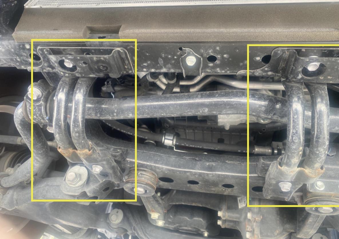

Do all aftermarket skid plates delete these parts?
sactown
Member
I did some searches but wasn’t finding it so starting a new thread. I was putting in the Talon engine skid set and was a bit concerned that it requires the removal of these two brackets (pictured). They seem somewhat heavy and structural, is this typical of all aftermarket front skids or are there other brands designed to retain these brackets? I like the Talon catalytic converter skid cover which goes in easy, but this engine skid caused me to pause and investigate more. Any input is appreciated.

Some if not most heavy skids delete those. The skids are much stronger anyways so no worries there. Some skids keep the bars like the RSO/ARB skids.

He may have meant RSG. Also, in some cases, there are skids for 4Runners equipped with KDSS that require spacers or purchasing a specific skid plate for KDSS. I had to remove a couple small braces by the cats to install my C4 transmission/transfer case skids.
It's a choice the manufacturers make when designing their skid plates. CBI made their plates to remove those braces, while others designed them to work with the braces. The manufacturers that remove the braces usually incorporate heavier bracing in that area to compensate for the removal.
The easiest way to tell if a skid plate works with the brace or not is to look for symmetrical mounting holes in the skid plate. If the holes are symmetrical, they use the factory braces, if the skid plate mounting holes are offset to one side, they mount with the factory braces removed.
also keep in mind, removing those braces don't necessarily give you more clearance either, its because the front diff is the lowest hanging fruit.
They may give you better approach angle, but not necessarily better clearance. It will depend on how the manufactures design the angle of the front plate.
The RCI allows you to keep that stuff. I have all 3 RCI skids (,engine, trans, tcase) and didn't have to remove any components for the install.
The negative to the RCI front skid is that while Toyota claims 9.6" of ground clearance, I have a little under 8" of clearance under the skid with stock suspension and stock sized tires. I whack that skid quite a bit off-road.
