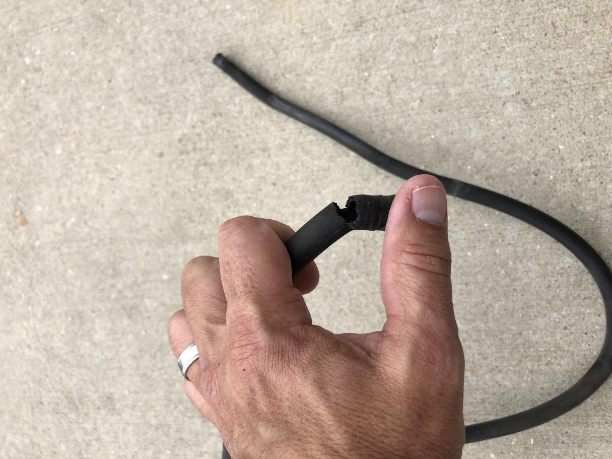

I then went to the MAF sensor and throttle body, and decided to clean both of those just to rule them out. While doing that, I notice a hole on the underside of the vacuum line that goes to the air intake. "Ahh, here's the problem!" I thought, and replaced the vacuum line.

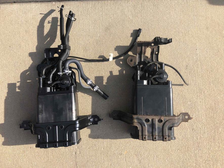

After some light troubleshooting, I decided to replace the entire canister. Based on the age of the truck, I decided to go with the aftermarket Dorman one, rather than the Toyota part. Photos of the old and new canisters are attached. The nice part is that the new canister included all new hoses and a new VSV, so hopefully I never have to touch that thing again for the life of the truck.

That Dorman unit looks dang near identical! Usually Dorman has some slight cosmetic differences from the OEM part. The OEM can be had for about 280 bucks, where this one shows up around 180 on Amazon and other online vendors. I would be interested to see who actually supplies this part for Dorman, and they don't make anything themselves.
I am curious how long it holds up. Hopefully, for 20 plus years. :)
My 2001 original looked extremely nasty. I opted to pull a used one out of California. So I hope you found an alternative aftermarket part as another option.
