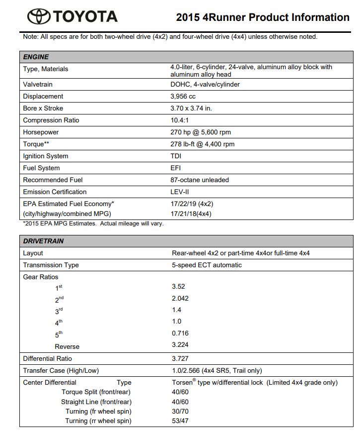

Found this for 2015, so I'd assume all 5th gen, but I can't determine if the Torsen is for the limited only. It would seem so.
