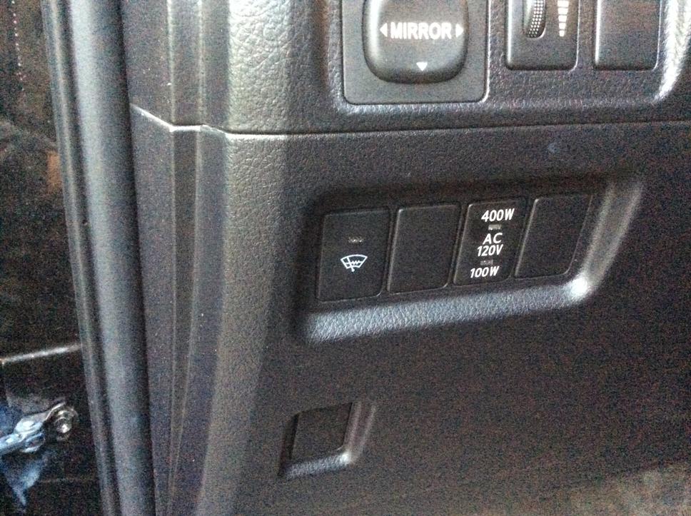

It must have switched over to a dedicated switch somewhere along the way. Here's what mine looks like, driver side left knee
On ours the Rear Defrost heats the Side Mirrors as well. The Windshield Wiper De-icer switch is dedicated only to that function.
Ding ding. This is correct according to the 2011 I am sitting in right now as well.
