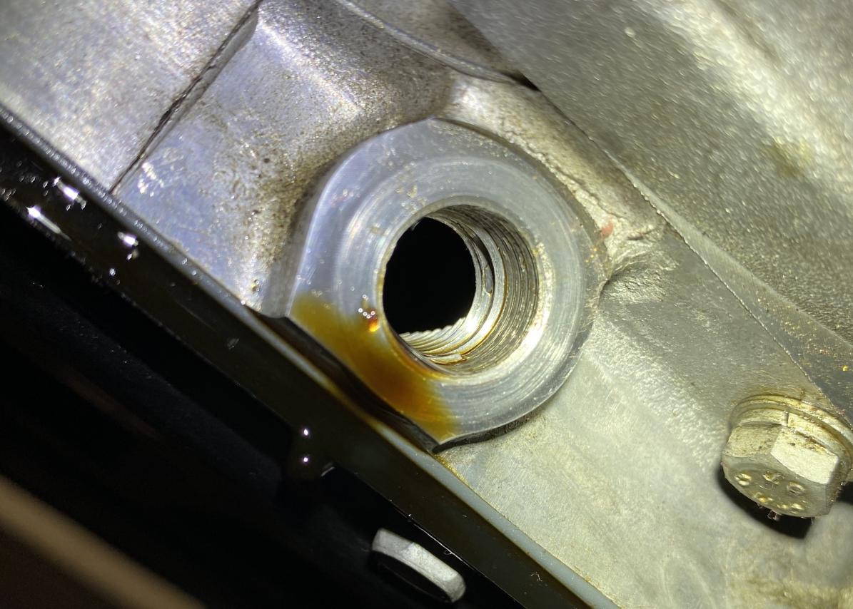

Wow what a nightmare for the OP. Completely unnecessary and avoidable if the dealer had done the right job but they are notorious for screwing oil changes up. This confirms why the dealer will never see my Runner unless it's for a warranty issue or recall.
Yea, i couldnt make up this story if i tried. Spent most of my morning today power washing my driveway in 40F degree weather. Jesus... baking soda & dish liquid... over and over a few times....i swear, i better not have a fresh oil stain tomorrow morning or else i will flip out. :doh:
** If you noticed it says (6) qt of Mobil1 on the service ticket above.
*** Now look at what it says above on this service ticket.. (6) qt of 0w20 BULK OIL-W and 1 qt of Mobil1. What are they using 0w20 BULK OIL-W for? Makes me think they drained all my Mobil1 Oil, added their shitty synthetic blend, and added 1 quart of Mobil1? I'm Confused :confused:
Oil on the top, Tranny fluid on the bottom...courtesy of Sansone Toyota.

On a positive note we’re lucky our oil pans aren’t made out of aluminum, stripped threads when a torque wrench was nowhere to be found.
No kidding. Sheesh!
You know, I've never used a torque wrench for an oil change but yet I've never stripped a drain plug. I swear, some of these techs must use nothing but a pneumatic impact wrench for anything.
So... Pull the plates?
Yep, they removed the skid plates. And you're not going to believe this, I see a small oil stain on my driveway again, under the TRD Skid plate. I'm so angry right now.
Hoping it is old oil that was laying in the TRD skid plate from them not tightening the oil filter housing.
Crawled under the runner, i saw some oil on the bottom of the TRD Skidplate and you can see a fresh leak on my driveway. Wiped it off. Looked inside the skidplate, and looked at the oil filter housing. Seemed dry. Will keep my eye on it.
If not, I'm going to bring it to a friend who is a mechanic and finally get it fixed right. Should of went to him in the first place.
Back to my original point. If you're concerned with them jacking up the skid plate bolts... Pull them yourself. Need to come down to clean the oil off them anyway.
