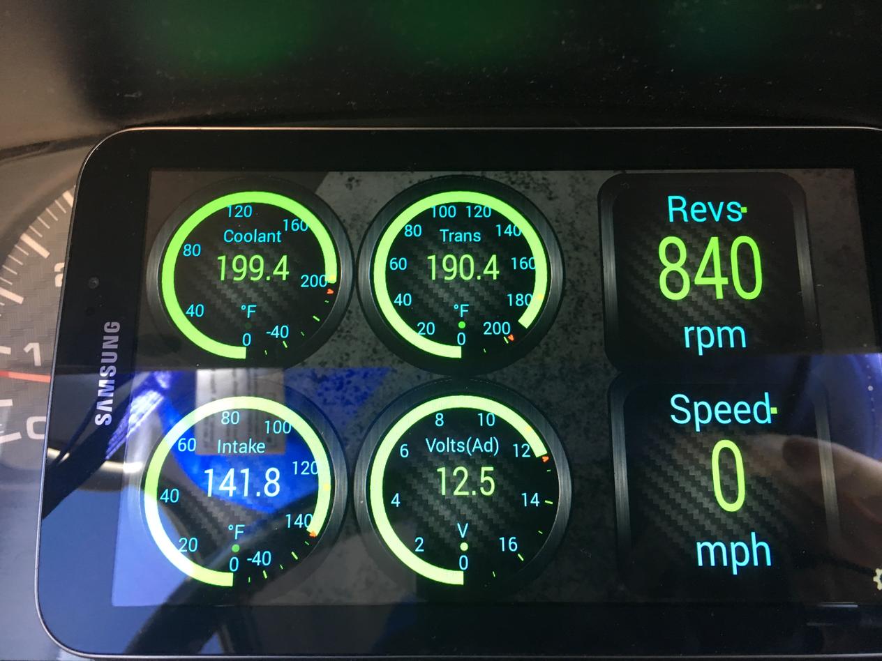

Do these temps seem normal?

Drove around town for about 30 minutes in 99 degree heat. Stop and go traffic.

Your truck is 'fine' with all those numbers. Improvements can be made with engine temp, trans temp and battery voltage - but none will stop you from driving the truck 10's of thousands of miles!
Voltage is as reported by the ECU, which means that's the voltage it senses is running the injectors and coils (used for adjusting injector opening times, etc.).
Low voltage is not caused by the battery. Might be weak ground/power wiring or a bad/weak alternator. It isn't fatal unless you don't see >13.0V in normal driving (engine above 1k rpm, say).
-Charlie
Charlie is correct. I should have clarified to check your battery connections first.
First crank of the day what is the voltage then?
