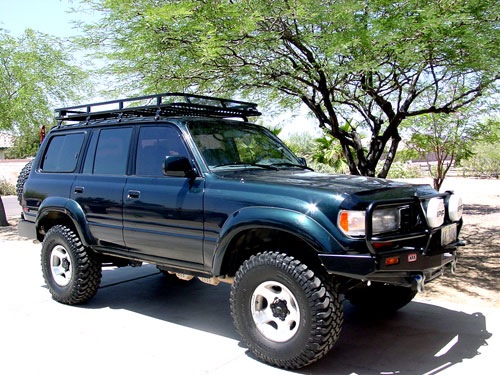

Does anyone know who's cruiser this is or what tires, brand and dimensions these tires are?

I love how these tires look on this cruiser! Everything is in proper proportion.

Those bfg's aren't made anymore with that tread pattern. The closest thing you'll find are procomp mt's. Also those are more than likely 315s on that landcruiser.
that is either a 305 70 16 or a 315 70 16 BFG KM1 but the issue is that tire is no longer made... BFG makes the KM2, but its a totally different looking tire. the only tires to my knowledge that look similar is the nitto trail grappler, maxxis bighorn, and some other off name tires. if you want a slightly larger tire to give you that look you will want a 265 75 16, or you could probably swing a 285 70 16, i ran a 285 tire at stock height for the longest time before i had my lift.
Yep, old school BFG Muds. Those are 16" wheels, so I'm gonna guess they're either 285's or 315's. Hard to tell by the angle.
YUP i was goin to say the nittos as well

Obviously the cruiser FJ80 wheels. 16x8
285 75 16 goodyear duratracs
coilovers in front (set to approx. 23" center of wheel hub to bottom of fender)
land cruiser springs in the rear. can't remember my color codes... but I think they're the 7.5 or 8 wraps.
enjoy

The cruiser looks like it is on 35s.... 315 75 16
