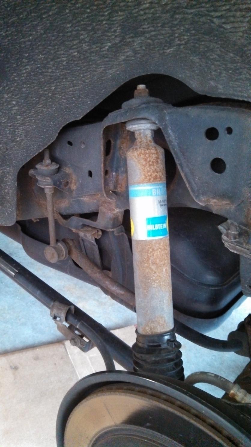

The Bilstein 5100s apparently corrode pretty easily (see someone elses pic here: https://www.toyota-4runner.org/atta...00-after-6-months-img_20130710_193333_725-jpg
so I sprayed them with a few coats of clear before installing
