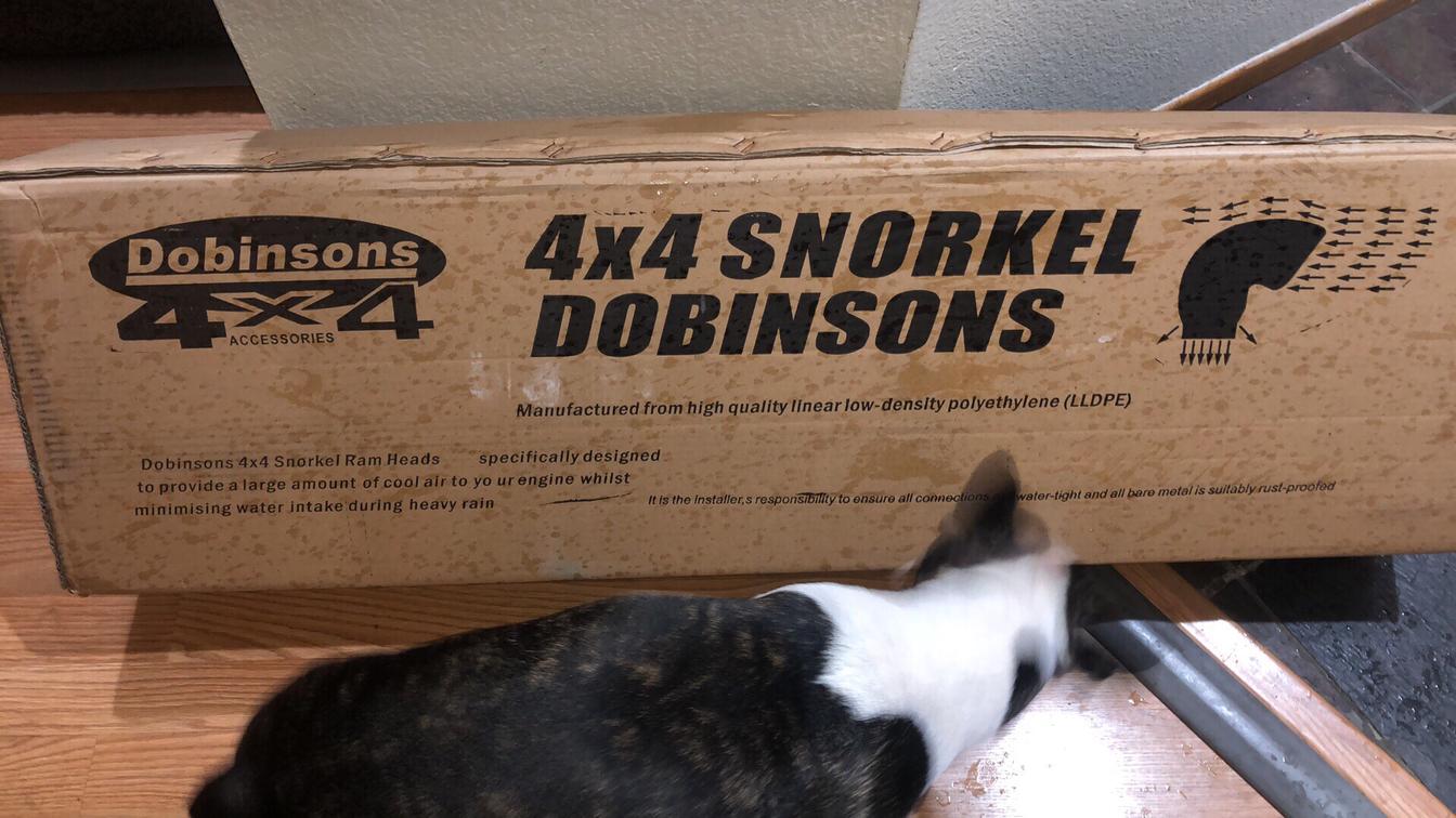

I got mine, met the Fedex guy outside, box wasn't all messed up. Haven't opened it yet. Going to be a second on installing.
