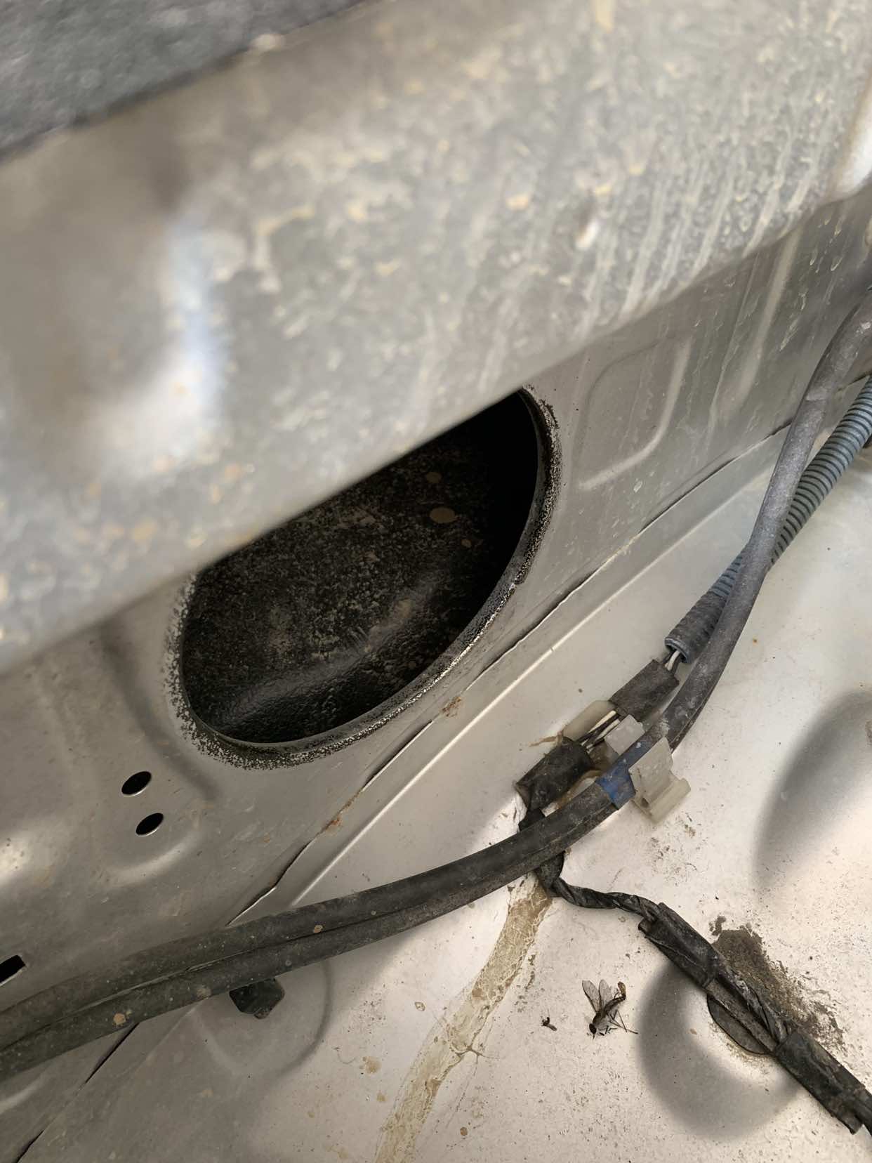

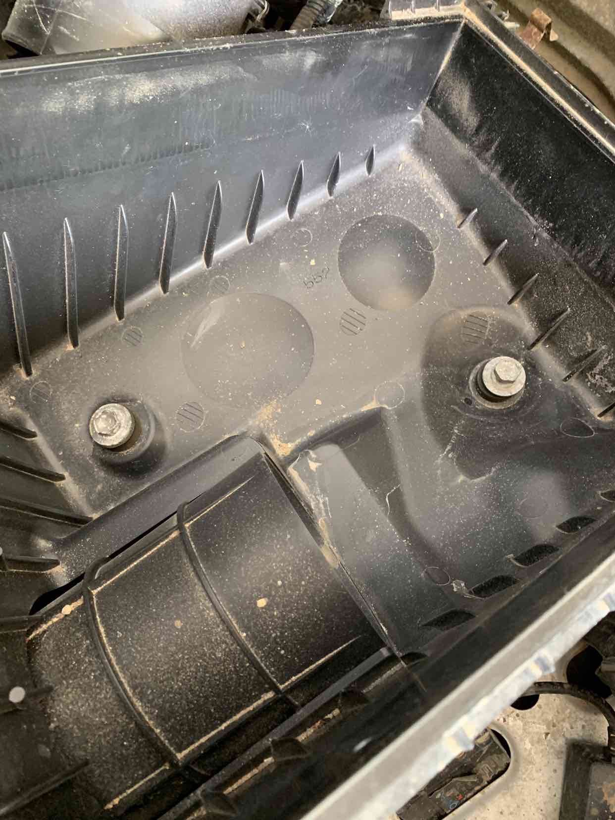

If you’re questioning the need for a snorkel, I’d confidently recommend one if you actually off road. I don’t go in super deep water or mud by any measure (I’m alone a bit too when I’m out so I’m not going to get myself into bad situations) and I had evidence of water and a lot of dirt in my airbox. So this mod was a no brainer.
Sorry for the long wall of words but it will hopefully help those considering this.
Lots of dirt and water in my wheel well and airbox
