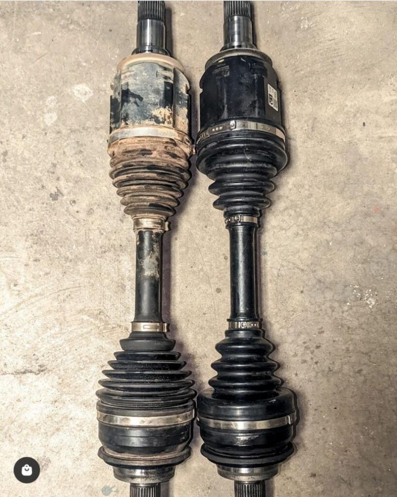

A customer shared this great shot of the stock CV boots on the left and then the Dobinsons high clearance silicone boots installed on the right. You can see that the CV can take more angle without the boot rubbing against itself, which is generally the cause of wear over time. Also, since they're silicone, they can flex and take a bit more of a beating without tearing as easily as the stock rubber boots. Something to consider the next time you feel like changing out the CV boots.
Dobinsons High Clearance Outer CV Stretch Boot Kit | Tacoma 4Runner FJ Cruiser GX470 GX460
Dobinsons High Clearance Inner CV Stretch Boot Kit | Tacoma 4Runner FJ Cruiser GX470 GX460

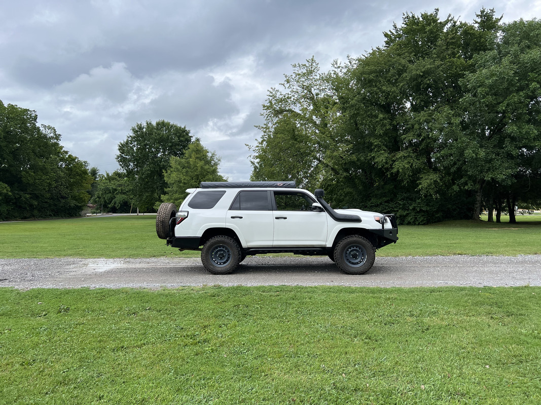

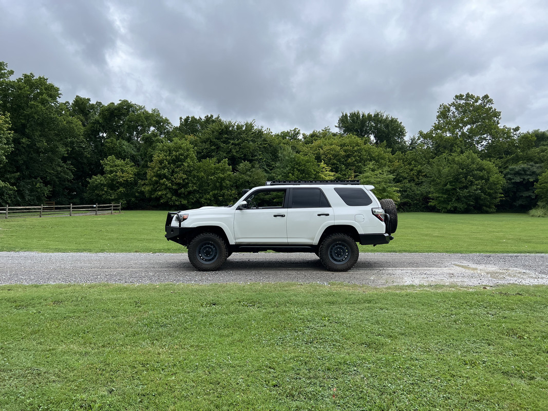

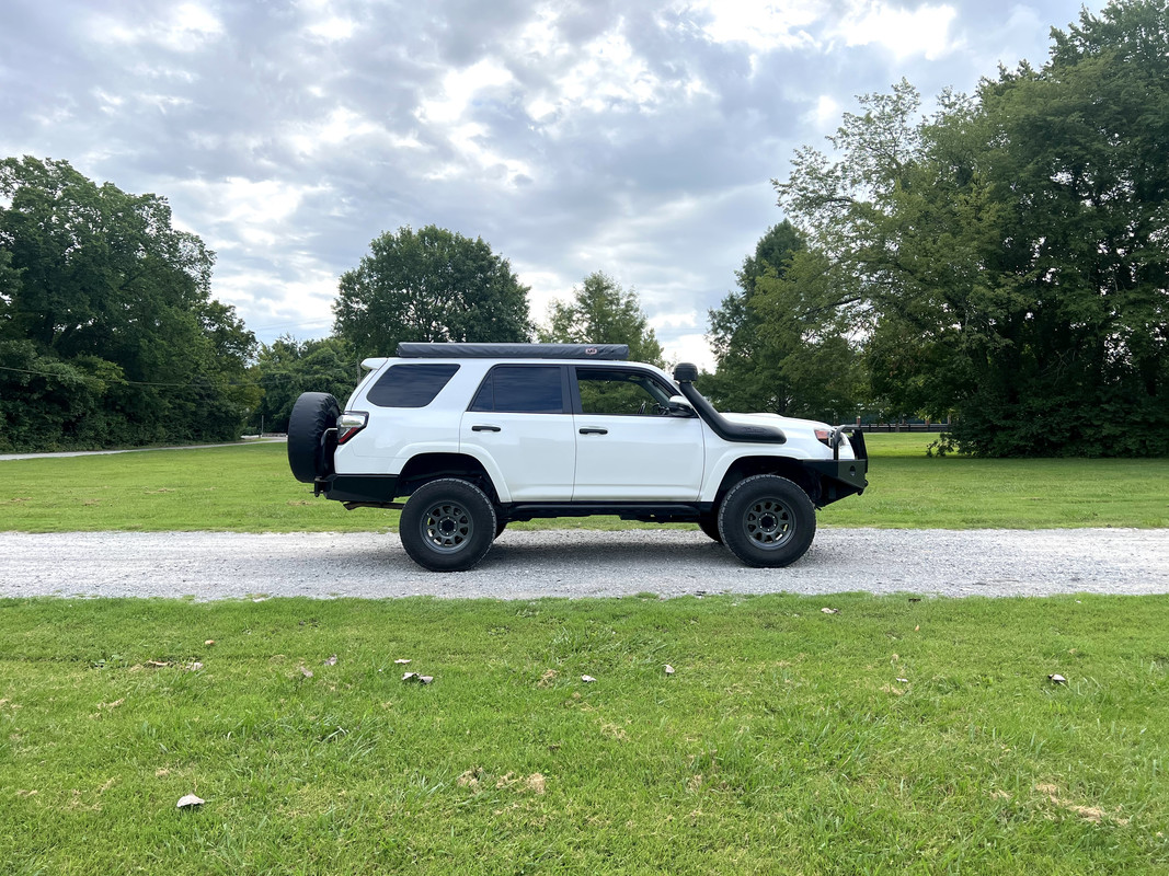

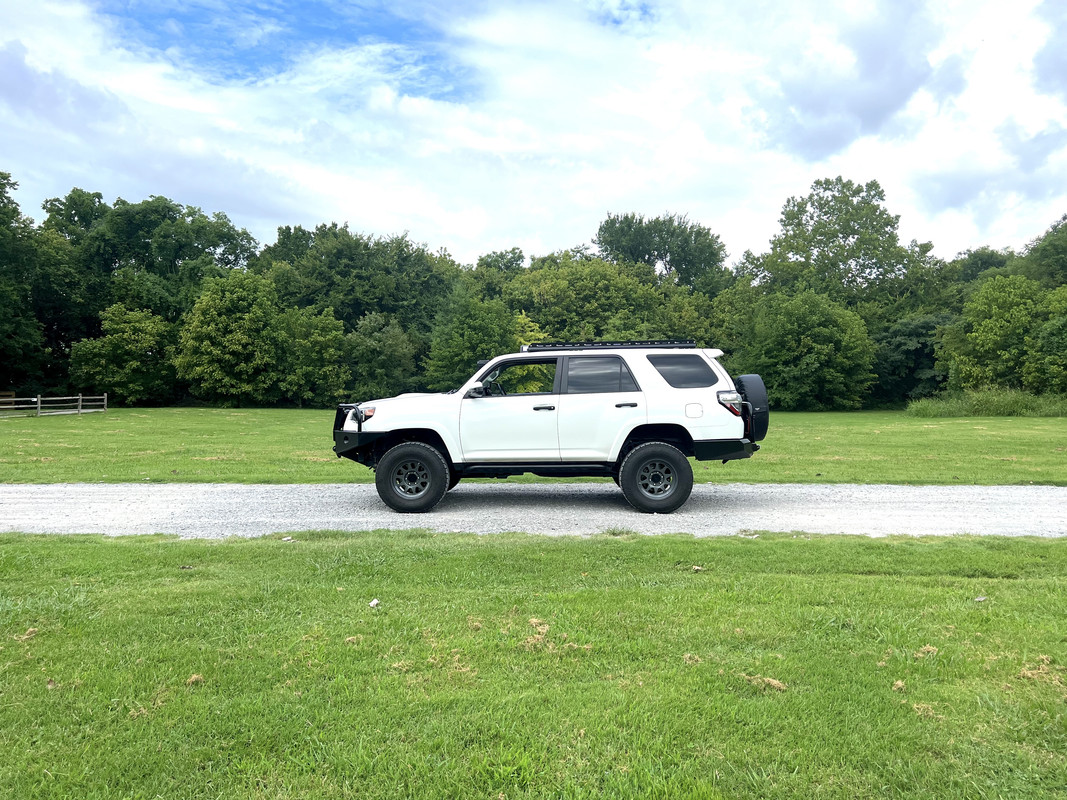

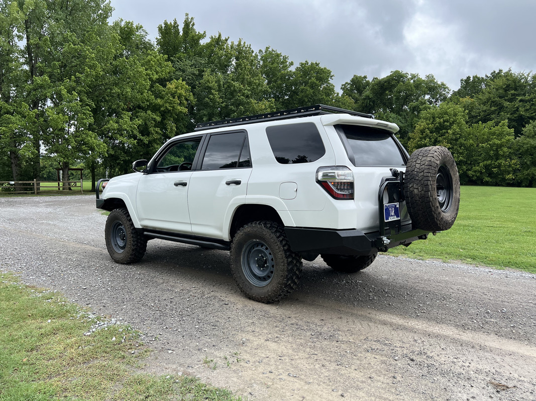

Pic time:
Dobinsons C59-327 coils with all the static weight:
Dobinsons C59-701v coils with all the static weight:
Perfect rake!

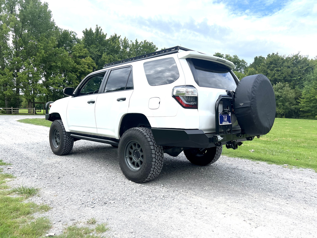

So after two years of suspension, bumpers, racks, tires, wheels, etc... I'm done!
Pic time:
Perfect rake!
I'm thinking of doing the same switch from 327 to 701v. How's the ride with the 701v? I like the lift and extra articulation they give, but was concerned they would feel too mushy and bouncy given the softer spring rate vs the 327.
They are firmer than the 327's IMO.
Mike (if i recall what he said) told me that the 701's are the firmer option of the long travel over the 677 offering. I could have got that wrong, but they are firm.
With the weight I have on there it rides +/- the same as it did before I had the bumper on and just my drawers. 701's handle the weight wonderfully.
